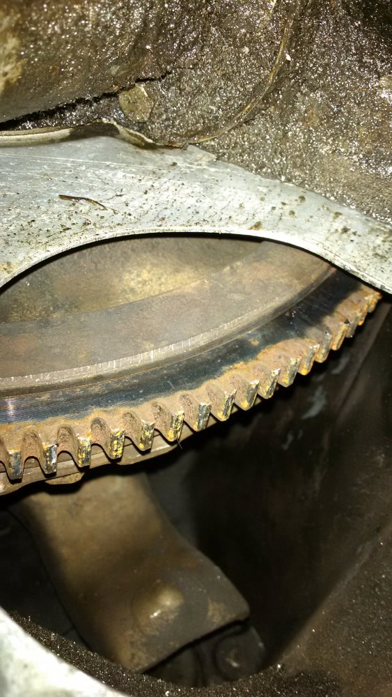

For the starter. The mounting plate (If you get under your truck or SUV since if you've got a bronco. Youll see a metal plate that the starter is pushed up against. Which acts as a ground and the mating surface for holding the starter in the right place.
Mine is worn out. As if the places for the ears is really pushed in from years of year and tear from the starter and probably over its years of having the starter removed and replaced. So, since the mating surface metal is worn down. The torque from the starter moves the starter away from the flywheel ring gear. Heres a thread on a 2.9 that's going on with my 2.8 https://www.therangerstation.com/forums/index.php?threads/starter-engagement-issues.164501/

The separator plate actually does position the starter, but Max is dealing with a worn plate and stripped starter bolts.

whenever the threads were good. I still had to push the starter. The play is within the separator plate. the hold is bigger and worn down from over the years. Ill see if Ive got a photo of it.
Older photo but a photo none the less.
You can see how the plate is worn.
Whenever I take the starter off. Ill take a better photo of where the ears are seated. Youll be able to see they are a bit pushed in more than they should be. Thats why I (In a other post) I thought of using the thinnest shims I have to try and take up some of the play.
