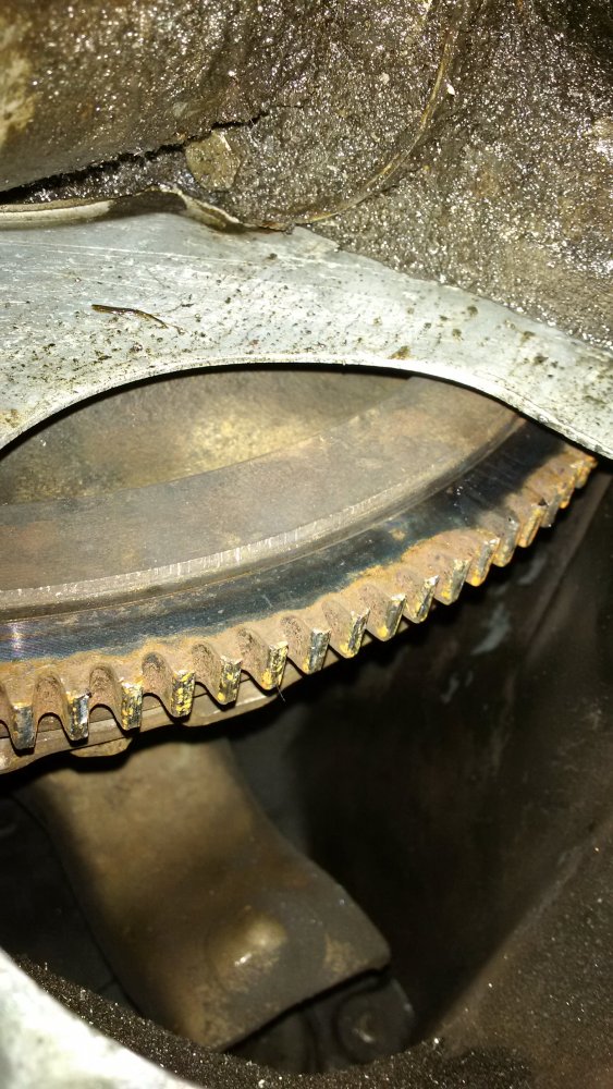

Older photo but a photo none the less.
You can see how the plate is worn.
Whenever I take the starter off. Ill take a better photo of where the ears are seated. Youll be able to see they are a bit pushed in more than they should be. Thats why I (In a other post) I thought of using the thinnest shims I have to try and take up some of the play.
I get it now, the large hole locates the starter. I wonder if all the starters for the colognes are the same diameter? If they are, I wonder if you could get another plate from some other cologne engine, saw the new plate off around the hole, and then use a bunch of pop rivets or something to mount the new cut off piece in the right position to repair the hole. They do make countersunk pop rivets. Basically you can drill your hole, then take a very large drill bit and drill into it a little bit and that gives a place for the pop rivet to sit.

The starter keeps getting stuck in the flywheel teeth. Is that starter or flywheel related? Because it happened twice. I'm fixing to just buy a new starter from rockauto if its the starter. It happened 2 times in a row. The Bendix keeps getting jammed inside itself. Like when I remove the bronze/copper cap it's stiff and takes a few smacks with my rubber mallet to get it to go back in. Then it's smooth as butter. Then I put it back on the truck and try and start it. Its a horrible grind and nothing. Doesn't wanna move.

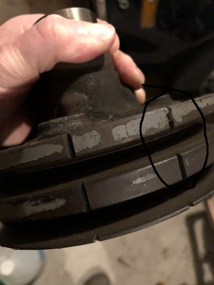

UPDATE: New starter fixed it. I got her running on the right firing order and she runs nice and smooth. The timing marks are readable when I shoot the timing light on it. The pointer is outside the second notch on the timing wheel. Don't know if that means I'm too far advanced or retarded. I circled the notch I'm talking about.

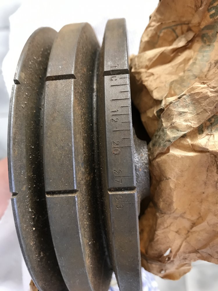

Credit for the photo goes to @AndyB.
So my main issue right now is setting the timing. I have it at a decent timing and my intake vacuum is around 25 inches which seems high but I could be wrong. This motor has always sat around the 19-21 mark so a nice steady 24-26 seems a bit high. I've got it off chock btw and the mixture screws are set for a nice clean idle. The idle screw is basically backed out all of the ways. Im just wondering where I need to set the timing for her to be happy and not worry about spark knock and the vacuum advanced to not cause issues. I haven't gotten to drive her yet sadly. I REALLY WANT TO but want to get the timing in a safe spot to not cause damage or issues. I also need to fix my drivers side valve cover as to I think it might be leaking somehow onto the manifold.
Here’s a better picture of the timing marks. Most of these engines are set at idle around 10° BTDC. I think you still need to set up the vacuum advance.

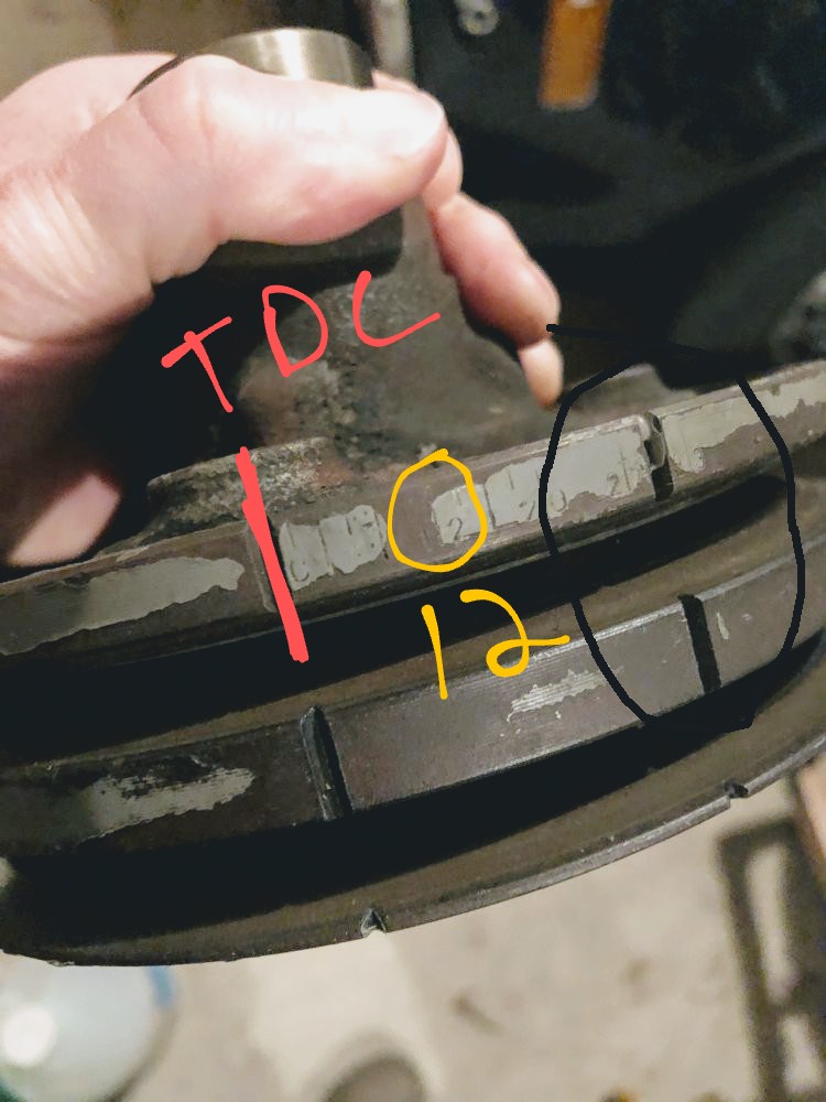

Yeah, not to be a bother or seem dumb. Could you point out where 10° BTDC is on the wheel? Since the larger numbers confuse me.
Ill try and shoot a video of what I see tomorrow. Its getting dark out right now. I did get the right line for my vacuum advanced. Its all hooked up.

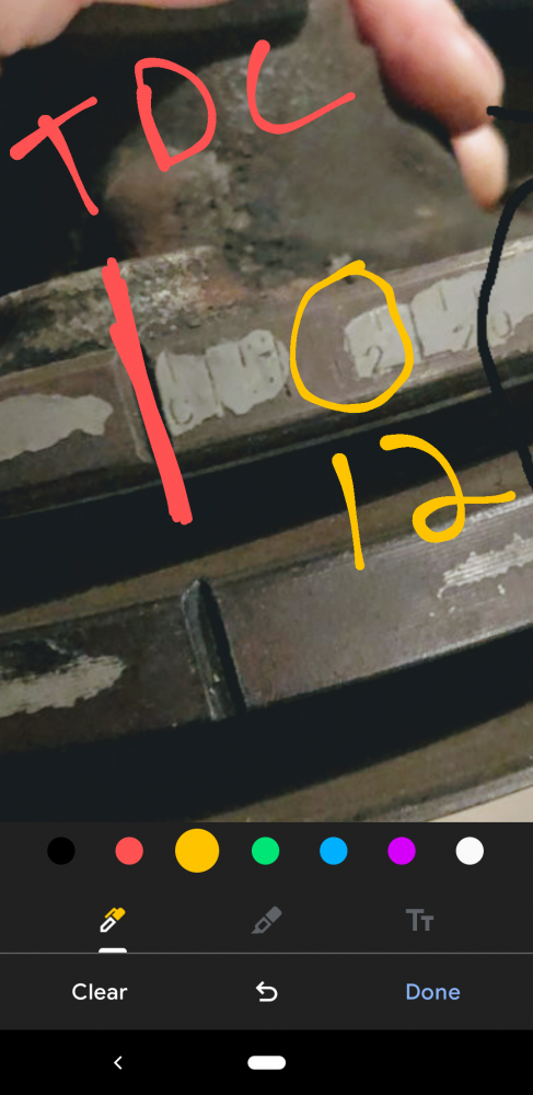

Maybe this will help. You can read 12 DBTDC on the pulley.

The circled hash Mark is 10°. TDC is zero, and each line from that is 2°
