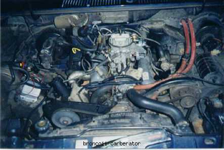

Ok, lets put a 2.8 engine bay next to that of say, a 2010 Escape and see how they stack up for "electrical crap".

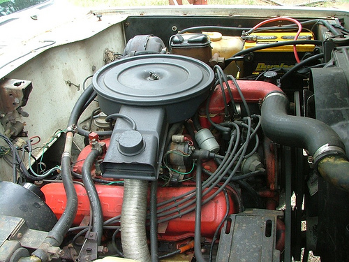

Compared to a '73 Int'l and a '74 Chevy its quite a bit more. The only engines I have experience with are 70s V8's which were simple as dirt and you can climb inside the engine compartment to work on em. This is new to me.
'73 International
The Escape at least has a more logical setup. More complicated technecally but that 2.8 setup is full of all sorts of stupid.
'73 International
