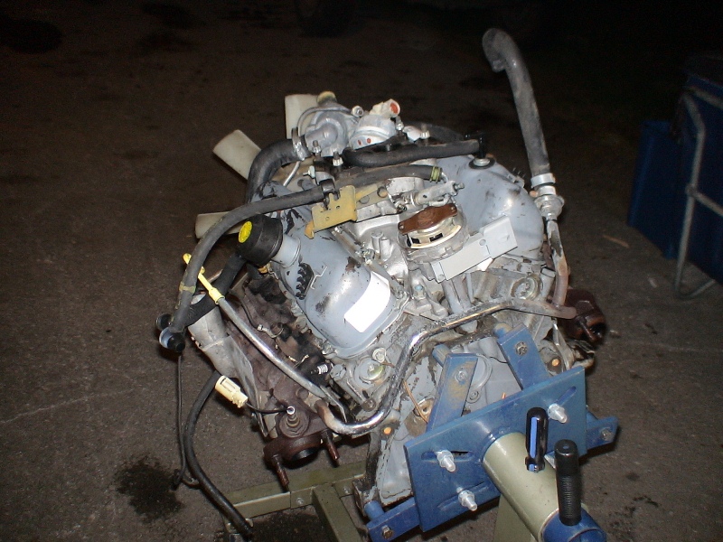

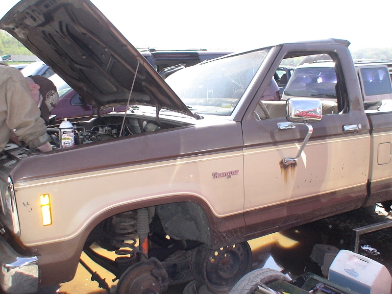

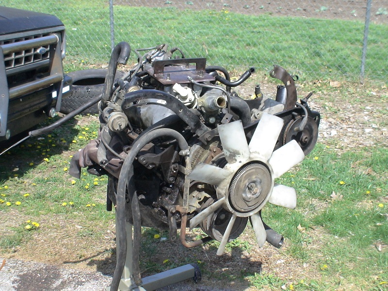

So here is the motor we got at PicknPull. Came out of an 85 Ranger with 71k that rolled.
Dirty and gross
Nice and clean! Oven Cleaner works magic!
Our Resident Mechanic

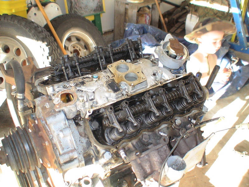

Almost done taking it apart, just got to break the dang exhaust manifold bolts loose.

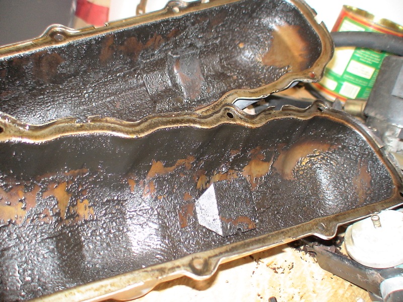

Gunk inside Valve Covers.

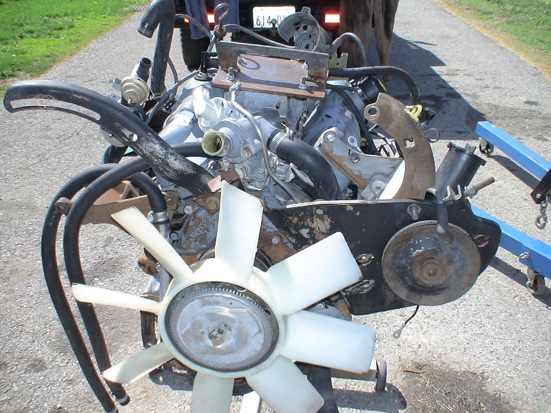

Tonight we will get it down to the block, finish cleanin it up, and hopefully get it over to the shop within the next few days.:icon_thumby:
Maybe 171 grand looking at the valve covers and rockers. It should still be a good core. Be sure and pull the bushing/tubes that line up the timing cover and the water pump they are hard to find. Parts have a way of disappearing at the rebuild shop strip it down good.
I just noticed the upper thermostat housing that is also like gold be sure and use that manifold and thermostat housing when you install it. If your truck has the same setup I am sure someone here can use the extra one.
Sorry I meant the bushings that line up the timing cover and the block for the water pump.

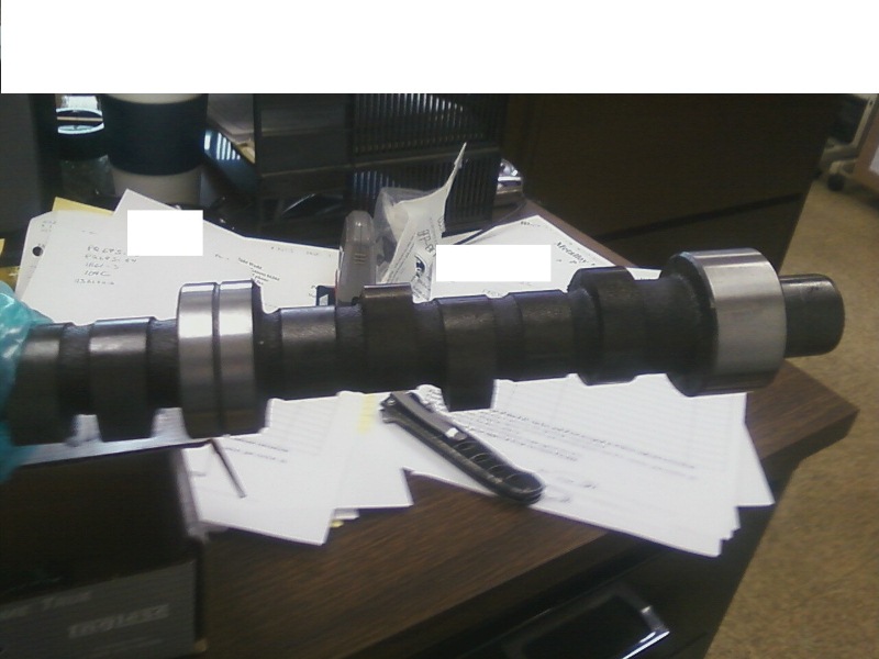

Ok finally got the motor to the shop so from here it should be a few weeks til we can get it back in. Just got my Cam for CompCams the "moderate performance" one. cam.jpg

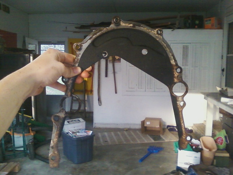

Trying to put the 2.8 back together and ran into a small hiccup. We broke something and dont know what its called to find a replacement.
Timing cover plate gasket???
Has gaskets on both sides and slides in between the timing gears and the block.
As good of a name as any...
Probably something you are going to have get from a JY if your old engine doesn't have one, it is hardly a common wear item for a parts store to stock.
