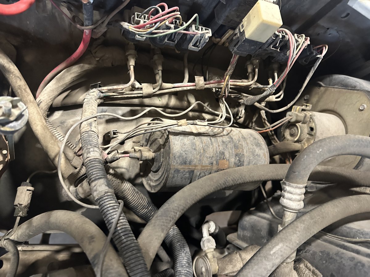

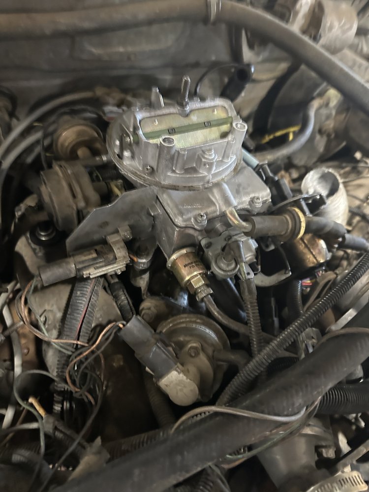

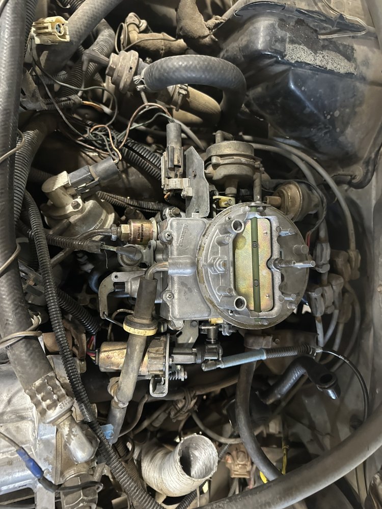

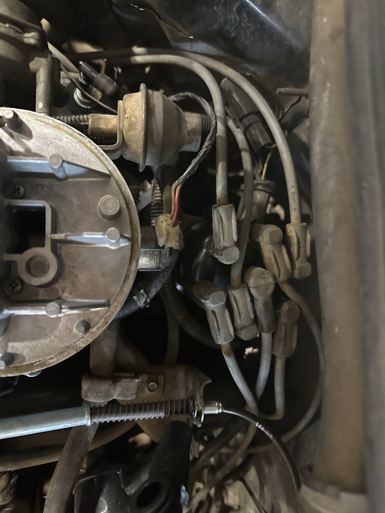

It’s all there I believe, a little evidence of someone possibly in the wire harness before mostly just a little dusty from sitting in the Arizona desert in a carport for 20 years.
