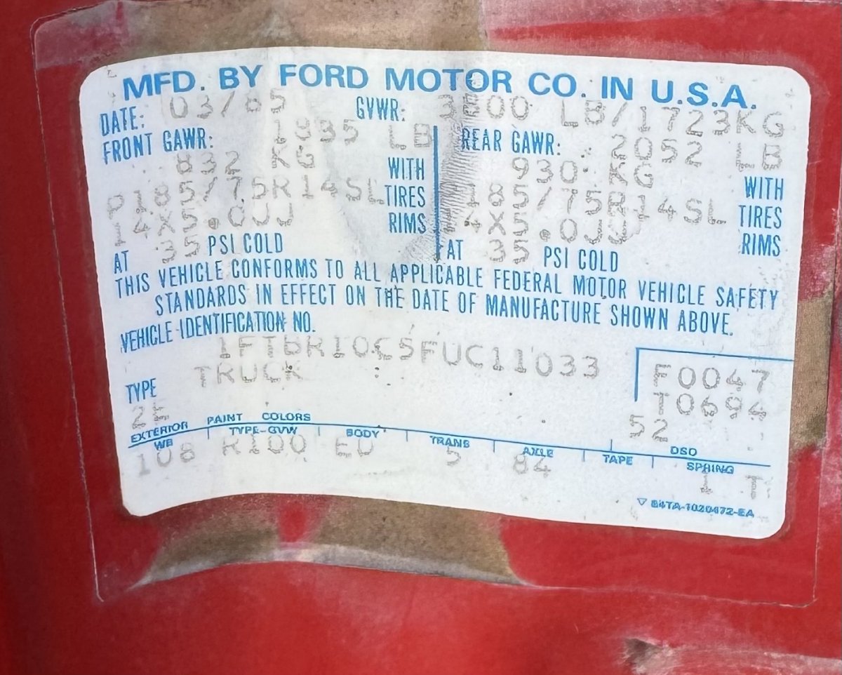

I went to go look and I don’t see a ratio. Am I missing something? IMG_2229.jpeg
Kinda, if you go HERE in the tech library it gives you a list of the axle codes from that sticker, you have code 84 which means 7.5" axle with 3.45 gears...
Apparently the transmission code 5 means a Toyo Koygo 5 speed so at least you have overdrive...
