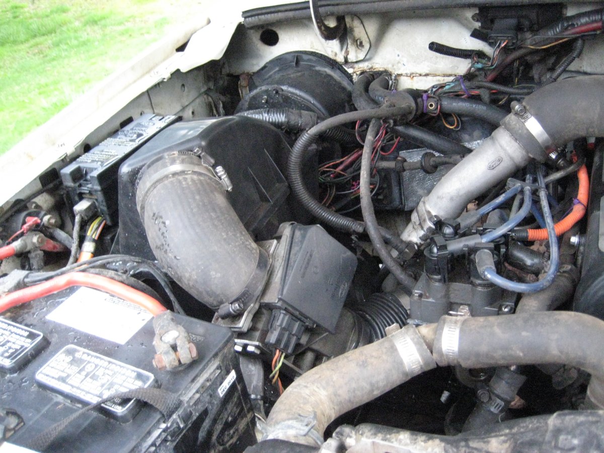

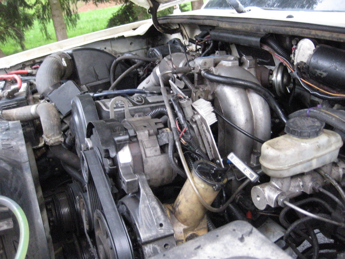

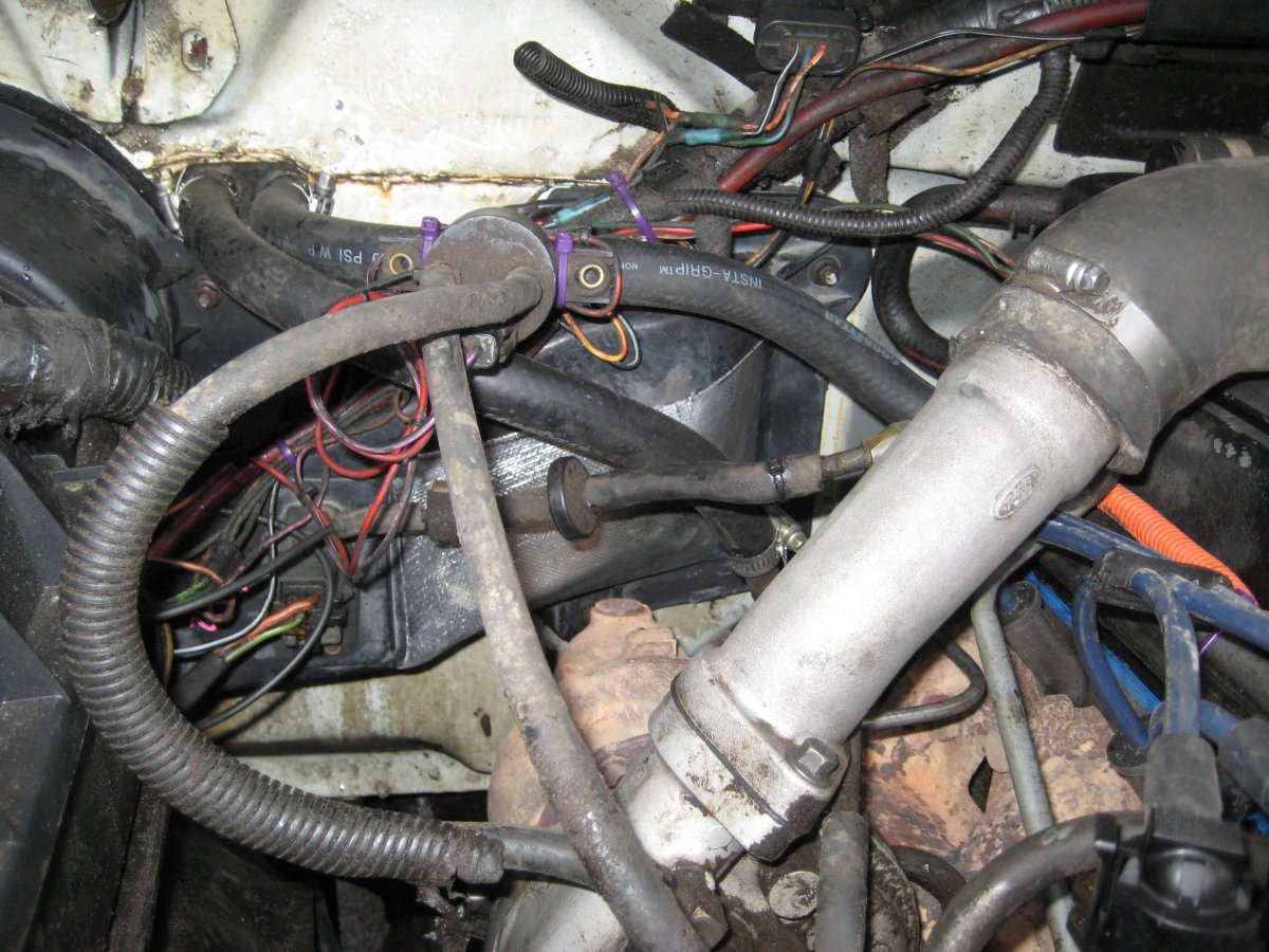

Here's some random out of date but pretty close to current pics, they're over 10 years old but the only difference is it's a different bottom end since then and a different turbo and likely a bit of cleanup like taking out the boost control solenoid that I wasn't even using right... I say that because it was making 16psi before I ported the head... I really need an intercooler, it's on the list...
