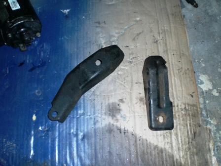

Just finished bolting the engine and tranny up. and am wondering how important, or not getting these brackets back on is. They bolt from the side of the engine block to the bell housing and seem to have no other function other than perhaps further reinforcing the block to transmission connection and being a real pain in the but to take out and put back in. These were on the Ranger block. A TC does not have them. Any thoughts?

I left mine off, if they were that important I would have had issues by now :), they make those two outer bolts near impossible to get in and out if I remember right.

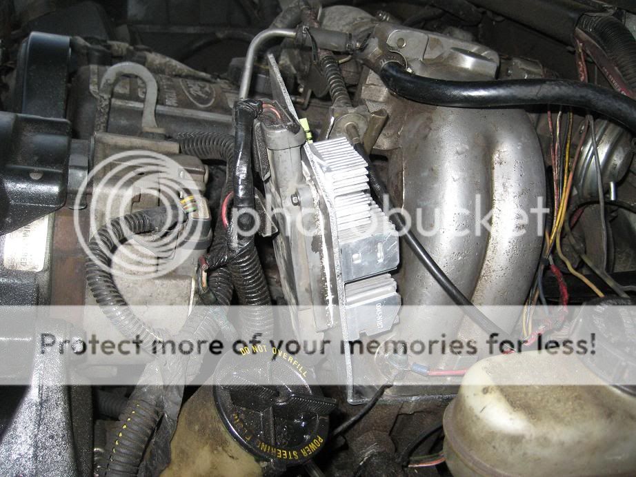

Yes. bolt access with them was horrible, and I was very pleased with the sound they made when they hit my scrap metal pile.:) I'm working on the intake & EEC today. I hit a wall on a few things so, I have a few questions: 1. Should I even bother with the knock sensor? 2. My truck does not have a MAP sensor. I bought a new 1 bar MAP sensor, (3 wires)and assume I must run a wire to the EEC where the BAP pin goes as well as the other 2 wires wherever they go. Which ones go where? I'm clueless. All I know is one is 5v, one is 12v power, and the last I assume is ground? 3. I recall you mentioning the need to heat sink the dis. How did you approach that? I was considering cutting off the hunk of aluminum it was mounted to on the Ranger intake and maybe grinding some cooling fins into it. Thanks for all of the help Scott. I'll have to look you up when I get out to Oregon this fall, to show you the truck and take you out for dinner and a few beers or something.
That's what I did for the DIS module, at least 1 if not 2 of those heat sinks is now gone the way of the dodo... it works fine but it is absolutely necessary to ground that plate, just run a short jumper wire from the plate to that stud on one of the bolts, works fine.

Oh, on the DIS plate I made, ONLY USE THE STOCK 3 BOLT LOCATIONS, I just used a 1/8" aluminum plate I found in my stash, bent it in my vise and traced out an intake gasket and cut it out... I think the module on mine is mounted upside down but it's just how it worked, I mounted it up instead of down because it got in more airflow there. Just having the plate is probably enough without adding heat sinks
Thanks again Scott. I really like your heat sink. I'm a firm believer in overkill and that sucker looks like it would cool down a nuclear reactor core! LOL. I wound up hacking the original aluminum mount off the stock intake and mounting it similar to yours. Should be sufficient; plenty of mass and surface area for dissipating heat. Could you clarify how you grounded out the drivers side DIS coil pack? I gather from the picture that you snipped off the plug end, grounded the black & white wires together and just left the red wire and ground hang wild/disconnected. Is that right? Also, I am running the stock radiator and water pump mounted fan, so I shouldn't have to be concerned with running the wires for the electric TC fans; should I pull those pins? The place where I'll be living/working after August is just a little south down Redwood Hwy from Grant's Pass; closer to Salem than six hours I think. I've been wanting to see Salem. There were some affordable properties for sale out that way a couple years ago. I may re-locate permanently. It's very hard to make a living doing what I do in N.E. TN, and I'm tired of struggling. It's a really unusual economy here. There is no tourism, folks are mostly either very rich or poor, and they all have unusual spending habits. (practical & frugal)
You can actually see my ground for the drivers side coil pack in that picture, it's the blue butt connector above the "do" in "do not overfill" on the PS cap, and it's the black wire going to the stud on the intake manifold... spliced the two output wires (the outer ones in the connector) in one side of the butt connector, and grounded the other side.

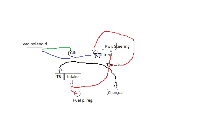

I swapped the throttle bodies on the intake, and am using the one from the Ranger. There are two major differences. 1. The idle control sensor's output plug faces toward the valve cover and don't fit, so I turned it 180 degrees. Is that ok? 2. The Ranger throttle body has two vacuum lines; one goes to the charcoal canister, and the other I assume to the vac tree; whereas, the TC throttle body has no vac lines. I hooked up the charcoal vac line, and was thinking about simply plugging the other one because the TC intake has a T'd vacuum line; one to the fuel pressure regulator and the other to the vac. tree. I want to split the line from the intake, and run one side to the power brake assist and the other to the tree. I'm attaching a diagram cause this is getting confusing. lol Just double checking; is this right?
