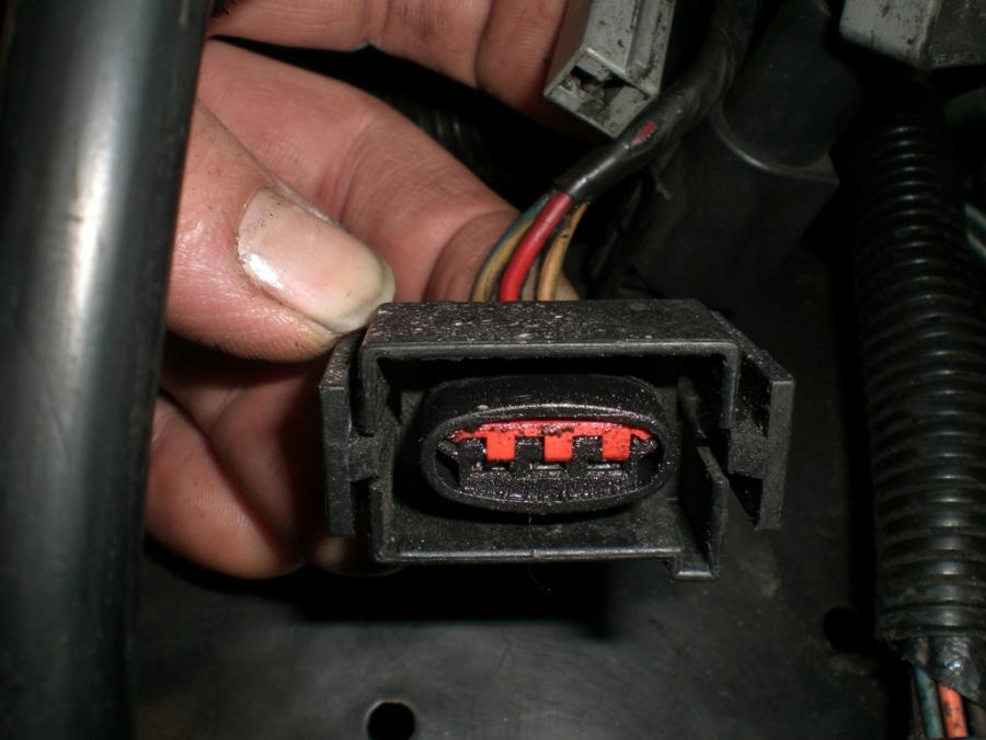

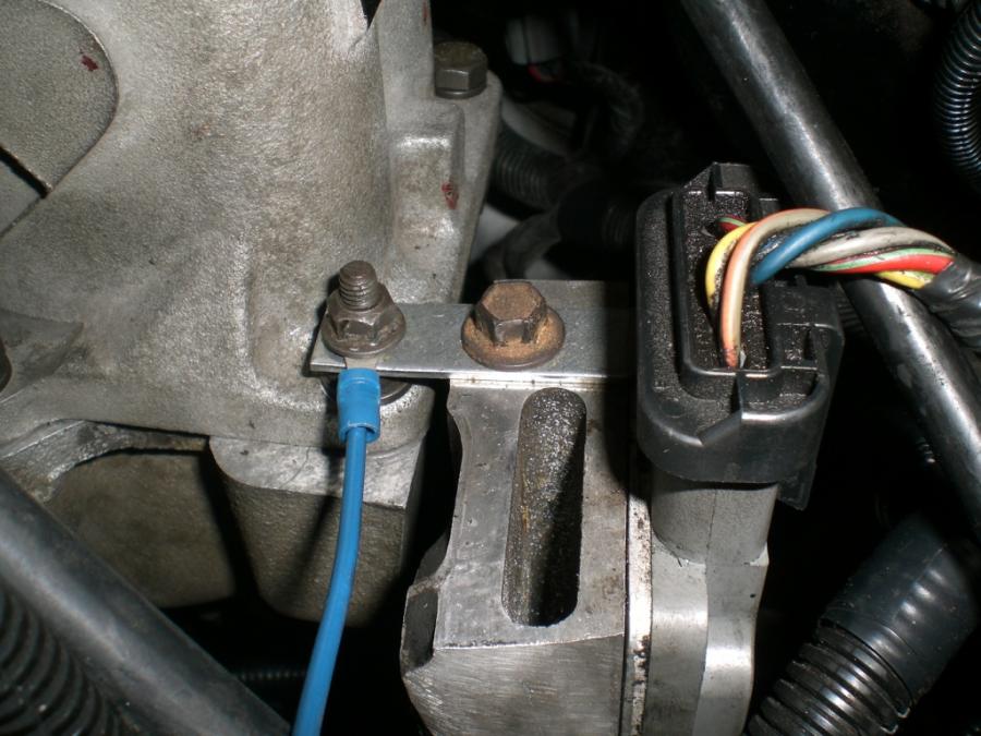

Scott, could you tell me how to ground the unused DIS coil pack again when you get a minute? I still can't quite figure out which wires have to be grounded. I'm posting a pic this time; I don't think our wires are the same color. Also, posting a pic of my DIS mount. You said it has to be grounded, and I want to make sure what I've done is sufficient. The bracket is the only ground in my setup and the blue wire will be used to ground the DIS coil pack wires. I'm wondering if I can use the unused coil pack as a spare. Are the coil packs interchangeable that way?

Don't know how I missed your last post... yes, the coil packs are the same, so keep it as a spare.
