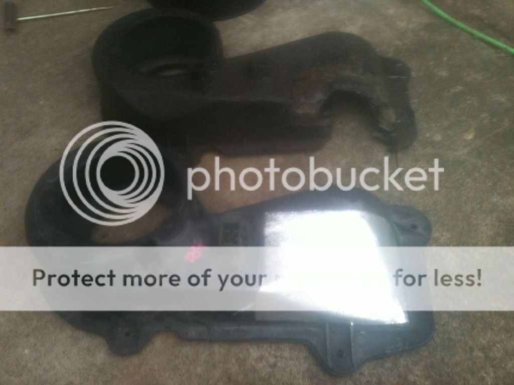

I did forget one thing though, relocate the oxygen sensor to the down pipe, O2 sensor bungs aren't that expensive and makes it easier than butchering the heater box more than you have to (you have to...). On the heater box go to Harbor Freight and get yourself one of those soldering iron type plastic welders ($15 or less and handy) and notch the bottom of the box like in the picture below, put some of the screen stuff on the patch and use a heat gun to get it to bend over better. As you can see I had to redo mine, that fiberglass stuff fell off of the first attempt and it got kinda melty...
