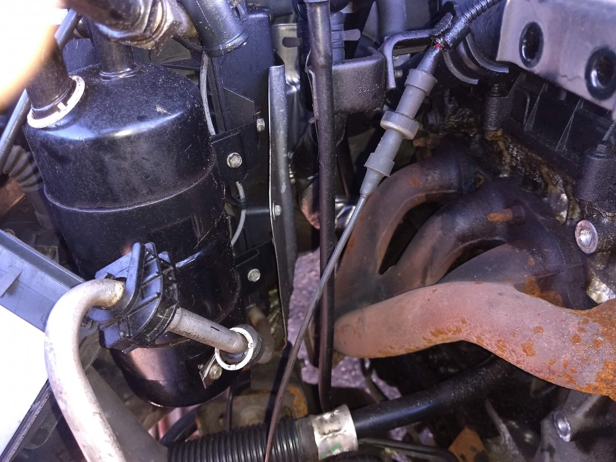

I have few good pics of the L I have handy at home....but this bay pick on the exhaust side will give you an idea.
The L block is essentially the same. 2.0 has a longer rod then the 2.3..... so dwell....rod ratio and valve and injection events are diverse in results. Closed deck vs open deck are variables...but lazy cam phazers will murder head gaskets and heads over 350 HP with either design..

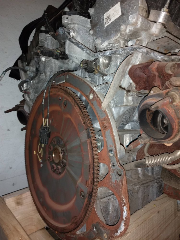

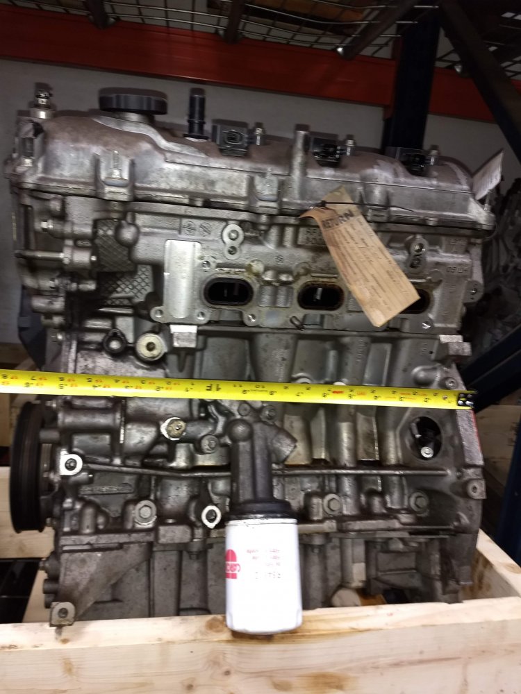

The v6 is a fat bastard. Block variation is high....but. The myth about the bolt patterns are not truly myths...just technically. I have fitted rwd to fwd transmissions...the doweling is different so the blocks being different is valid.
View attachment 41681View attachment 41681View attachment 41682
@PetroleumJunkie412 doesn't that look like a Chrysler LA block bolt pattern? Might be worth a measurement or 2 for a NV4500
Not an la. .but with the top mount starter reminds me of a 225.

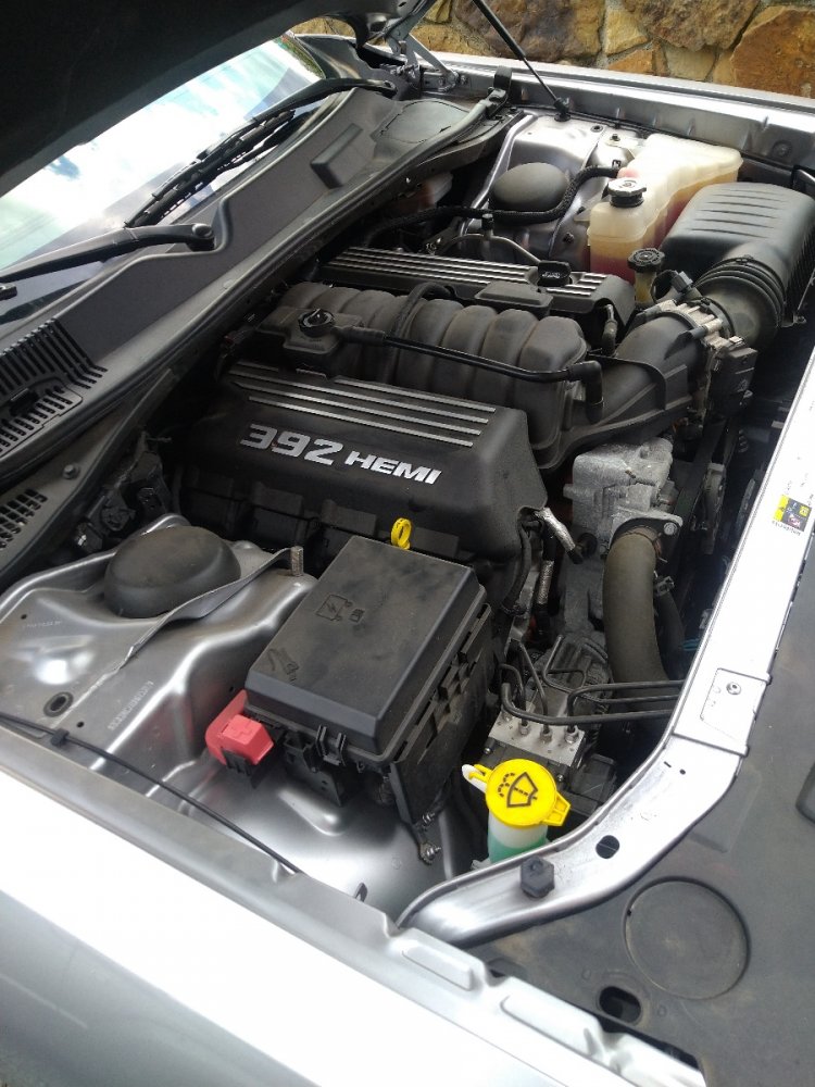

My 6.4 above. Agree.
Dual plug allows for incredible levels of tuning because you now have two different ****ing spark curves. Even without VVT, just having fuel and two levels of ignition control gives you the ability to tune to one exponent above ignition and fuel control.
If you know what you're doing with piston tops and intake runners, you can take an old design and blast it several decades into the future, even decades from now.
