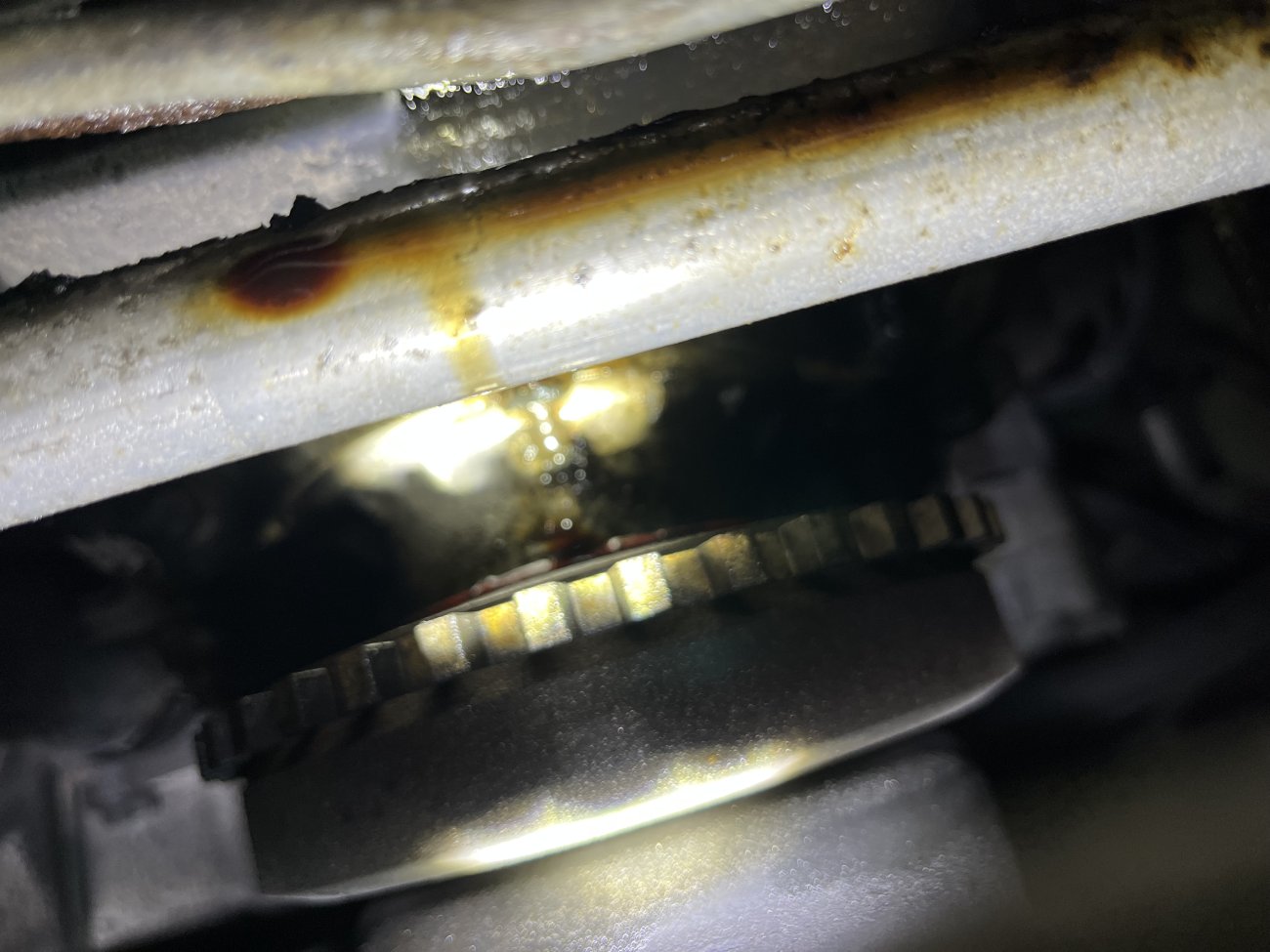

I was able to put the truck up on a lift today and was hoping for a valve cover gasket as the spot on my floor after it sat for a week was at the back of the motor. It is running from the front of the engine, down the oil pan and dripping at the back of the oil pan. I don't know much about these engines but I am assuming there is some type of seal at the crank shaft. From what I could see it is coming down the front of the engine right behind the harmonic balancer. I tried to take a pic but it was had to get my phone up in there. Is there anything else that would be leaking behind the balancer. Everything was dry above the oil pan gasket. Plus the leak seems to be getting worse. It was a 20 minute drive to my garage with the lift and before I could even get it off the ground there was a spot the size of a quarter or lager. Some once I got it home.

Definitely sounds like front main seal...
I will not tackle that myself. Curious what kind of job it is and how many hours of labor it should take a mechanic, assuming no major problems come up. And if there are any real issues that make it tricky or if it pretty straight forward…
should be an easy job, depends on how stuck the harmonic balancer is on the crankshaft.
northern Indiana has a good chance of being a problem, southern not so much.
the seal is easily accessible when the balancer is removed.
is the oil over filled? that area is splashed with oil so to high a level makes it worse.
is the PCV clogged? a pressurized crankcase can also cause more leaks.
before you commit to taking it to a mechanic watch a youtube video... it's a little buried so there is stuff to take out (radiator,shroud, fan), but the cost of the 1 new tool you probably don't have (harmonic balancer puller) versus the first 15 minutes of the mechanics time is about equal.
