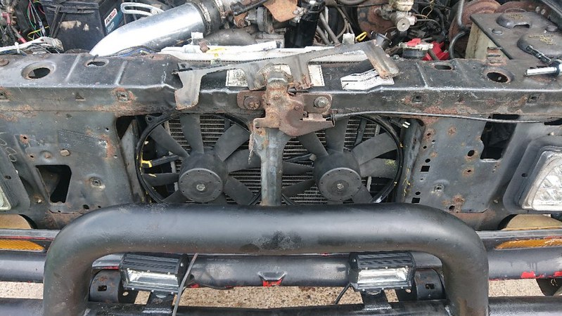

I've got the HD Explorer radiator, adding the C230 Mercedes condenser fans (with a low profile flex fan)... I am just going to try it and see how it goes.
(installed in @PetroleumJunkie412's truck)
