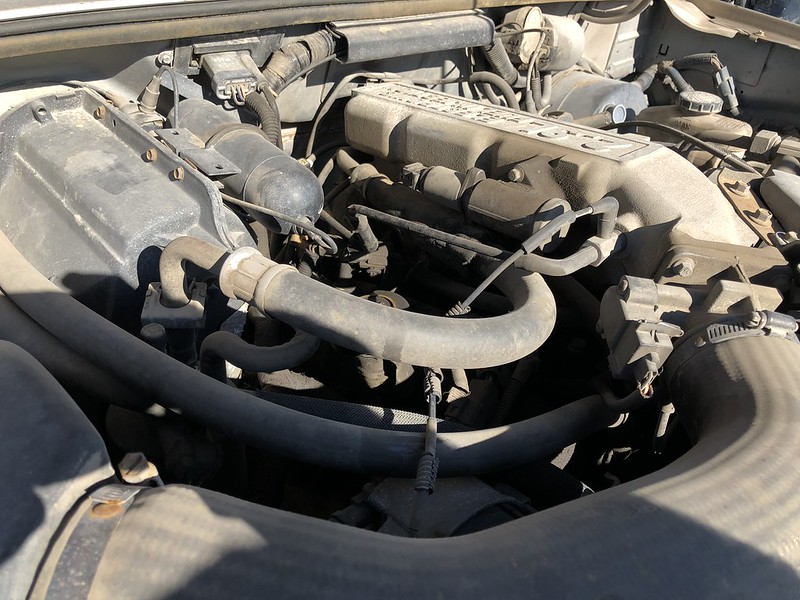

Yup, in big black housing to left of engine in pic:
That is factory A/C, dunno about dealer installed.
