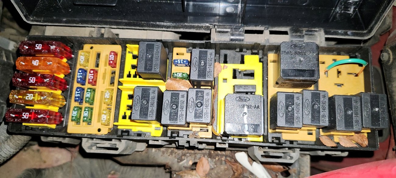

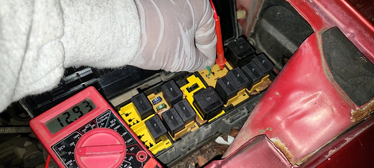

Here are the tests....
PCM relay has power @pin 87&30, probes pushed into those.
Fuel relay has no power with or without key turned to ON position
I jumped the fuel relay pins 87&30 and same behavior - cranked, turned over but never started.
By now battery is jumped to the idling F150 to make sure bat has enough juice.
I toggled inertia switch and pushed it down, result was still the same.
PCM RELAY TESTED

I don't have a diagram with PATS handy. This sounds like either PATS or bad fuel pump or mouse chewed the wirung to the fuel pump.
With the fuel pump relay jumpered the way you have it shown, measure voltage to ground at the inertia switch.

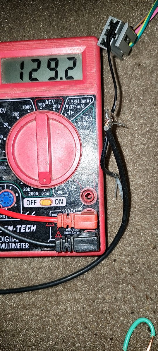

Next tested wire continuity from IS to FP.
Probed 3 with ground, DMM set to 200 ohms, got 127.3 ohms. Apparently this confirms that the plug connector to the FP is bad to the unusually high resistance. And if that is ok then this proves FP is bad. Do you guys agree? If so,...
Is there a way to access the FP connector to unplug and clean with electronic spray, short of pulling off the truck bed or dropping the fuel tank?
That might be the resistance of the fuel pump windings. That could be a good reading. I don't have time to get a comparison reading right now.
Even though those resistance readings aren't what I expected, it still sounds like a bad fuel pump. You don't have to pull the bed completely off the truck. Just remove the bolts and lift the front up. Prop it securely on both frame rails and you can get to the top of the tank. I leave the 2 rear bolts in their holes, loosely to keep the bed from sliding off the back.

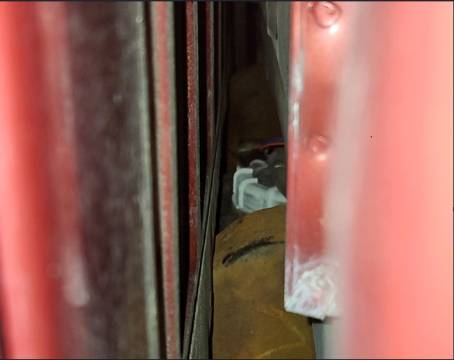

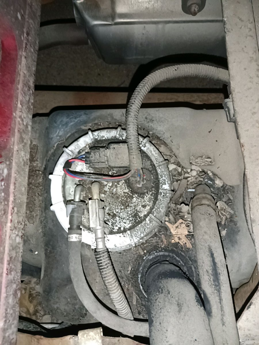

Tonight I pulled the bed off just enough to get to the pump. I was expecting to find a badly corroded connector but instead found a super clean unit from very good protection. I will grab a pig tail tomorrow and test continuity on the pump itself. For now I don't know what the discovery of the clean unit weighted against previous reading of 127.3 Ohms means.

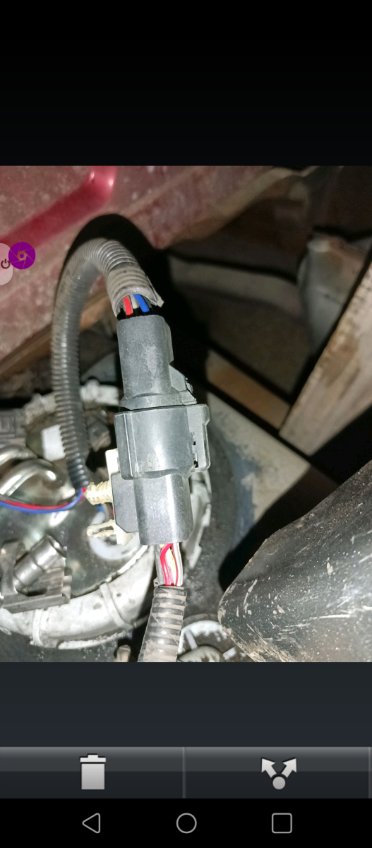

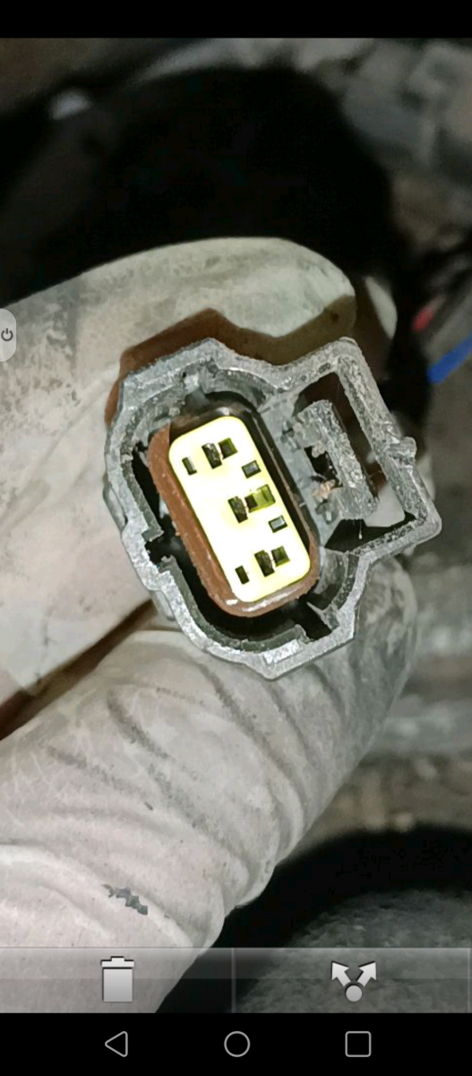

Hey guys I can't figure out how to unclip this harness. There's a tiny clip that kind of loops over, inserted a flat head and it's just broke off. Even between the 2 parts they aren't even shaking or twisting. Urgh!!!!! Please heeeeeeellllppp

If it isn't broken already. Just push in with your thumb on the red circled area while pulling the 2 halves apart. A little wiggling/twisting while pulling may help. If you're desperate you can try alternating penetrating oil and compressed air into the seam between the 2.
