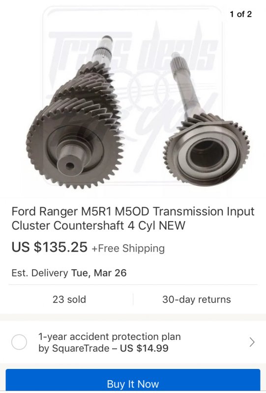

Now I’m on to plan B. I did find a 1995 trans with 130k miles on EBay about 2 hrs from me for $150.
Other option, I found this item on EBay as well.
