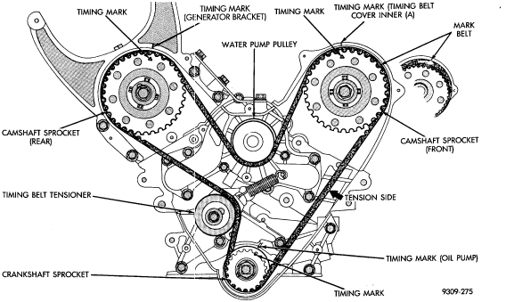

You will have to support the engine from under the pan while you remove the forward engine mount support, after doing so you can now see the coolant pump. To get the main support off you 1st have to remove the accessory drive belts, disconnect the vacuum hoses that run from the right shock tower area to the vacuum port in between the cylinder heads, (don't break them, they are fragile), disconnect the fuel lines and swing them out of the way, remove the front engine rubber insulator, remove the alternator, remove the p/s pump bolts which are at the bottom to the rear of the engine below the alternator, fastened to that main support & let the pump hang. The p/s fill tube is behind the alternator, it is supported back there by fasteners & goes down the reservoir which is out of sight.
With all of the *hardware* out of the way you can now remove all of the fasteners that hold the mounting bracket to the front of the engine. The coolant pump is driven by the cam timing belt, one needs to bring #1 up to TDC before removing the belt tensioner (mechanical sprung loaded), #1 is at the rear bank, not the front, there should be a timing mark on the oil pump *cover*, pull off the cam accessory covers, pull off the main front cover (plastic), when #1 is at TDC mark the cam pulley positions at 12 o'clock on the cam sprockets, release the belt tensioner & remove it, now you can pull off the timing belt & get at the coolant pump. The cams will remain their place but don't let them move while reinstalling the belt. When you get to the point of returning the timing belt start with the forward cam & work backwards underneath the pump pulley & then the rear cam, down around the loose tensioner & then the crank pulley. Manually check for no slack between the forward cam & the crank sprocket, reinstall the tensioner assembly, make sure nothing has shifted.
If one is into the engine this far it's good idea to replace the timing belt, inspect all of the idler pulleys as well. Replace whatever is not satisfactory.
Good luck with this........the 1st try is always the hardest, but it's no different than any other overhead cam engine that needs this sort of service.

Well thanks a ton for the info. Doesn't sound like a very fun job, but doable. I'm gonna grab a haynes manual for it and me and my brother in law are gonna have a go at it.
It's not hard, but for one who isn't familiar with the process it will be time consuming. A lot easier to do leaning over the engine bay of a Shadow rather than a Caravan. Air tools make the job go quicker.
If you find that the a/c discharge/suction lines are in your way & the system is not charged you can disconnect them from the expansion valve block at the firewall to swing them out of the way.
