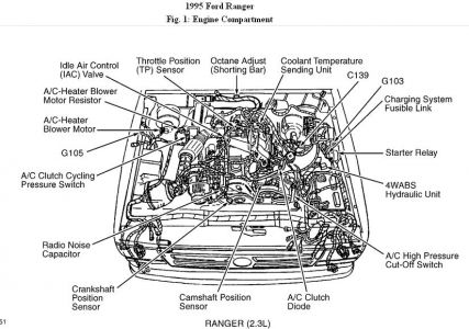

He came in yesterday and said he forgot to plug in the crank position sensor? He said he had to take something back off the truck to plug that in.
Thing is, I need to get my truck running. He said in a joking way that he likes having me stranded here. But he is lolly butting around and is now working on the pistons and rings for his truck.
This can not be that difficult to do. Can somebody tell me where I could find the plug, I can maybe take off what ever needs to come off or maybe my small hand can plug it in.?
I have a good general knowledge of the components on vehicles, I have changed the starter on this truck and I use to adjust the valves on my Toyota.
Please advise if this is something I can find and plug in myself, I went out there and looked, but didn't see any plug just hanging.. Where is it?
Thanks.
the cps shoud be right at the very front of the engine on the top left side of the crankshaft might possibly have to take the fan shroud out but i doubt it, should be able to get to it from either the top or bottom, its a smaller plug with only 2 wires oging into it
Thank you. I didn't see it, but he saw me out by the truck and came out to work on it.
Ehh, still not running, but it sounded like it wanted to start. Now he is putting the original coil packs back on. Geeze.
Google: ranger 2.3 crank position sensor images
You will see what he was doing and where he was doing it
