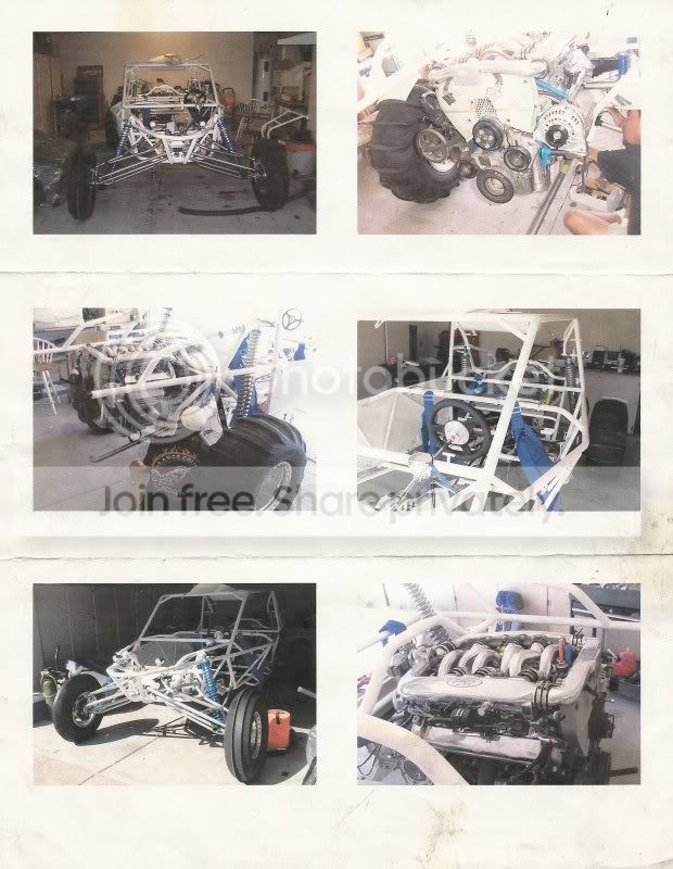

The SHO engine is a great engine to use for diffrent projects as they are way diffrent then anything else most people are using. We did one in a 5 seater sandrail and that car screamed. I know that some of you will say that the rail is a light car and it was to a some degree but this was a BIG rail and with 5 people in it it was well over 3k pounds and it still hauled tail. Part of the sucess of it was the trans gearing and later it got a nice turbo added to it to :icon_hornsup:. If you were to use this engine in a Ranger I would run a Turbo T5 trans from a T-bird or a SVO as they are strong enough to handle the abuse from the SHO engine and the trans is geared low enough in 1st and second to help the engine shine. Here is a few pics of the rail we built.
That looks like fun.
