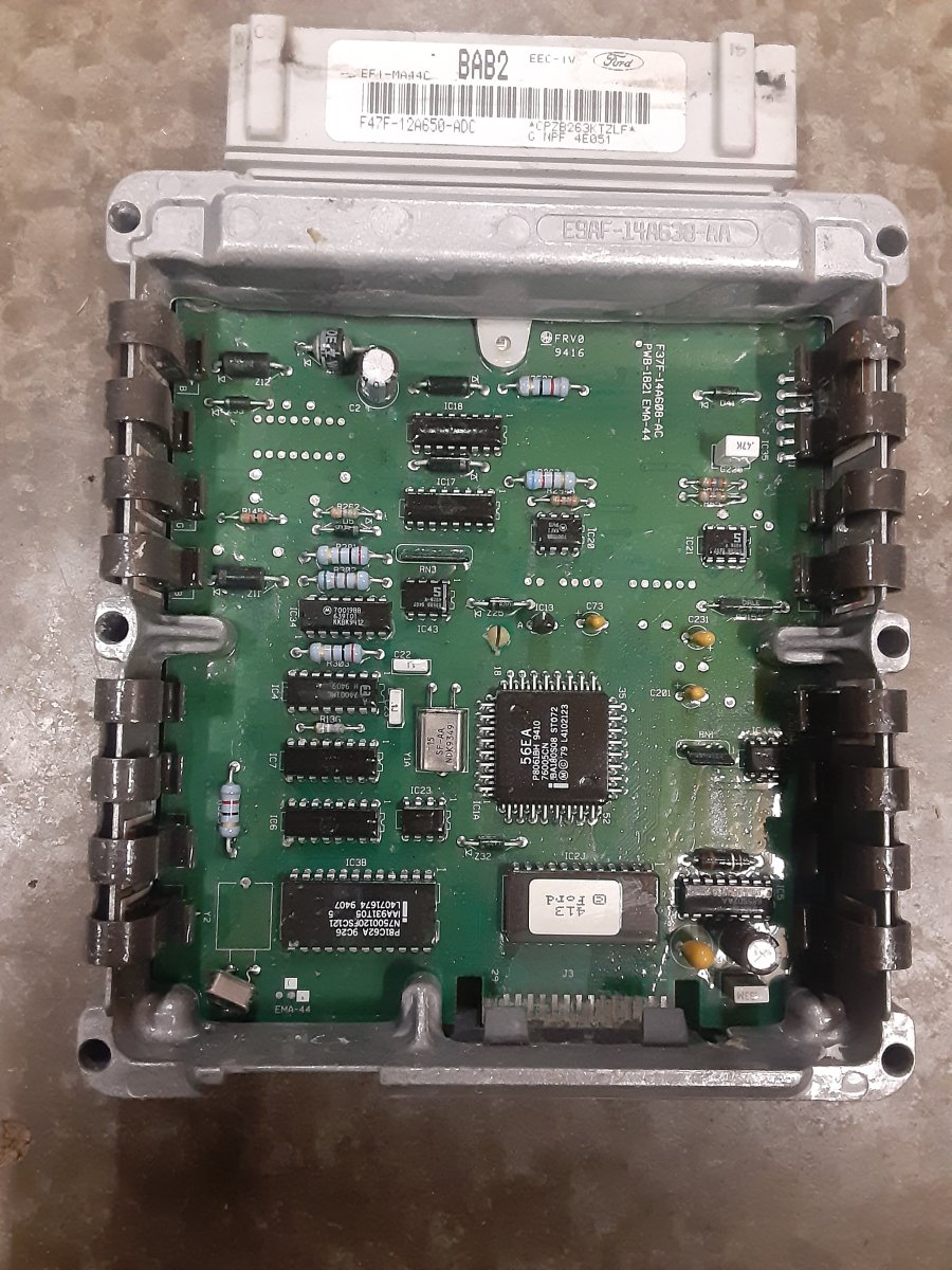

If you don't have a cam sensor there's pretty much two options with the symptoms you have and having two different DIS modules doing the same thing... either the crank sensor isn't working (at least one of the two sensors in it) or the ECM isn't seeing the rpm signal consistently from the DIS module and not letting the injectors work... Depending on your abilities I might pull the ECM (engine computer, in the drivers side inner fender I think) and pull the top to see if there's any corrosion or capacitors that look compromised.

Pulled the ECM, Here's a
photo. Looks ok but not sure what to look for.
Thanks
