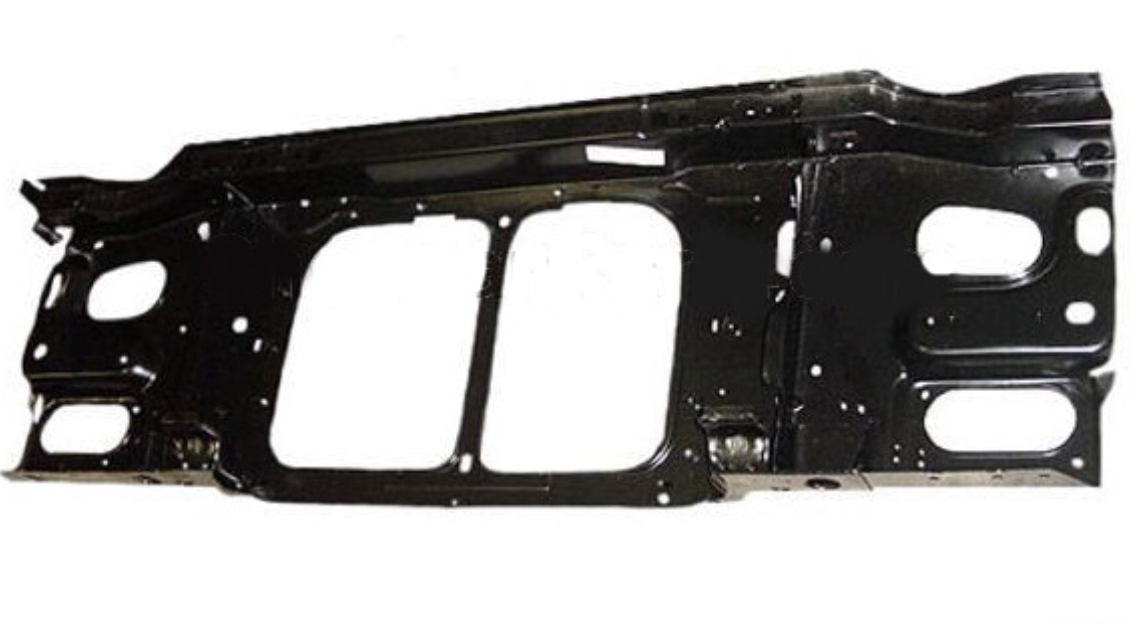

Bronco graveyard shows 89 to 92 same.
93 and 94 the same.
95 thru 97 the same.

But I think you can trust the Graveyard.

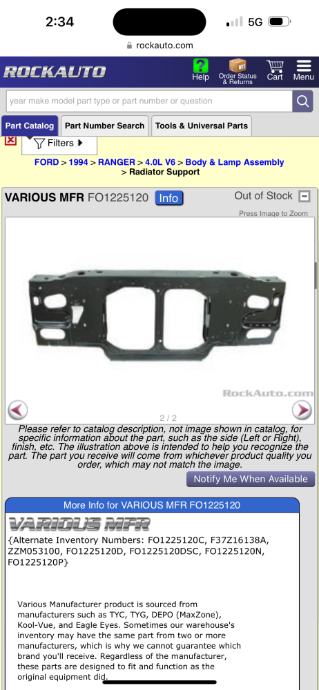

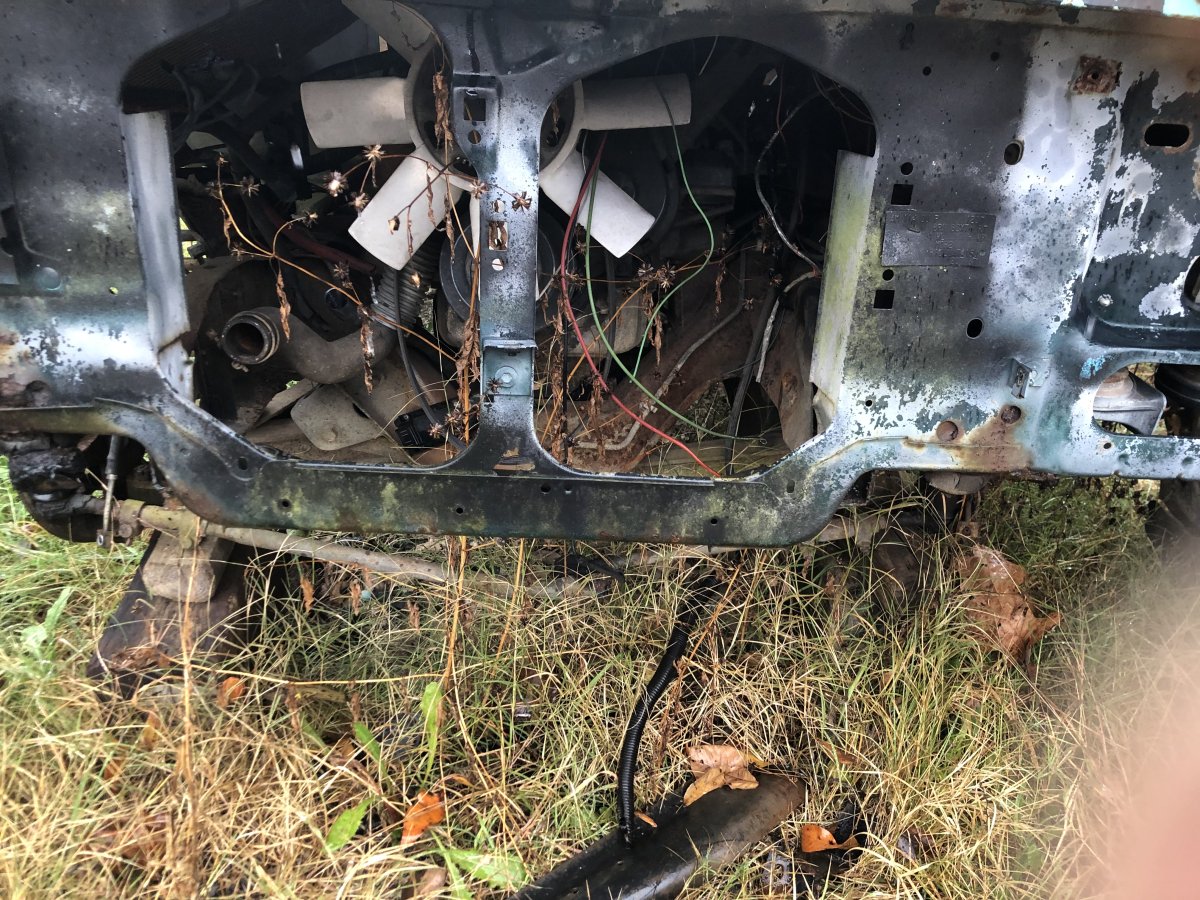

The 97 has a 13” or so hole for the radiator and the 94 is about 16” so I don’t see how that’s gonna work. I also bought a new one but it’s for the 92 body style. It said online 91,92,93,94 the bottom are the same but the sides are different

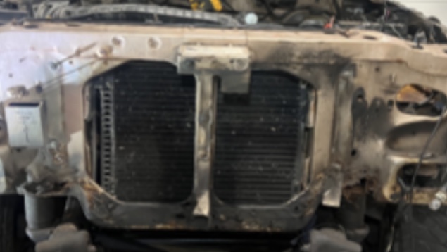

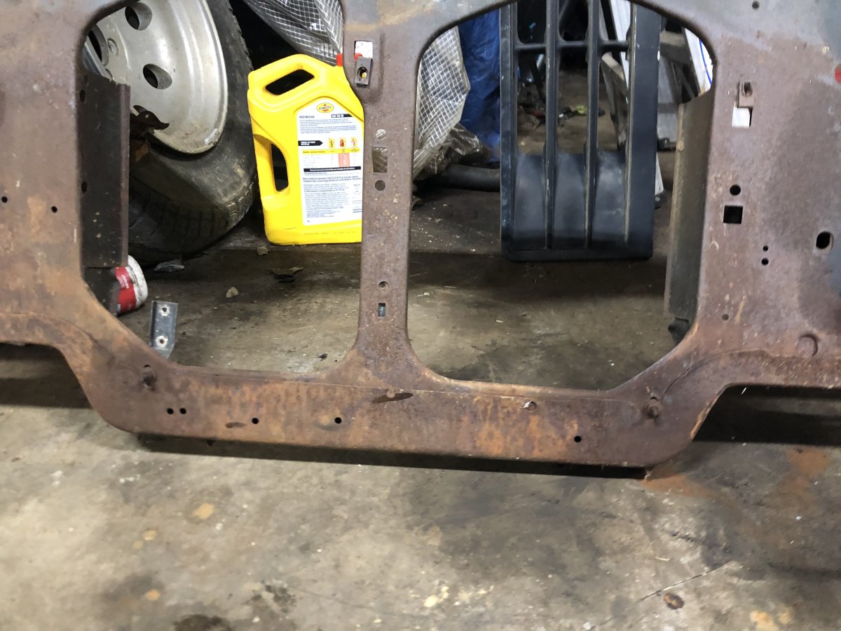

Mine doesn’t look the same as bronco grave yards 93/94. The one I bought looks just like that but it’s not the same. Mine has the dip in the bottom like the 92 style but the top and sides of the 95 style. It’s like a mix of the two put together

I think yours looks just like the 95-97 model. The picture at the graveyard is from the engine side and at an angle so it doesn’t show much of the lower drop. Do you have a build date on your rig. I’ll bet it late 94.
1994 Ford ranger core support
It’s August I think but I have a 97 mount from the junkyard and I don’t think the radiator is gonna fit in it without having that swoop at the bottom

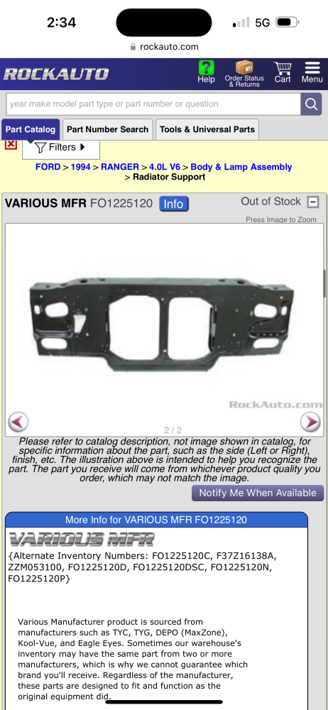

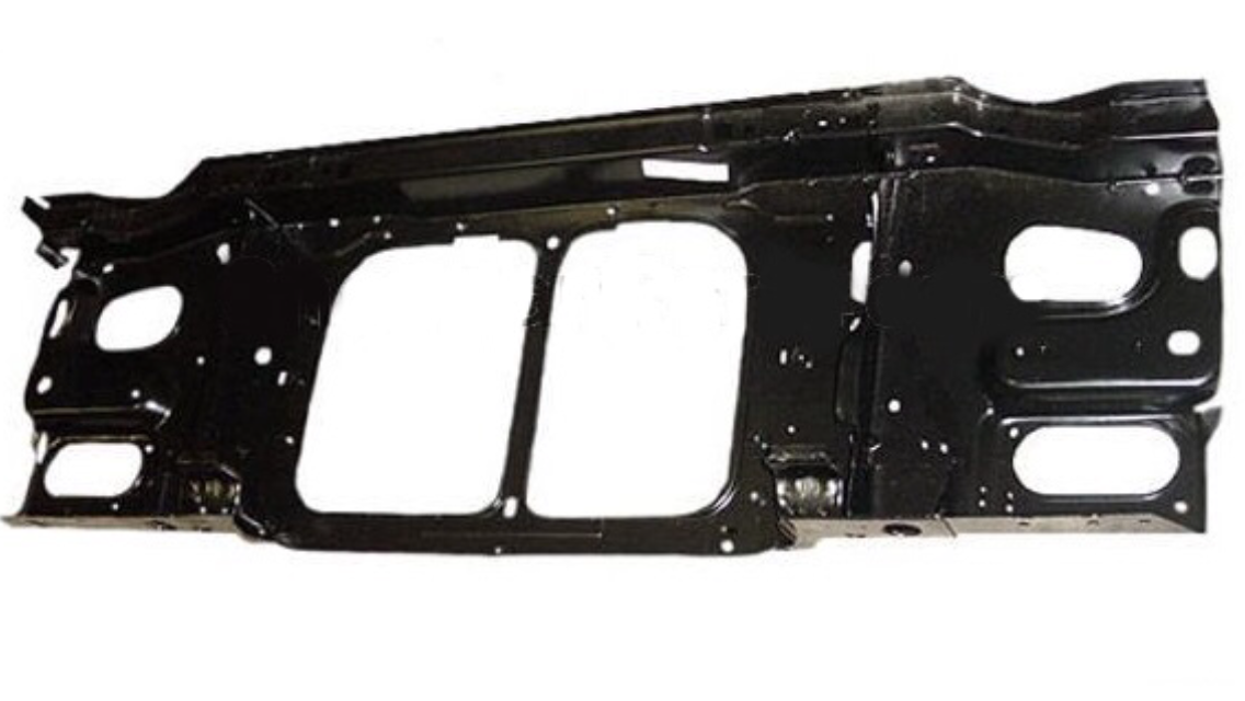

This is the one I found that looks just like it but it’s out of stock everywhere. It have the same headlight holes as the 95+ but the same bottom as the 92

Looks like both are out of stock. Have you checked LMC Truck.
It must be a bastard year because they so 88-92 and 95-97 but no 93/94 on lmc truck

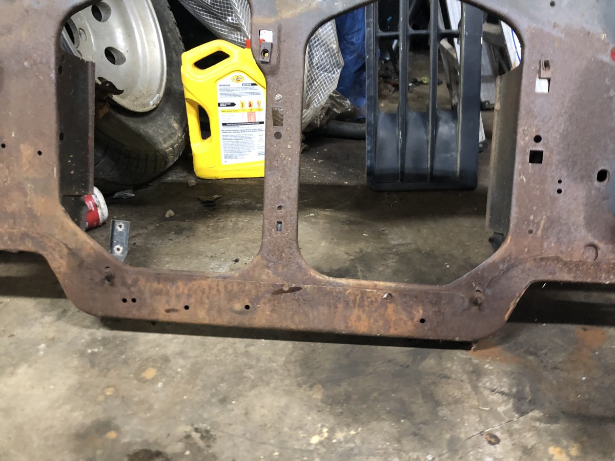

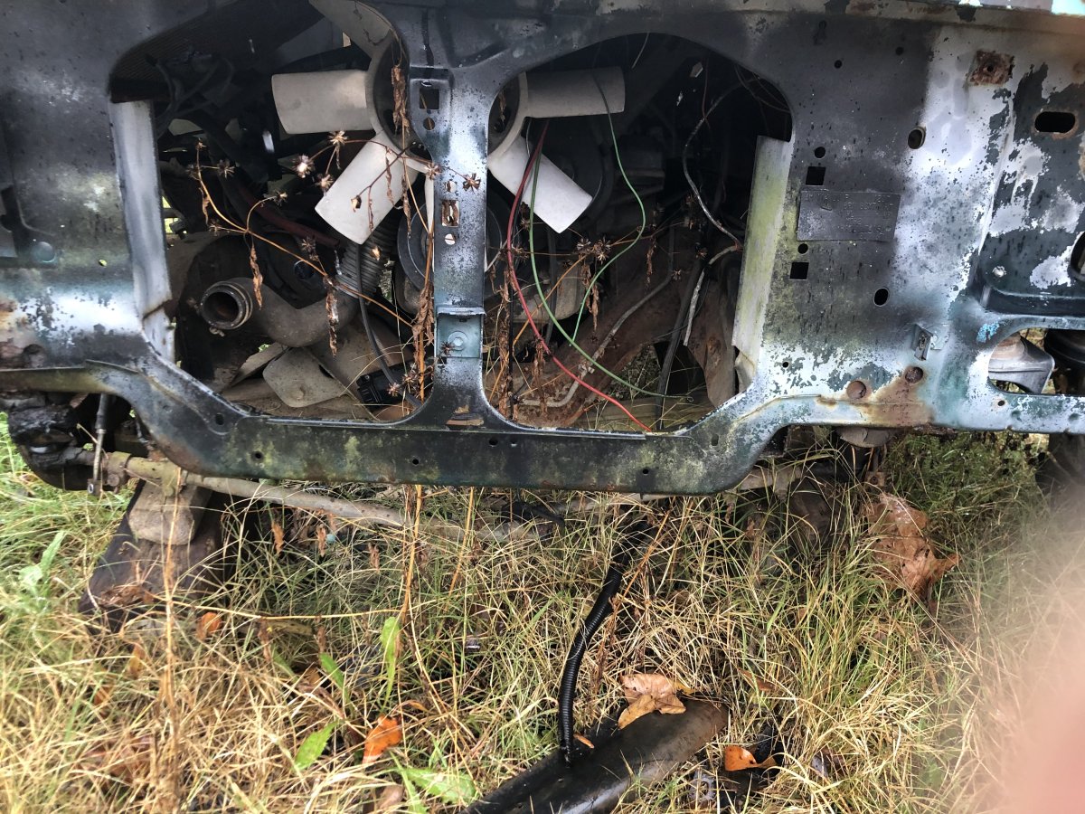

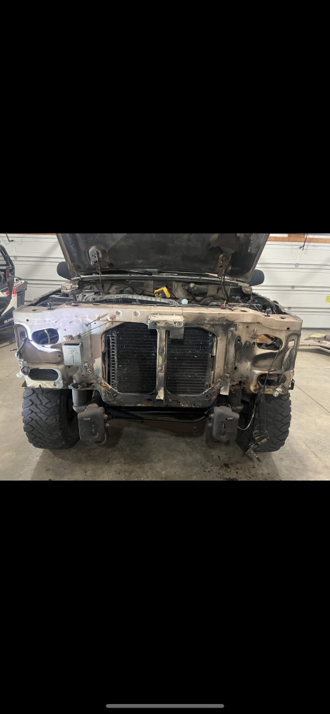

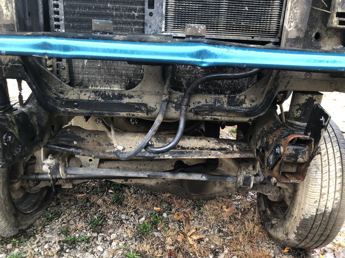

Here are three supports I have . They are 91 ranger 90 BR11 and 94 Explorer . They are the same . Removing a lot including complete dash for my 90 .
