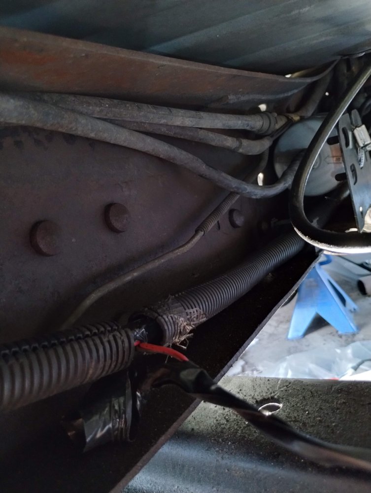

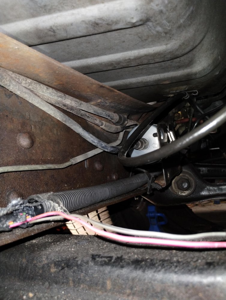

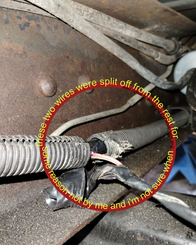

the problem leading up to the current crank/no-start situation are as follows. a while back I had some issues with the fuel pump relay so i pulled another power distribution box from byot and it seemed to do the trick but then intermittently when downshifting or just coming to a stop, I think only when doing so from 2nd gear,
whenever I would press the clutch pedal it cut the power to everything but I would be able to restart it no problem. google told me it was the throwout bearing. I bought a new one but have yet to have the
guts to take on this job as I'm unsure of my ability to complete it. the other day while in traffic the power cut out and I was unable to get it started as was typical. pushed off to the side of the road I fiddled with the relay until 2 hours later it started and I was able to get home. I drove it for another day until it stalled again and won't start. The fuel pump isn't priming and I found this under the truck. any idea what these are? how they could have gotten like this?

Hey David, you better get that figured out before you go any farther, loose wires cause fires
I would tend to agree and at this time I'm left with no choice as it is not starting at all.
Port Neches eh, cool place, I worked off the Texas and Louisiana coast quite a while in the late 70s into the mid 80s
You need a motors manual for basic stuff, even though this isn't basic, it is repairing damage the previous mechanic botched
You NEVER want hot wires laying ANYWHERE in a motor vehicle.
The CAPS are not directed at you, but at anybody who may reference this thread
Your 94 and my 93 are basically identical, they were the introduction to the 4th generation I believe it was
You need to figure out where those wires come from and where do they go
You can look on ebay and find old Ford CD's that are old shop manuals. They are not real hard to navigate but you must realize they were made before even windows 95 was released
Still they are a treasure to own in circumstances like the one you are in now

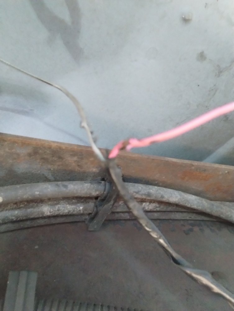

I didn't notice this until tonight. i don't know how it got this way but it had to be recently.
You need to trace the wires and know where they go and what they do

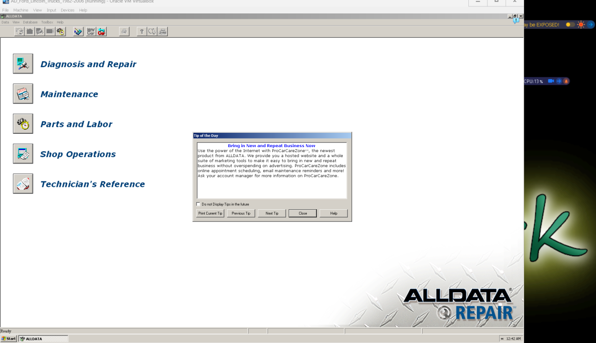

i did buy this a while back
I am not certain if that is what you need or not sir, it appears to me to be more of a halfway fix that will still land you in a shop

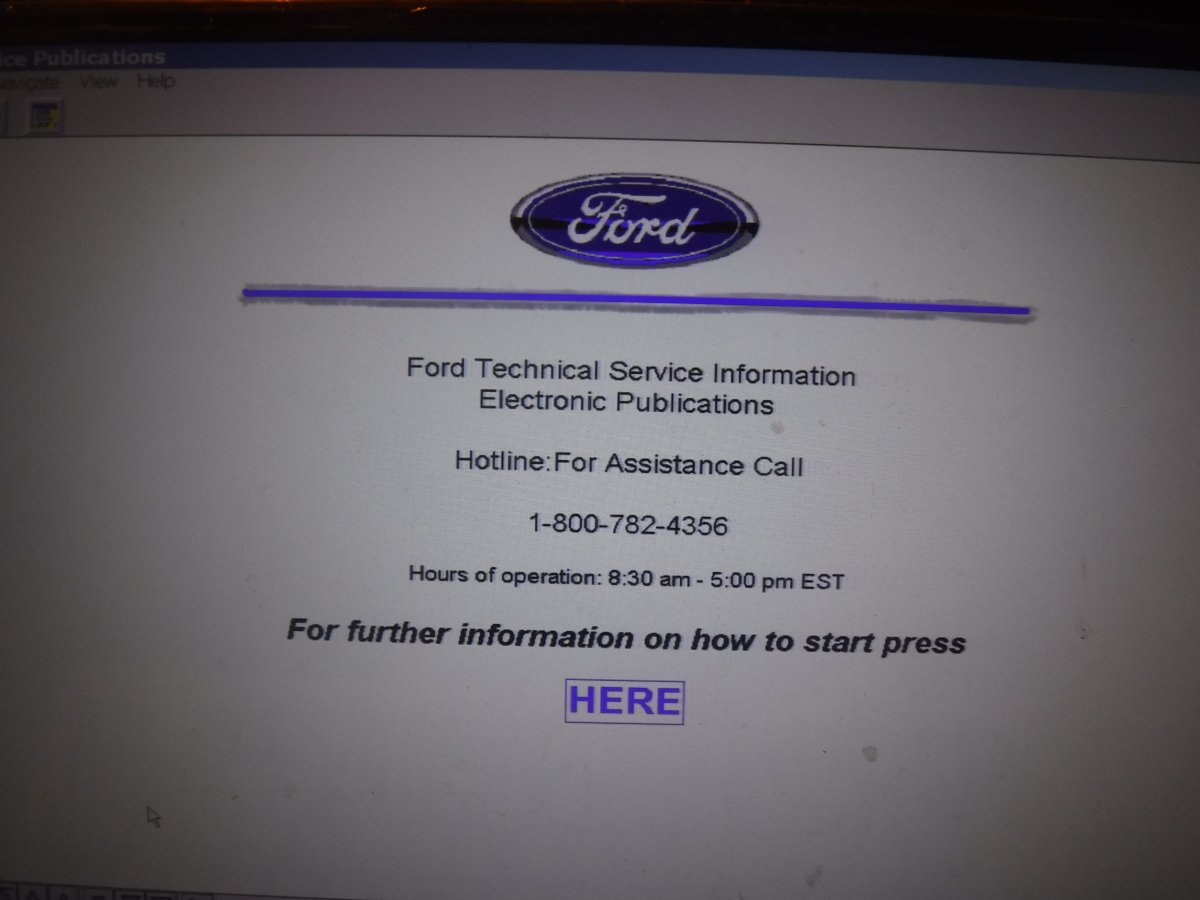

I found the one I have on an ebay listing, at that time it only cost me a few dollars. It has paid for itself over many times
Just remember it was made before windows 95 ever existed, and it isn't hard to navigate with that understanding in mind
