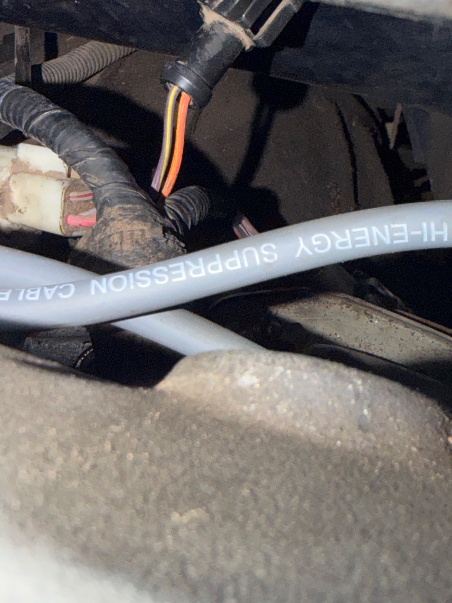

Just finished rebuilding the top end of my sons 94 4.0L automatic transmission and can’t find where this connector connects. It’s on the same pigtail as O2 sensors near firewall (4 total connections). Was told in Facebook group this might be a transmission connection but can’t find a mating connector. Any help is appreciated.

I only see 2 pins there. Can you tell what the wire colors are?
Some 2 pin connectors I can think of would be a speed sensor, air or coolant temp sensor, reverse light switch (maybe a neutral safety switch). The reverse and possible neutral safety would be on the transmission. I was trying to look up a diagram but it seems charm.li is down right now
Looks like a black/yellow and orange? Wire

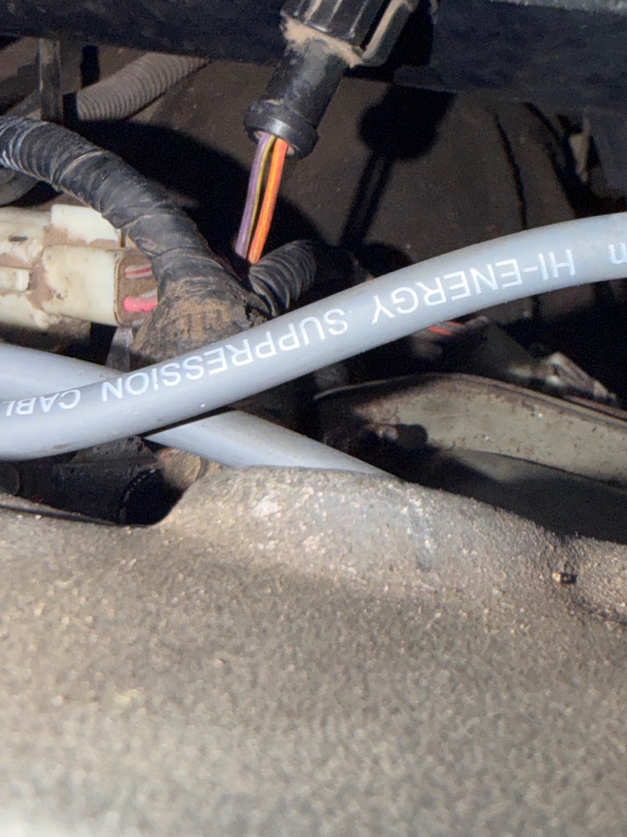

  • 1994 4.0 automatic wiring connector location
The picture looks like purple/yellow to me which may be the torque converter clutch solenoid. If you're sure it is black/yellow the only thing that comes to mind is the a/c compressor.
