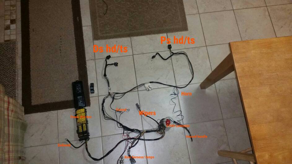

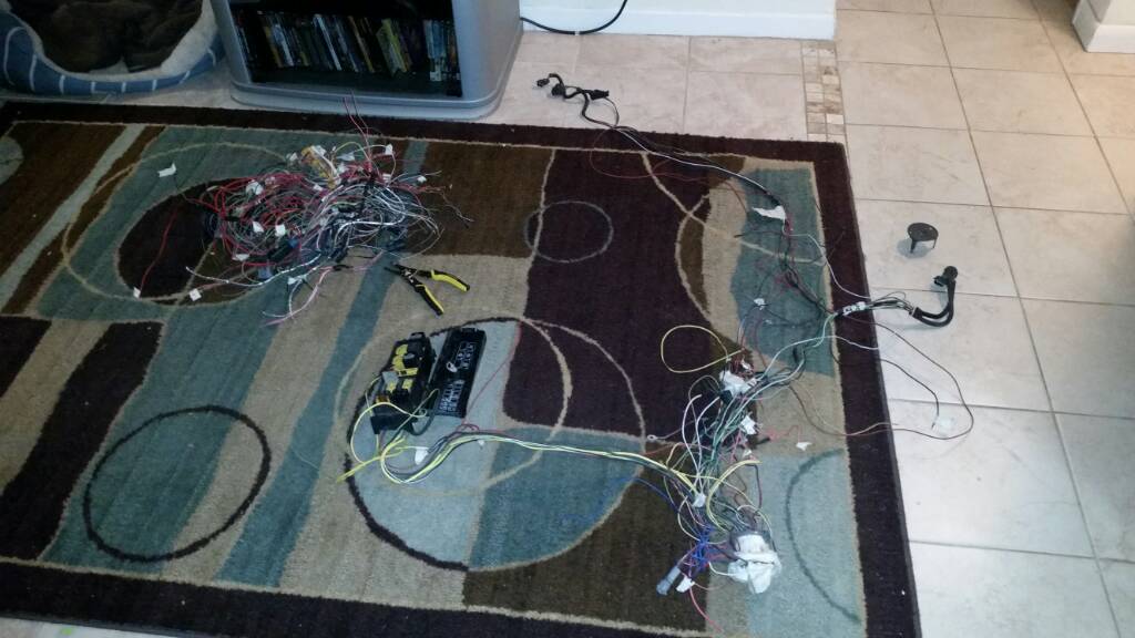

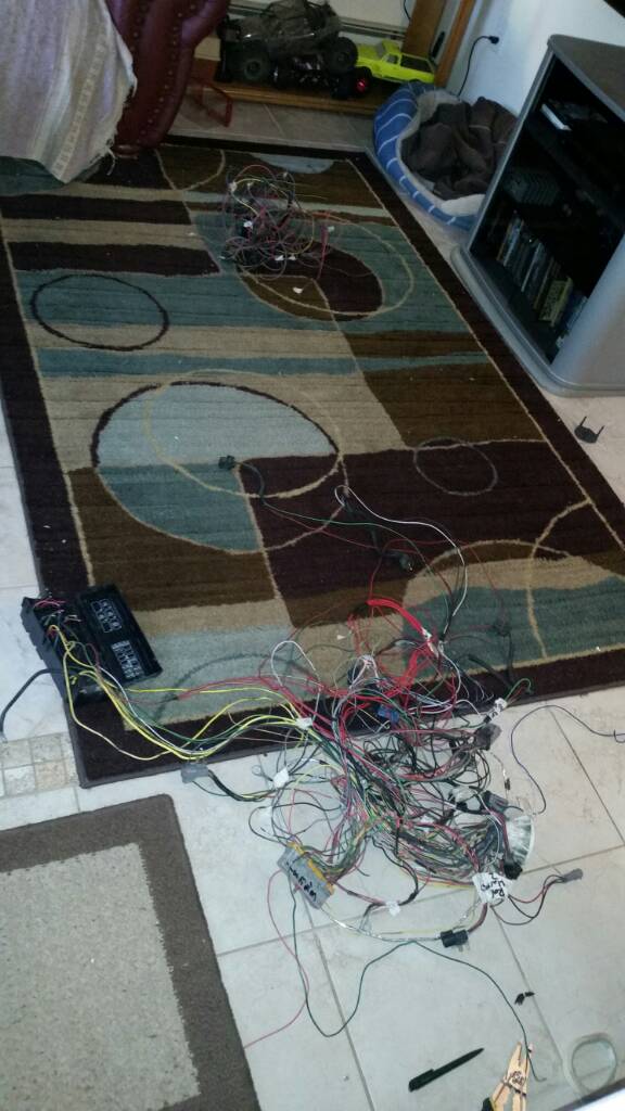

So not much or an update but I did end up making a little bit of progress today. I sat and stared at the harness and then figured..... reverse engineer what I don't need out of this B!?. So with that thought I went to hacking ish up:
And finally to where I have my wipers, horn, headlights, blinkers and connector to the rear lights :
Once I get it back in the truck, I'll hook a battery up and test the systems. If it's all good, I'll loom it up and tuck it out of sight.

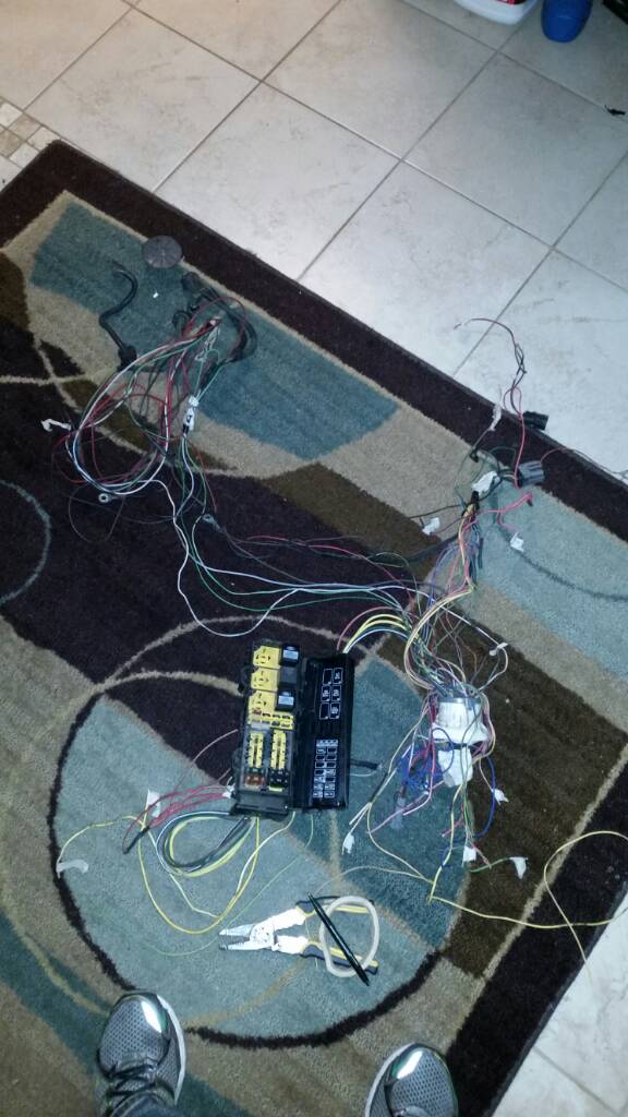

Gotcha thanks bud, I just watched a quick vid on YouTube, it was a 91 but I'm sure it's not to far off...said the closest two wires to the firewall, in the 91's case two pink wires, get jumped together..easy task. I just finished up a pre lume on my harness...hoping when I plug it back in, I get the few functions I meant to leave. Lol.
Updated pic of pre lume, lume:
I taped off all the ends of exposed wires before bundling anything up. There is still a few wires I'd like to clean up but I need to test before anymore hacking.[emoji418]

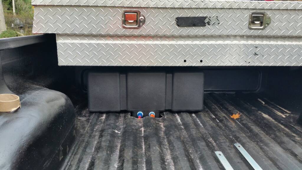

Quick update on the little bit of progress I made today. I got the harness in and have all functions minus the starter. Lights, brights, turns, hazards, brakes, horn, radio, and blower motor. The battery was pretty dead so after a while of messing with it I decided to move fwd with ish and get the cell mounted.

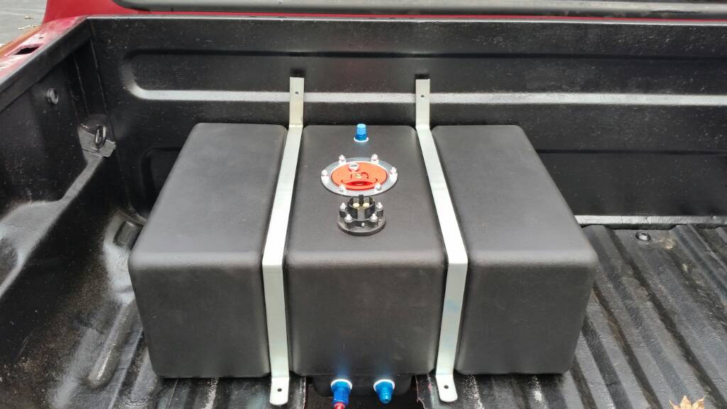

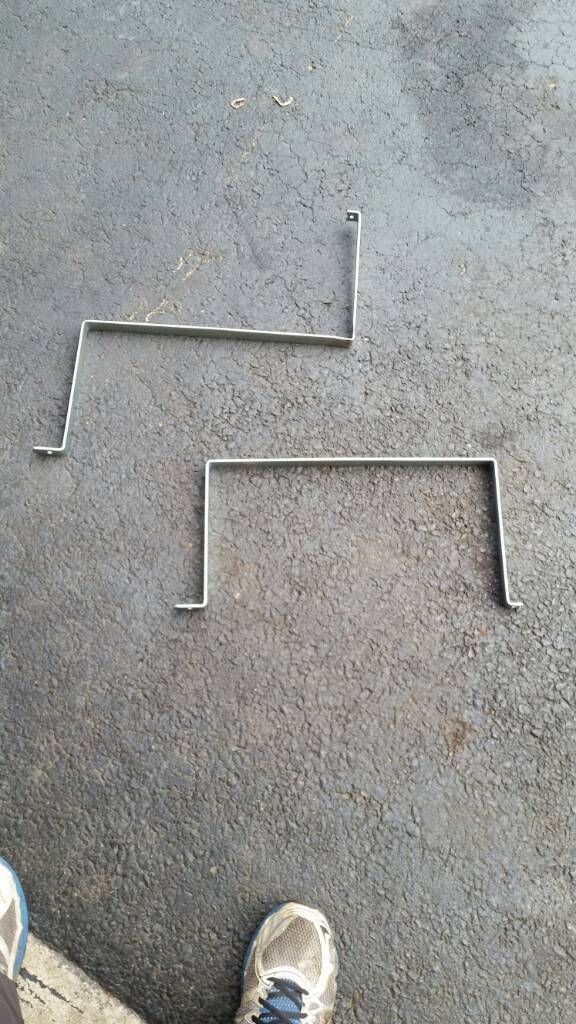

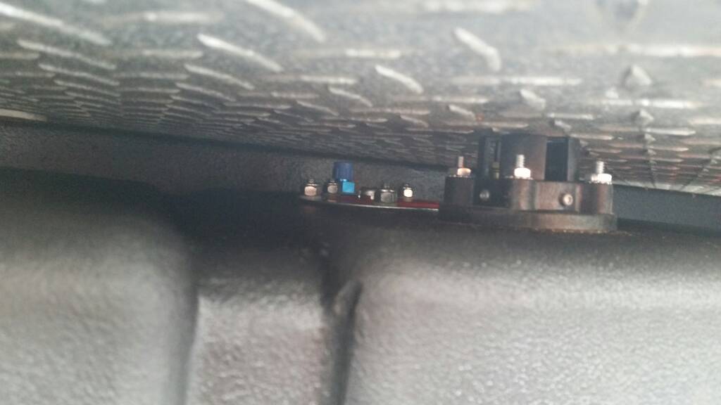

I had to cut the bed to make room for the sump on the cell and reshape the mounting straps as I needed it to sit against the back of the bed. It's going to fit nice n snug under the tool box. For extra safety clearance I'm going to add about 1/2 of rubber under each side of the tool box sitting on the bed. This will hopefully ensure that when the shits twisting, it don't contact the cell. Also, you notice it's off center, I'm relocating the batter to the right of it when I get there.

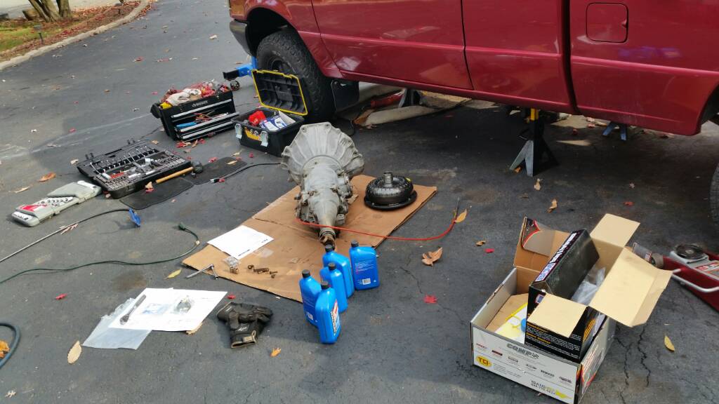

So today I set out to drop the trans n get that ish going. I manages to do so with not much issues getting it out solo.

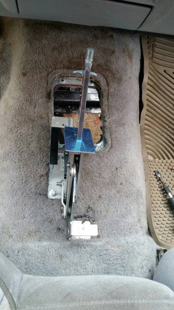

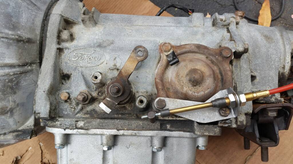

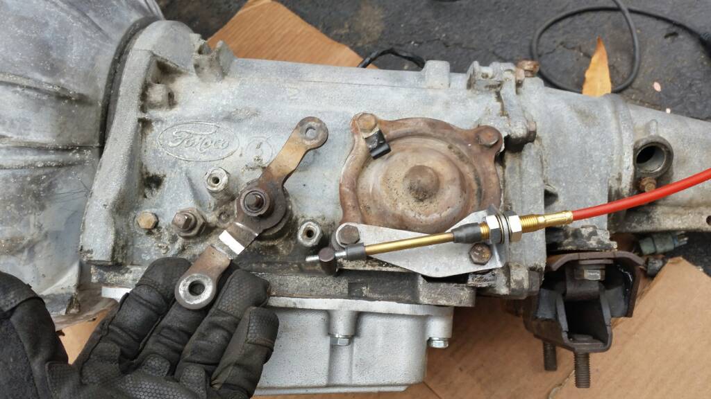

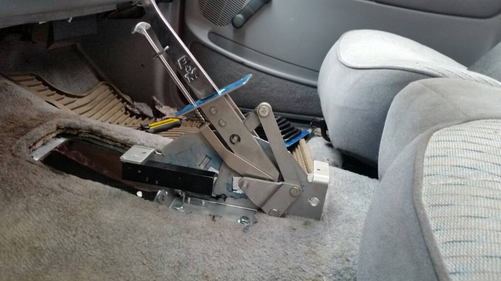

Once out I started to mess with the shifter set up. I got the cable ready to go on the trans and the shifter set up on the foor..remember when I said I seen some sloppy installs...well maybe the c4 is why, idk but my shifter will have to sit back farther than originally thought. Leaving a space to fill where the old shifter once sat. Ull deal with this to make it look nice but I was thrown off by how it loooked. So for the shifter to work right, u need to hack off the lower portion of the shifter linkage:
The gapping hole:
Cable installed:

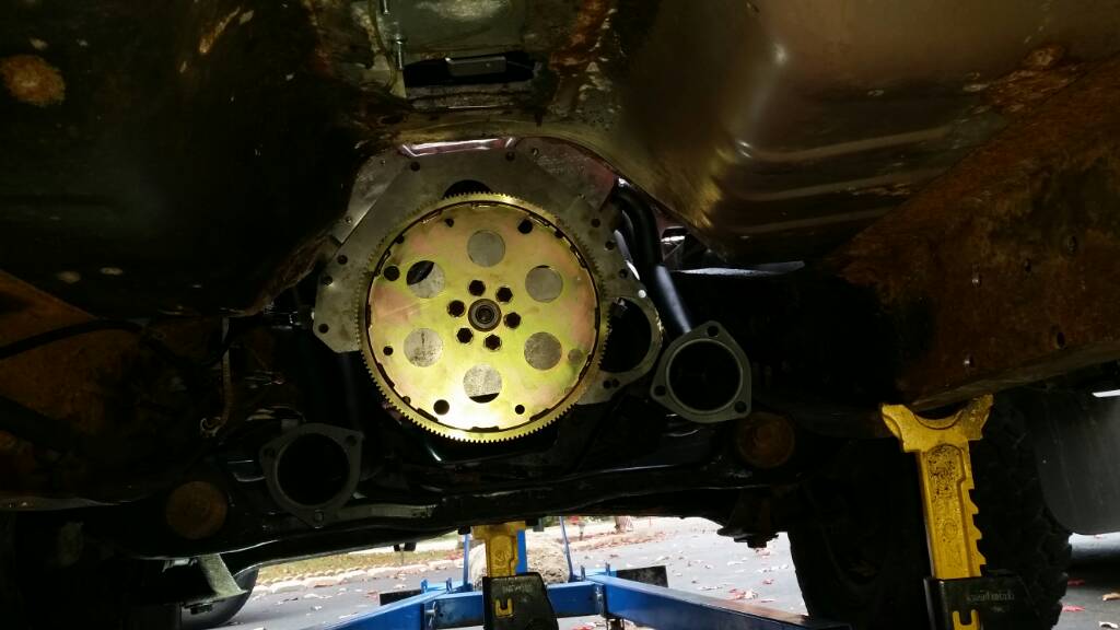

I got thr t/c installed and seated ready to go with one quart of fluid in it.

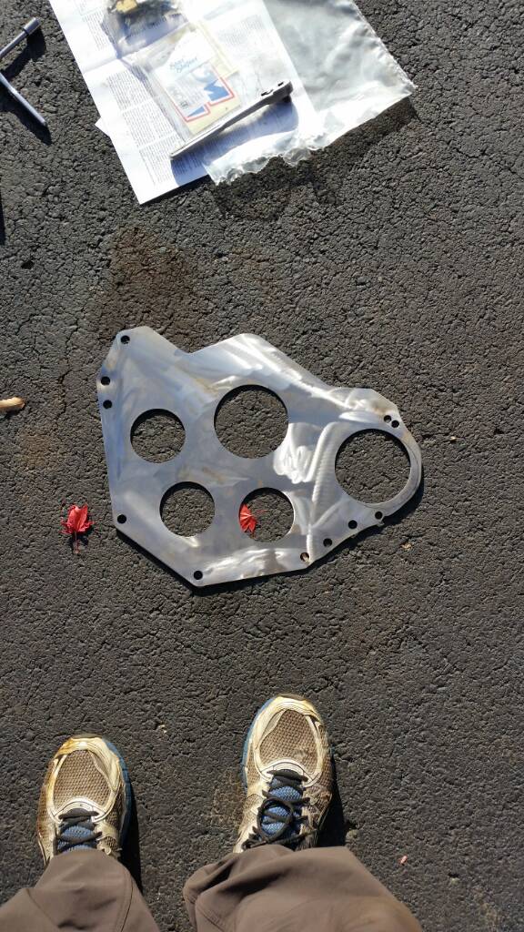

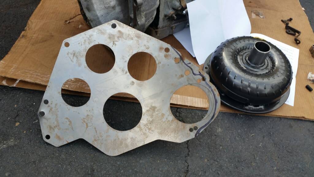

From there I moved to the engine backing plate. It needed to be trimmed since it was made for both the 157 and 164 tooth bell housing mating up to a 302.
I traced out what needed trimming from the engine side.
Cut and cleaned up ready to go back.

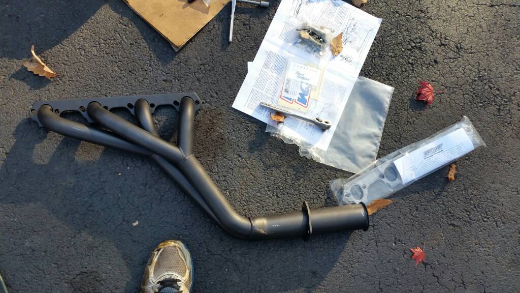

From there moved to the headers to make sure all was good with clearance. They fit snug, all I can say. Passenger side just sitting there.
Diver side header

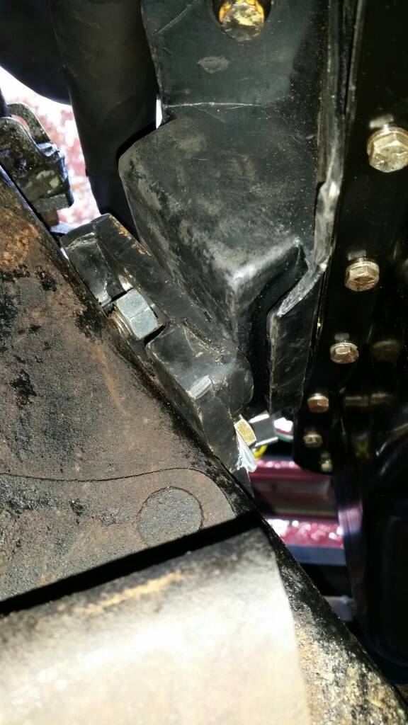

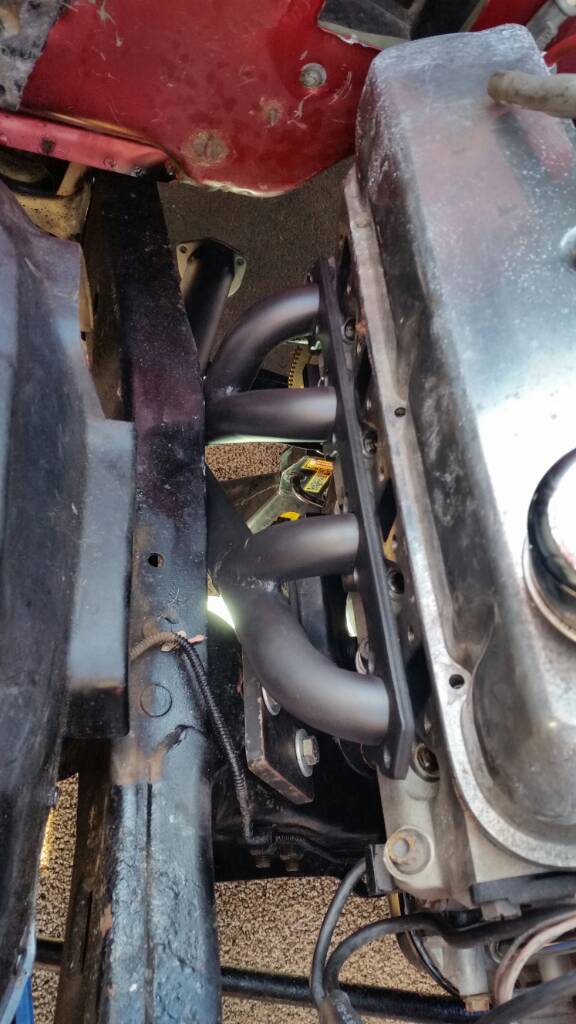

I had to pull the engine up just a bit with the hoist to get the headers in.

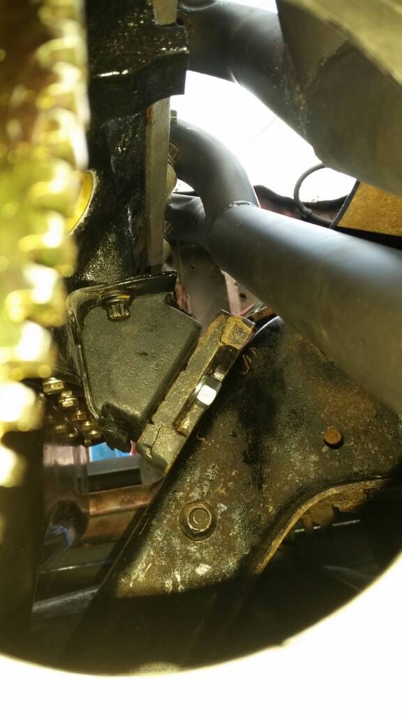

Once I got them tightened down I figure to go ahead and bolt the engine down to the mounts.
It's tight getting in there:
So I felt like I made serious gains today with the above. I figured it's still light out, get the trans back in. So i attempted. Between the headers being in the way to clear the bell housing and the engine being tightened down to where I can't move it to marry it with the trans I ended up running out of day light n had to pack it in. I'll have to attack this later in the week.

Man great progress brotha . I'm down for some more pic of the headers top and bottom side when you can . I'm really thinking the tri's are for me [emoji106]?
I just wanna go fast [emoji48]
Hey mang,thanks! and no problem I'll snap some more this week when I'm digging in. They are pretty nice in construction, just Sucks banging em up n scratching the finish :/
