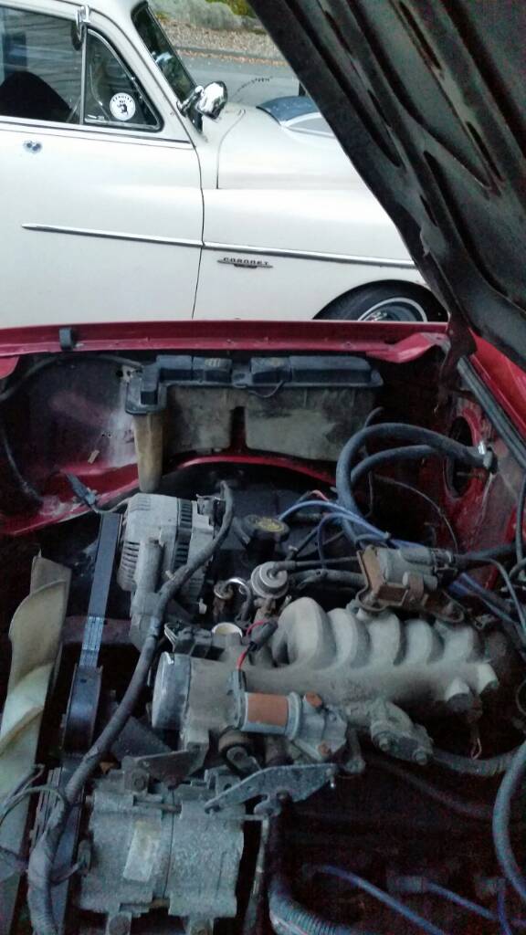

I finally got to driving the lil ranger around today and i gotta say, it drives pretty good. The guy i got it from owed it for 4 years n took pretty good care of it. Minus a lil shake at 55-70 mph it was a good maiden voyage. It'll get inspected as is so I can get two years out of with the swap complete. It'll be almost Classic at that time so I'll cross that bridge then.
Hoping to get my insurance card to go get it inspected this weekend and from there it'll be torn down for clean up n fitting. The engine n trans will be ready to go in this weekend once I get the parts in from summit tomorrow. Gotta do a trans fluid change and get the torque converter mounted along with the flexplate. Also need to finish bolting up the power steering pump and engine mounts.

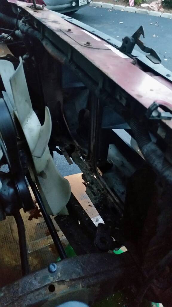

I used the mechs. from the 69 on my 84, but I got a Duff Radiator (tucks up in the supports). I did have to use a short snout water pump and then I only have a couple of inches between the fan and rad. Its tight. You could always opt for a electric fan and loose the width of the mechanical fan, lots of people go this route. If you use a mechanical fan make sure you build some kind of shroud. Mine is something I cut down and made fit from a 150 (I think). I can snap a pic of it if you need it.
Thanks for the input on the mechs. I'm trying to keep it as basic as possible and have opted for an electric fan. Actually came with the 3 core rad I'm guna try and stuff in there. I'm not sure what size water pump is on it now but if I have to swap it out when I go to test fit I will.

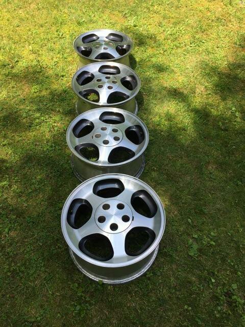

On another note, I am hopefully scoring a set 97 cobra rims and an exporer rear end this weekend. Got parts delivered at the rents so I'm excited to get to it.

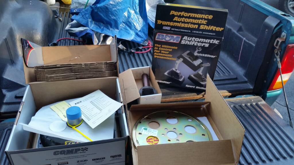

I went thru the parts order and alls good there, gotta love a 2 day delivery from summit:
TCI stuff seems pretty stout and looks good. Same for the B&M.

Picking up tuesday. 17x9. From a 97 cobra, look to be in great shape.

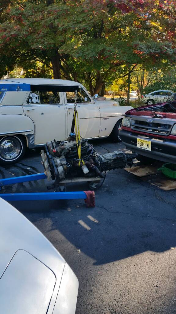

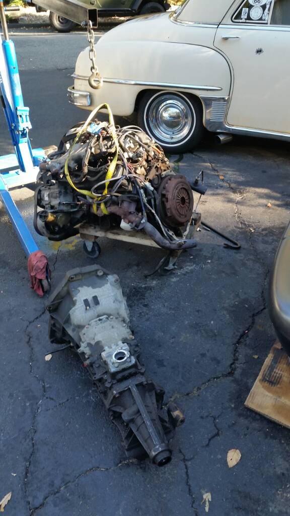

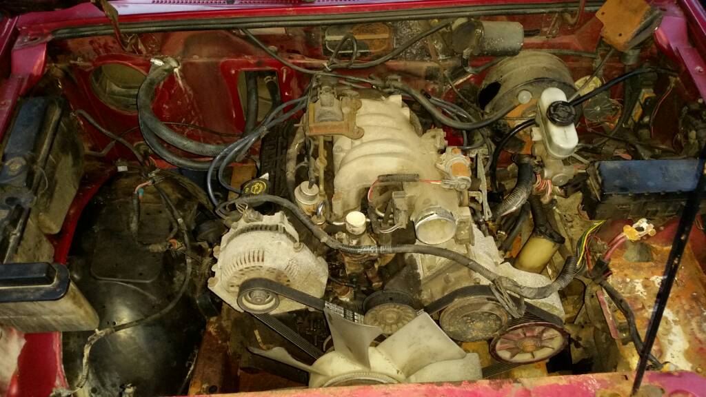

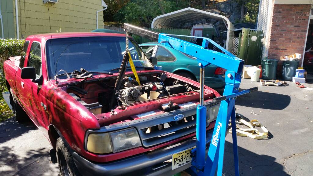

Got the engine and trans out. 1st time building n tearing down to this point so I took my time and just tried my best to not mess anything up too bad. Only ended up breaking the dizzy cap on the way out:
From there I broke it down n took the trans off. My dad is going to put that in his for the time being. His is pretty shitty.

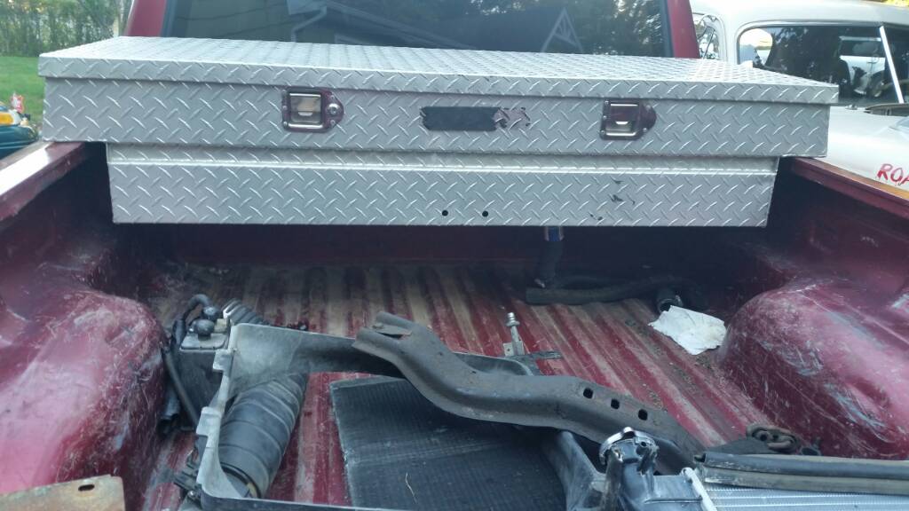

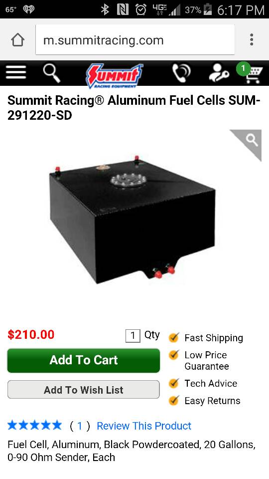

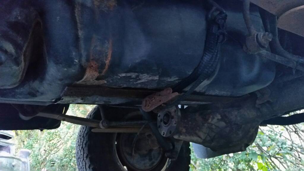

While under the truck I noticed the gas tank was being held up by a ratchet strap, guess one of the straps or something broke and that was the fix. I'm thinking of just doing a fuel cell in the bed. Would make for more room for the exhaust as well. This is the piece I'm looking at from summit.
I'm guna measure the area under the tool box in the bed and see if this will fit in the space. If not, out it comes.

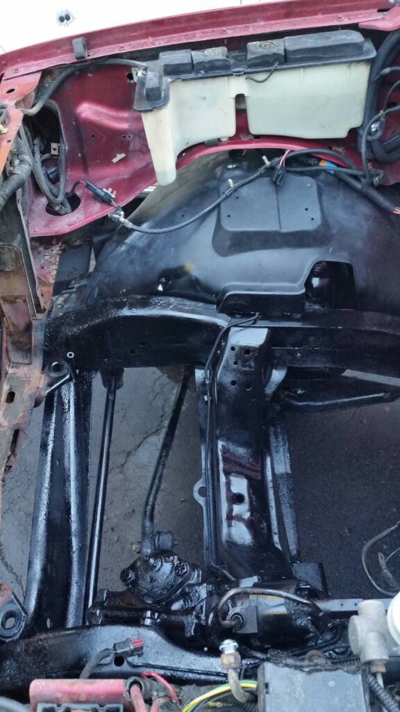

Started to clean the bay.

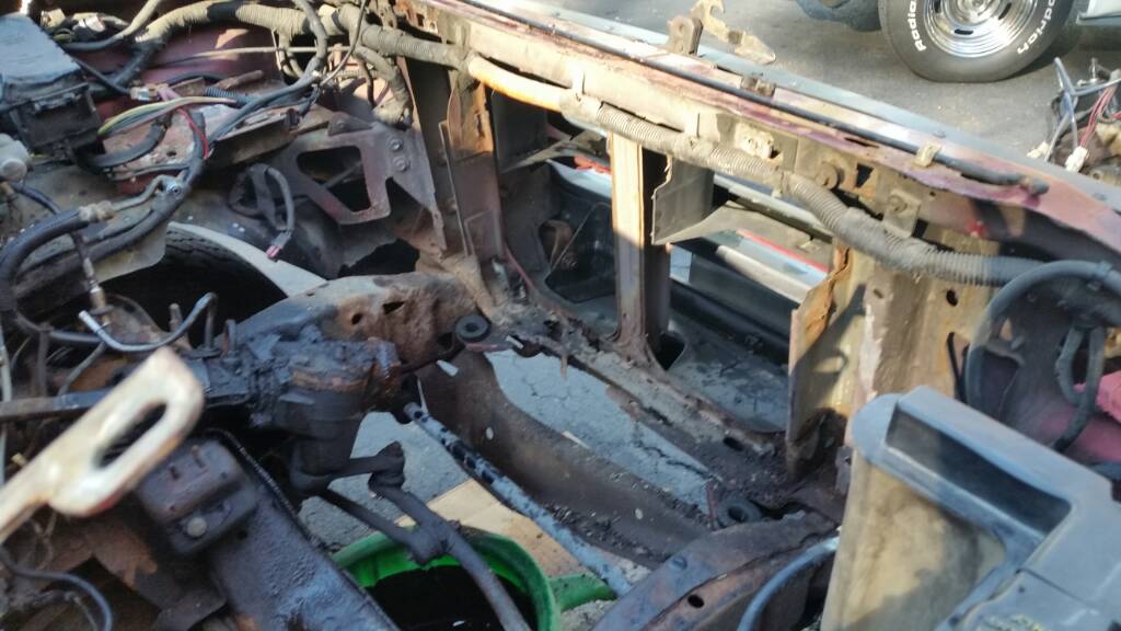

Taking tomorrow off to celebrate Columbus day and make some more progress. I have to get some heavy duty cleaner n paint as I didn't get time for that today and will hopefully be able to get the mounts in. I also need to cut some of the radiator area out and repair that due to some rot. All good tho, going to see how much room and what needs to be modded to fit the big 3 core summit rad & e-fan nice n tucked. I'm figuring something like what ATX had to do to his lower support. U can see how mines pretty much gone in the middle

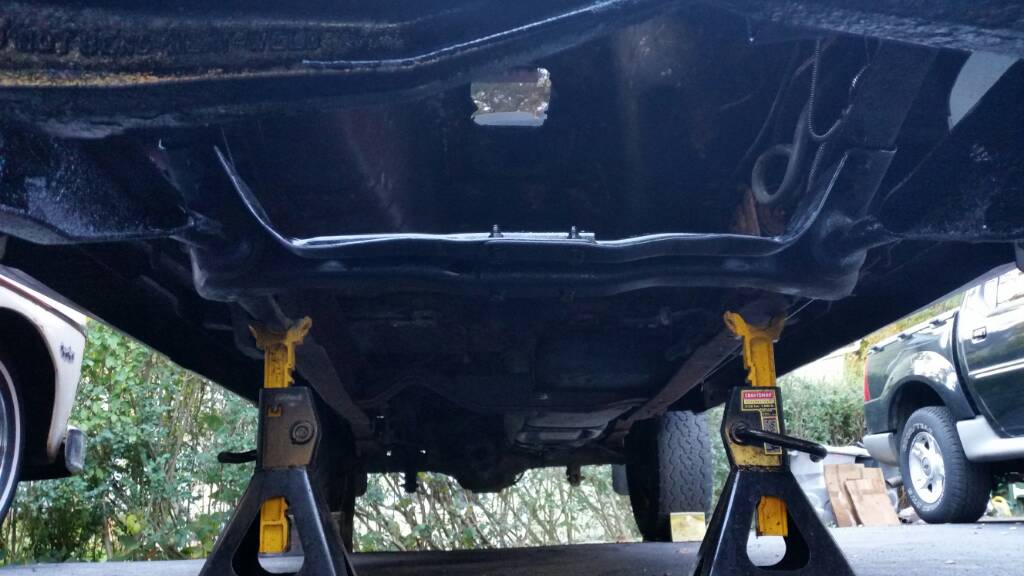

I started off by hacking the rest of the stock exhaust,easy task with the Sawzall at hand.
I moved on the to the drive shaft, which yesterday beat me and left me with a striped bolt head to drill out (the ones holding the middle carrier bearing for the 2 pc drive shaft). So I set out to drill it out only to find my bits suck and wasn't getting to far. My pops lent me a hand here and broke out his tools....ended up getting it out after an hour of with fighting it.
OK so I moved on to the stock motor mounts and got the driver side one off in 2 mins. The passenger side took a bit longer since I had to remove the I beam to make room to get to the nut..then I click at a time backed it off.

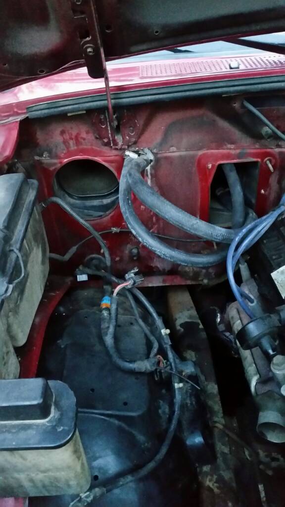

Those two simple task ended up eating a good portion of my morning work. Once I got that out of the way I was on to degreasing and power washing the bay. Got that done and scrubed/power washed the under side of the hood. See a while back the ac had caught fire on the previous owner and marked the under side good. It cleaned up decently.
I am going to checker board the underside :) got it primed today so maybe next weekend on that.
After the bay dried out I hit it with the air and got most of the lose debris n flaking rust/paint out of the way. I them hit it with good ol rustolium to have a good clean base to work with.
Also, I mentioned yesterday about a possible fuel cell. The one I posted is 20 gals. And is 10×20×? ( I forget ) but I measured under the tool box and the cell should clear with a half inch between. I'm thinking of going this route and further simplify the whole system. thinking of a filler inside the toolbox. And thinking of relocating the battery in there too, hide it and still be accessible. Also the e fuel pump would be wired and mounted in the tool box for clean safe keeping. Looking at the Holy red labeled fuel pump if anyone has any experience with em.

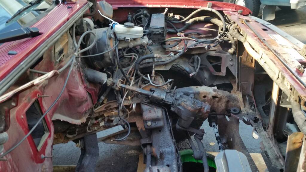

Here so pics from today. No to much to show.

Looking good brotha . Like the progress , fuel cell idea .Figure out anything on the supports ? All I can say about the mounts is every motor sets different I guess and your going to have to play around with mounts a lil or a lot in my case lol
Hey broskie thanks, I'm feeling good about the progress...one weekend at a time. Next weekend I hope to get alot done. As far as the rad support goes, I'm going to cut the bottom out and probably brace it with flat stock. I really need to see where the rad is going to sit, I may have to resort to a 4.0 if I can make what I have work.
The fuel cell idea is really working me over right now as the current tank needs some help. Budget wise, I'm going to see if I can make the stock stuff work since it'll be much cheaper to fix the braces from what I found looking at LMC truck...like $100 vs $300...
If I have to go that route, I will.

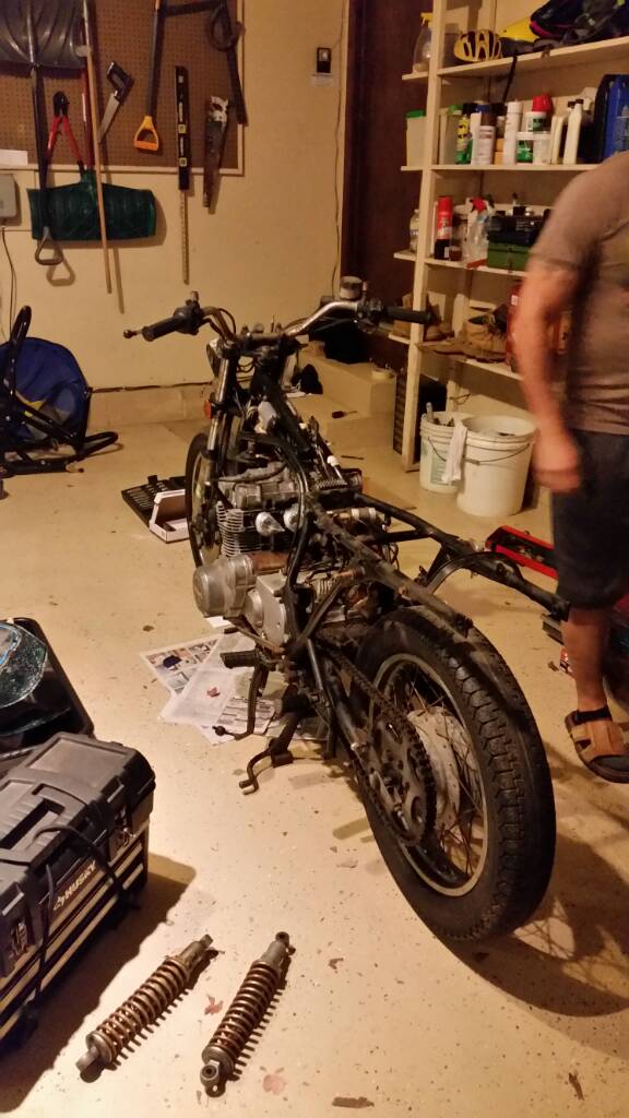

Well, as if I didn't have enough on my plate with the ranger, I've been helping a friend build a cafe racer. No real update here, just some fill. ;)
Should be a fun lil bike once complete.
