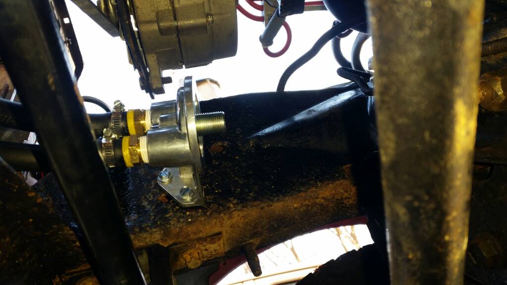

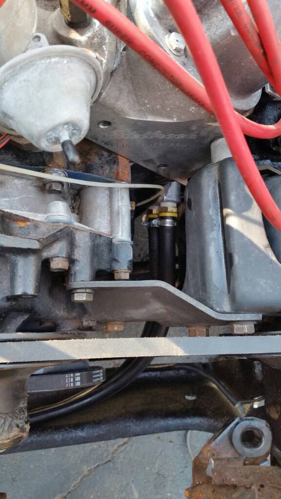

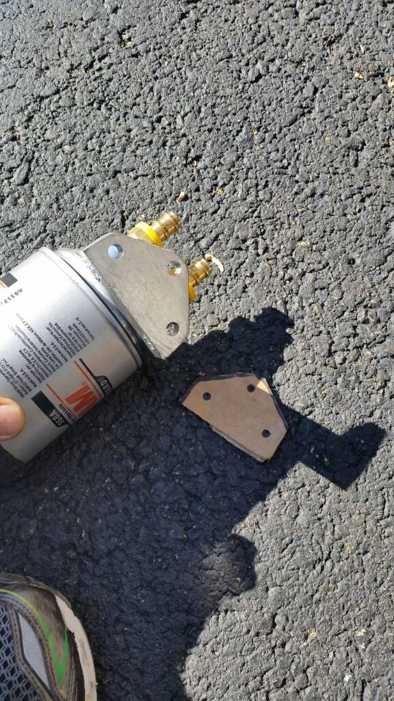

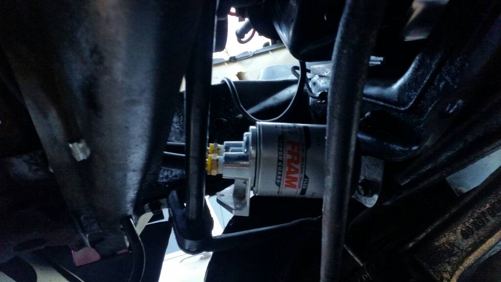

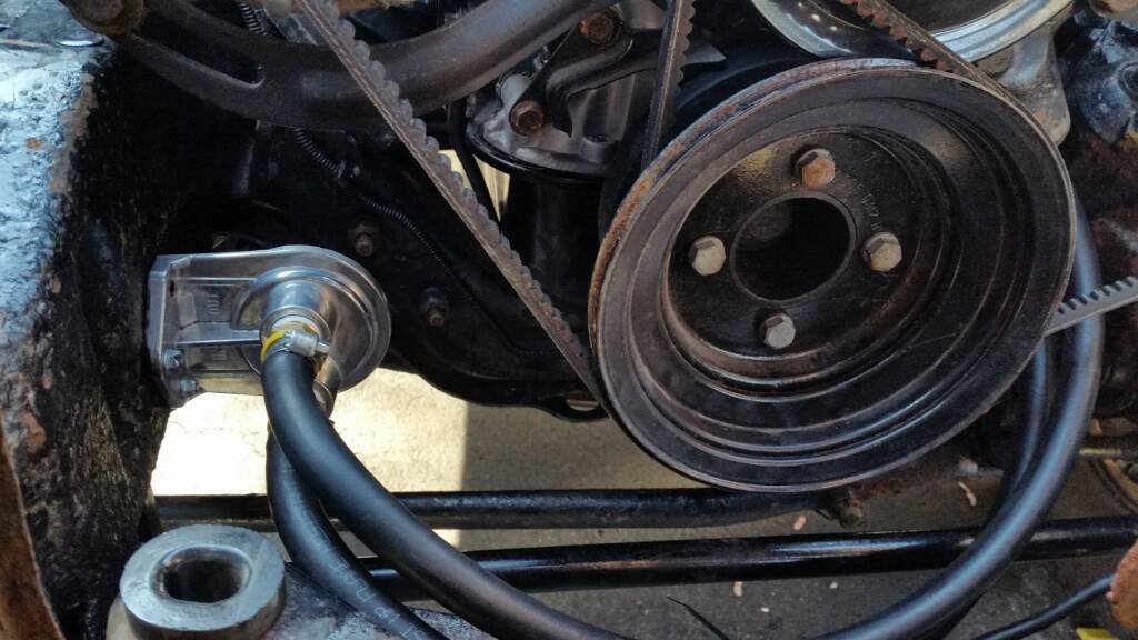

That let me see where I needed to run the oil relocation lines n mount. So I did.
I put it on the passenger side frame under the alternator. I had to make a template for the mount and lower the sway bar to get room to drill.
Here's how it looks :

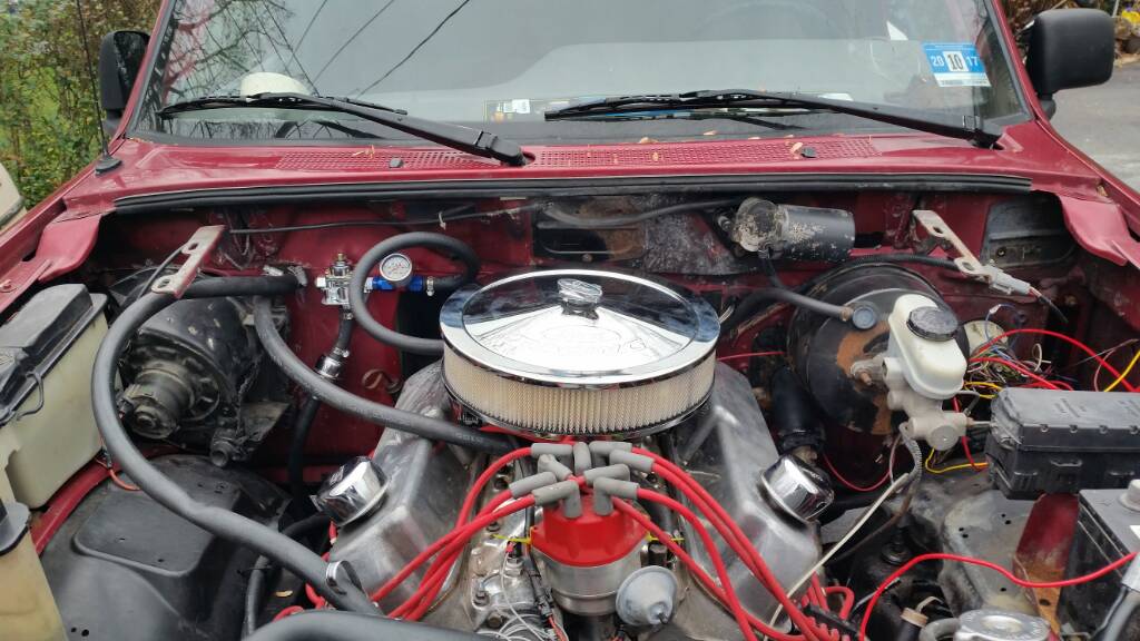

From there I moved fwd with wiring in the fuel pump. Pretty straight fwd here and the kit from summit, although alil pricey was a breeze.
I also got the fan all wired in. I just need to wire the thermostat in the manifold.

Man sorry I couldn't help out with my starter info . Maybe I missed something [emoji848] . Looking good . I like where you mounted your filter . I forgot your not running a expo fead setup . The pump gets raise up higher . And since no ac it leaves room over there . Maybe a swap for you down the road . Can't what to see your bay finish man , really [emoji106]? keep up the work and post your starter setup . What kinda starter you using ?

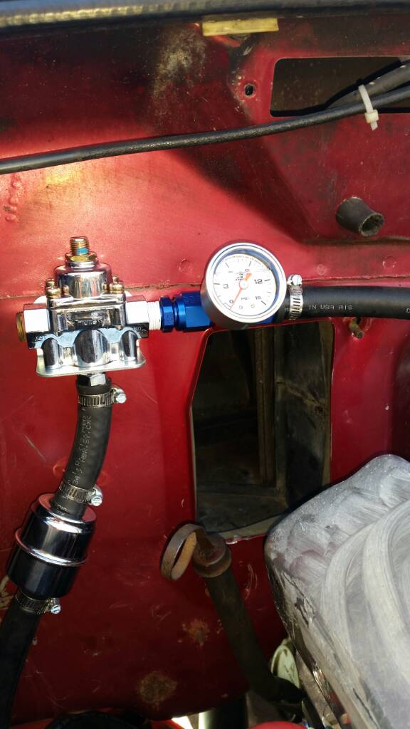

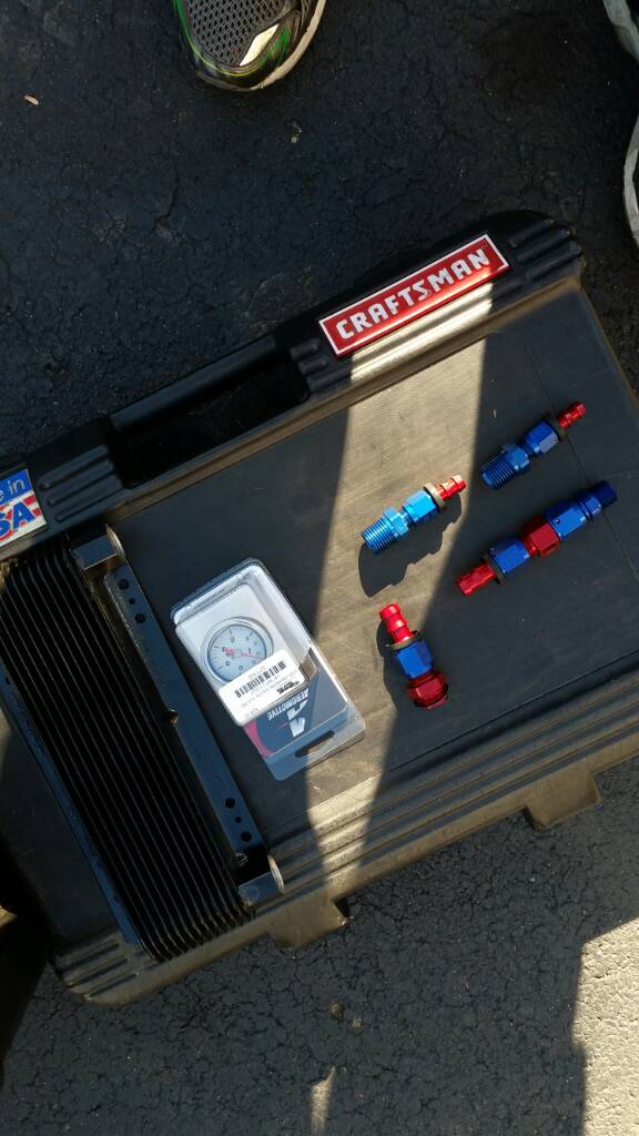

I picked up additional fittings that I needed to finish the fuel system. I needed a fuel pressure guage in there so I got that all set.

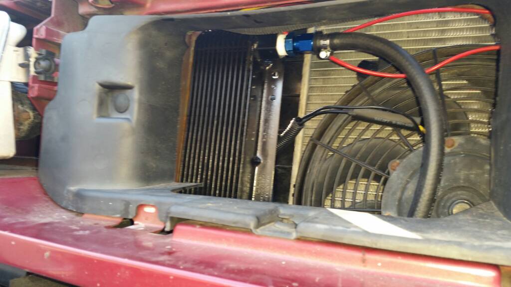

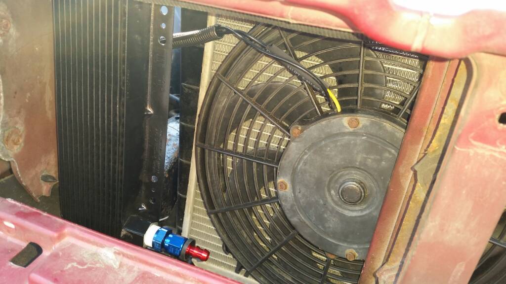

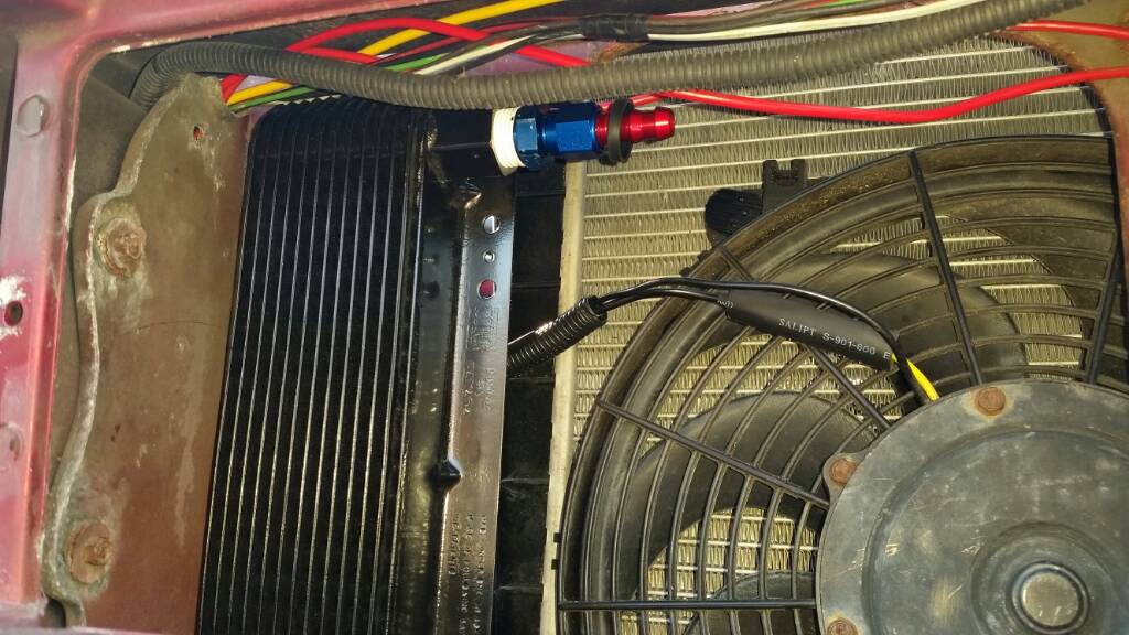

I picked up the trans cooler fittings also and got to mounting that. I snugged it down in front of the radiator and ran the lines away from the headers. All set to go on that aspect. Just need to fill it with fluid.

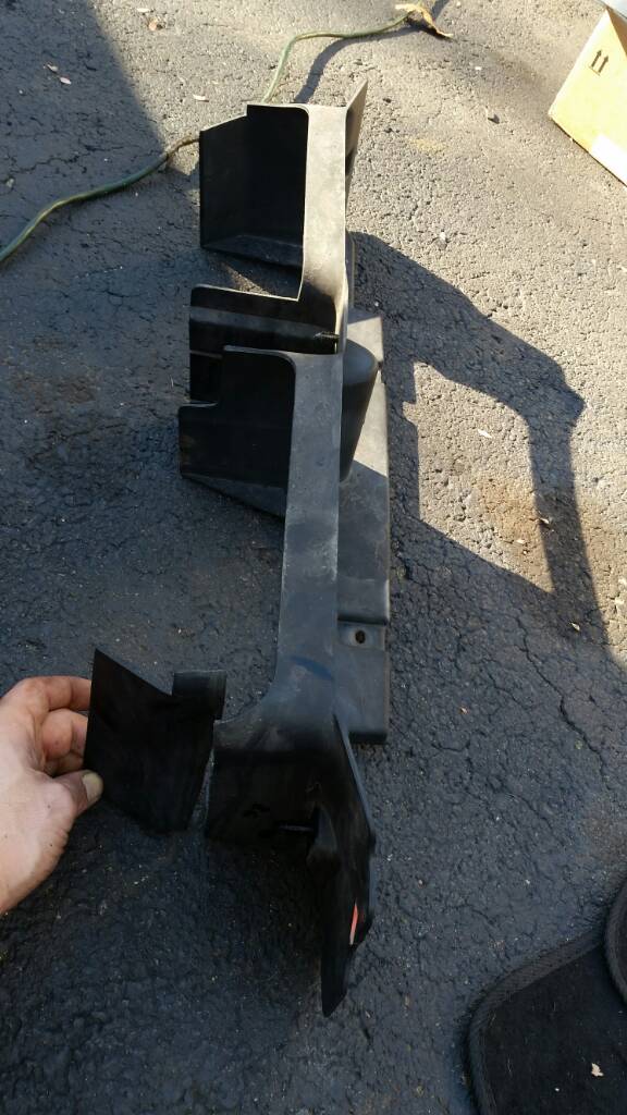

I trimmed the plastic pc that goes in front to clean ish up:
Back for fitting:

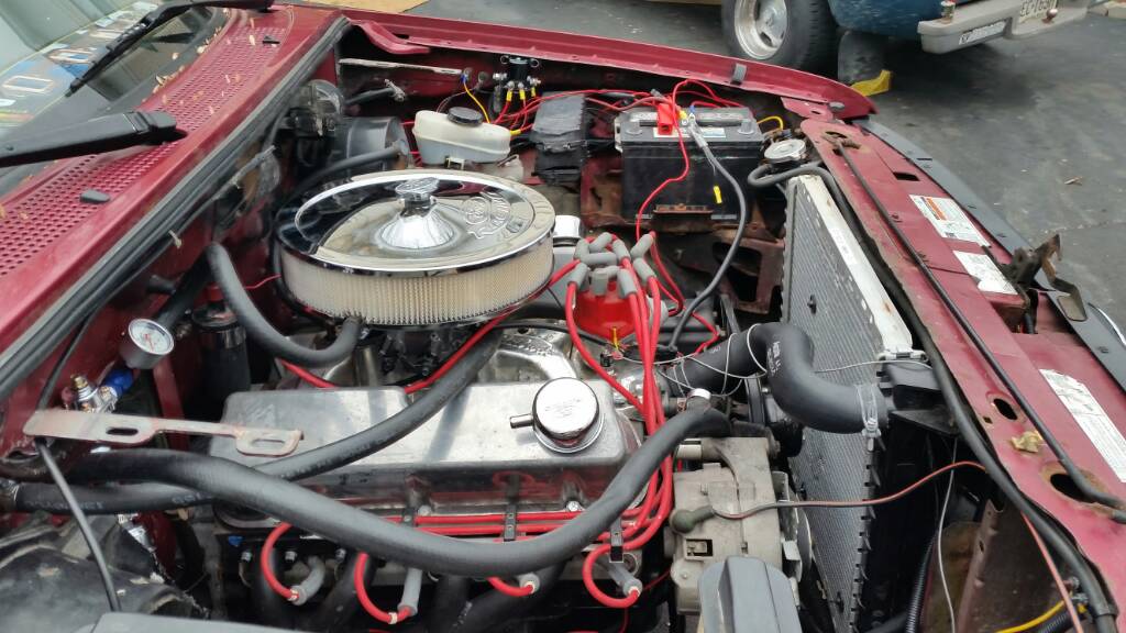

From there I finished wiring my starter and my aux panel. Should be all set now for cranking over. All thick gauge wire.
Still a few things to wrap up but I'm pretty happy with this weekends results.

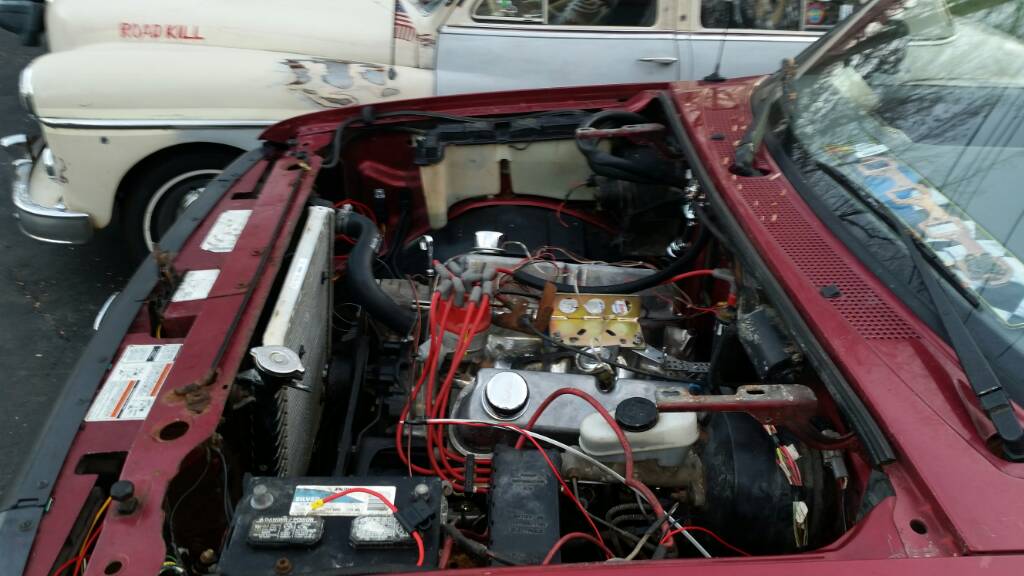

Man coming along . Be cool to hear it run by thanksgiving . I see you started to mod the blower motor box .

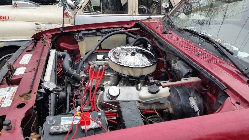

Today was a good day...got the lil b running!!!! Woohoo! So I went and rewired my original coil to 12v, got plenty of juice now. Had to adjust some settings and vacume but got it sorted n heard it run for the first time. Uploading a vid now so maybe I can toss it in here for your viewing pleasure.
