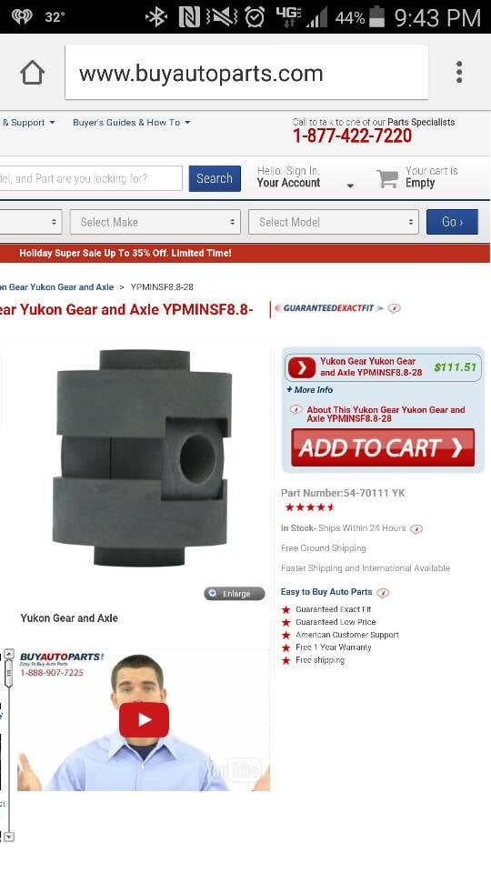

Thoughts on a min spool for the rear end? Found this and for the price, I think I may pick it up.
So, I know I'd like the expo rear end, got steeper gear, stronger axles and disk brakes.
With that, I got to thinking....and it may be premature but, going to a steeper gear, I'm not sure will help my set up. As is now, it wants to toast tires and I don't want it screaming in high rpms on the highway. I need to confirm my ratio when I look at my axle code on the door.
Not sure what's in there but if it's 3.08s, I think it's getting spooled, if it's 3.73s, I'll probably wait for expo rear.

It's most likely 3.08 like my stock open 8.8 . Went to 3.73 in that diff and one wheel spinning all the time . That was before the 5.0 and expo diff which is the 3.73 disk diff . Like I said if you wanna buy those 3.18's I got them .
Spools are cool but will eat up tires on the turns .

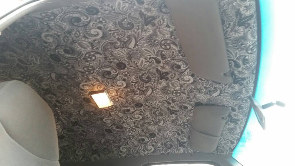

Got my headliner in and panels all buttoned down.
Not to shabby and def better than it was.

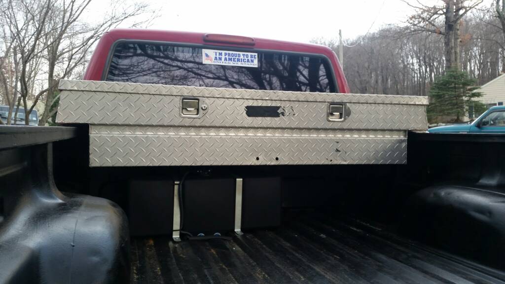

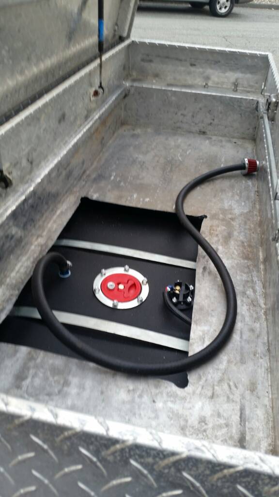

I then got to cutting the hole in my tool box for fuel filling.

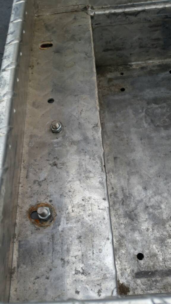

Easy nuff task. I then got some nuts n bolts and made studs to sit in down on so I could add 1/2 of rubber for added clearance over the cell:

Let me know what yas think of the headliner n tool box.
That headliner came out bad ass man . Truck Looks really clean man . Come along ways so far
I use this in my 8.8 with 4:10, all Ranger 4.0 4X4s have 8.8 with 4:10 factory, I cut mine out of a rolled Ranger 4X4, bolted right in
http://www.amazon.com/Ford-M4204F318C-8-8-Traction-Lock/dp/B004VQB31E/?tag=959media-20
Gsp, thanks for the heads up. Definitely an option for that bridge when I cross it

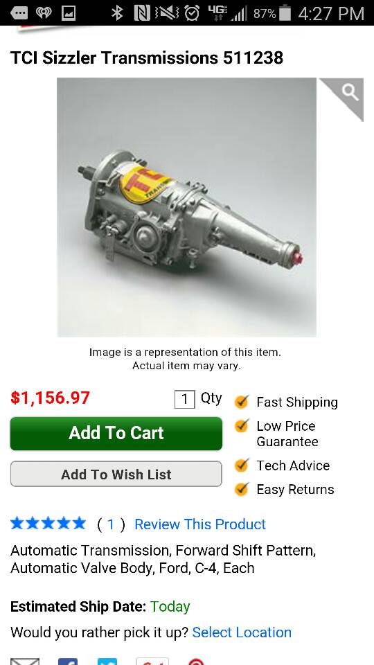

Today I called the trans shop I was going to deal with. Dude straight up tells me, just order one from summit, you'll be ahead in the long run. Oooookk. I was alil dumbfounded but since I've already loooked, said f it and that's what I'll do. Local guy doesn't want business!?!?! This is new to me in this day and age.
With that said, I'm dropping the trans this weekend....blows having to wait 5 days to work on it but that's how it goes I guess. From there I am going to go over everything I did, inspect everything again, re seal the pan, go over my lines and fittings and put it back in.
If it don't go well, I'll bite the bullet and go for this:

I figured since I am taking it down, I may call this other shop and see what it'll cost to go over it, out of the truck. If it's reasonable, I may opt for it. I'm going to go over everything I did, see if I missed something and go from there. It's likely that things may come to a screeching halt once snow falls so I am going to try n get this shit done this coming weekend. If I can't get it, f it..ill order one up.
It's at this time that I honestly thought about swapping to an aod like Bobby Walter suggested. However, I got all the parts n ish for this 347/c4 combo...so I'm sticking with it.
Any other c4 suggestions, would be good. I am looking at peformance automatic c4's as well. The tci was just a quick search and came up as most economical.
