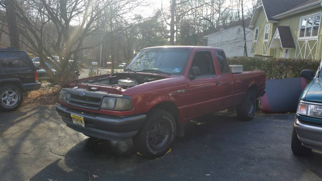

On a quick update, trucks down on all fours..first time in 2 months :)
Got the maiden voyage in and there is an issue with the trans...it moves but not the way it's supposed to. I'm reading, maybe the tq c is not seated...in which case I may have just blown that tq c. Well see. I added more fluid and will check later. If not to the shop it goes.
Hopefully it's noting major.
Other than that, engine is running well. Leaks are all good mins trans pan. Still gotta do gauges and exhaust but we are about there.
Anyways have a great day.
Ono
Off thr jack stands :)

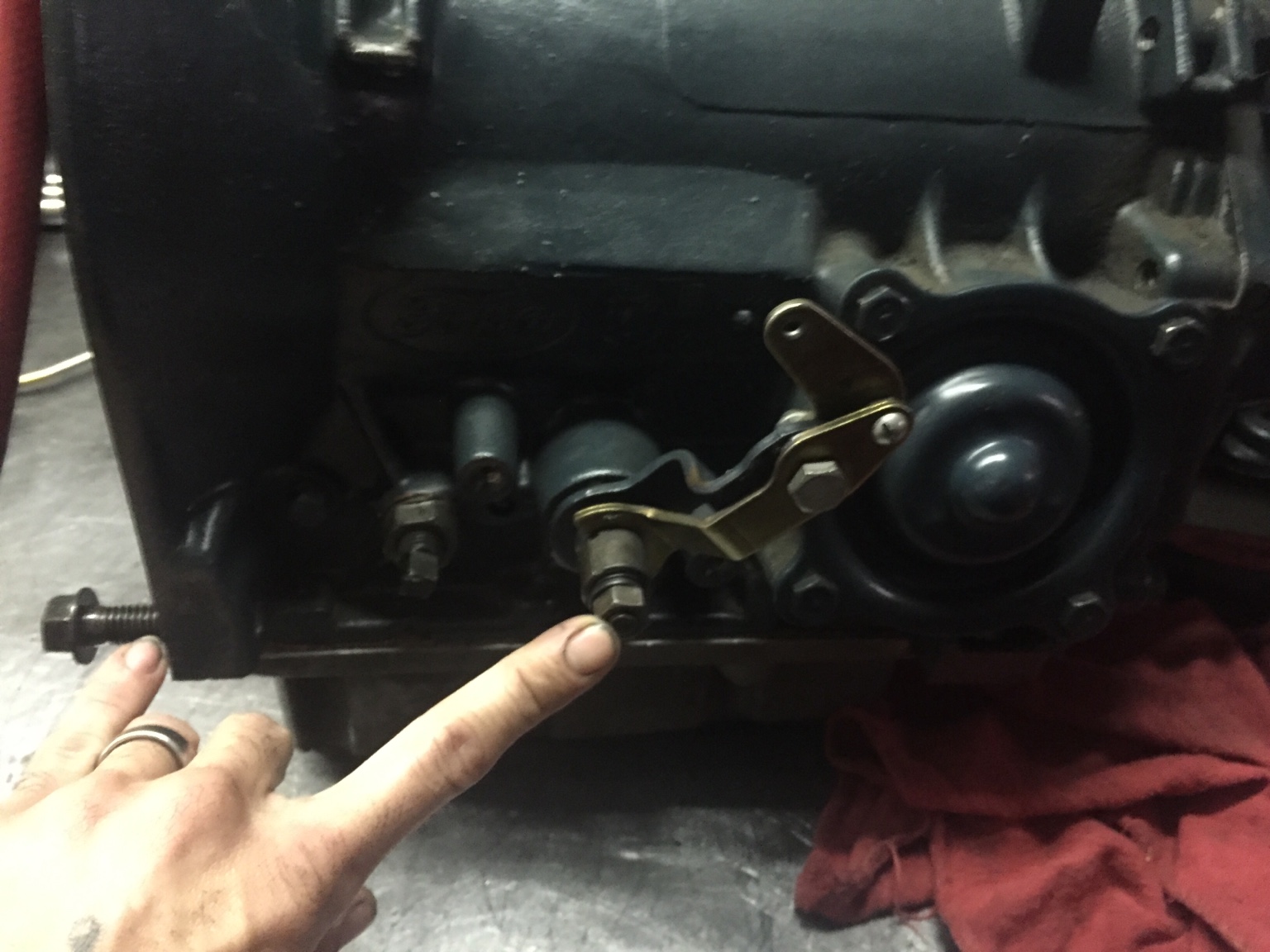

Don't really ever fill the converter here a work . Usually I'll but 5 to 6 quarts and start it . Then add another 4-6 depending on trans ( more for diesels of course ) . Always read the lowest line of fluid on the dipstick . Look on both sides of the stick . If the pump was missed up it be poring fluid the bellhousing and wouldn't move . Check the fluid and I'm sure the linkage for the kick down on a c4 in were the shifter linkage is also . It's the linkage inside the shifter linkage with a knob sticking out .
Here's one here at the shop I'll get a pic and see what up brotha .

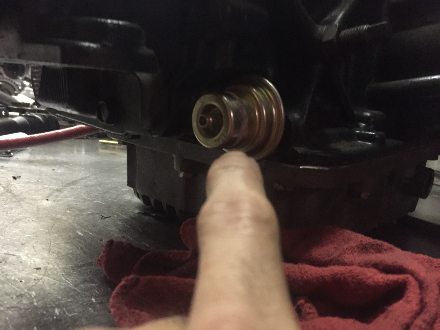

Where this nut is a linkage goes here . And do you have vaccum at this modulator

Didn't get much time today to work on it but I was able to run vacume off the intake to the trans. Pretty sure we are about there trans wise. Fuild level is good now when warm.
