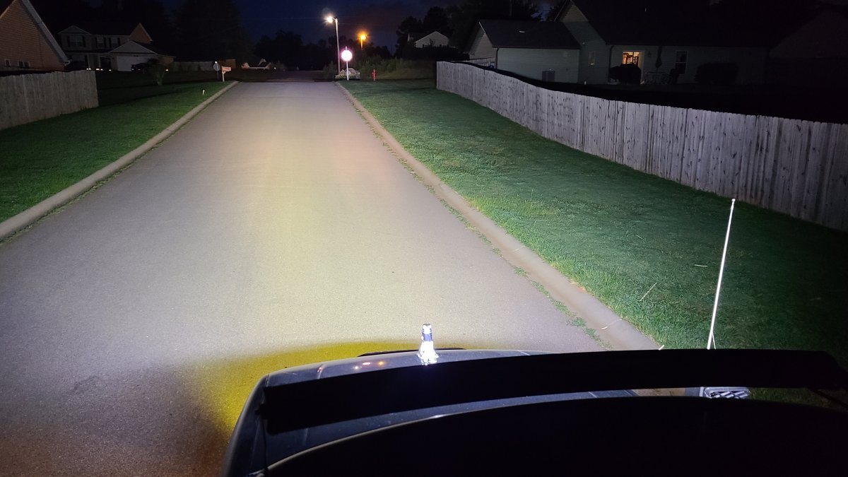

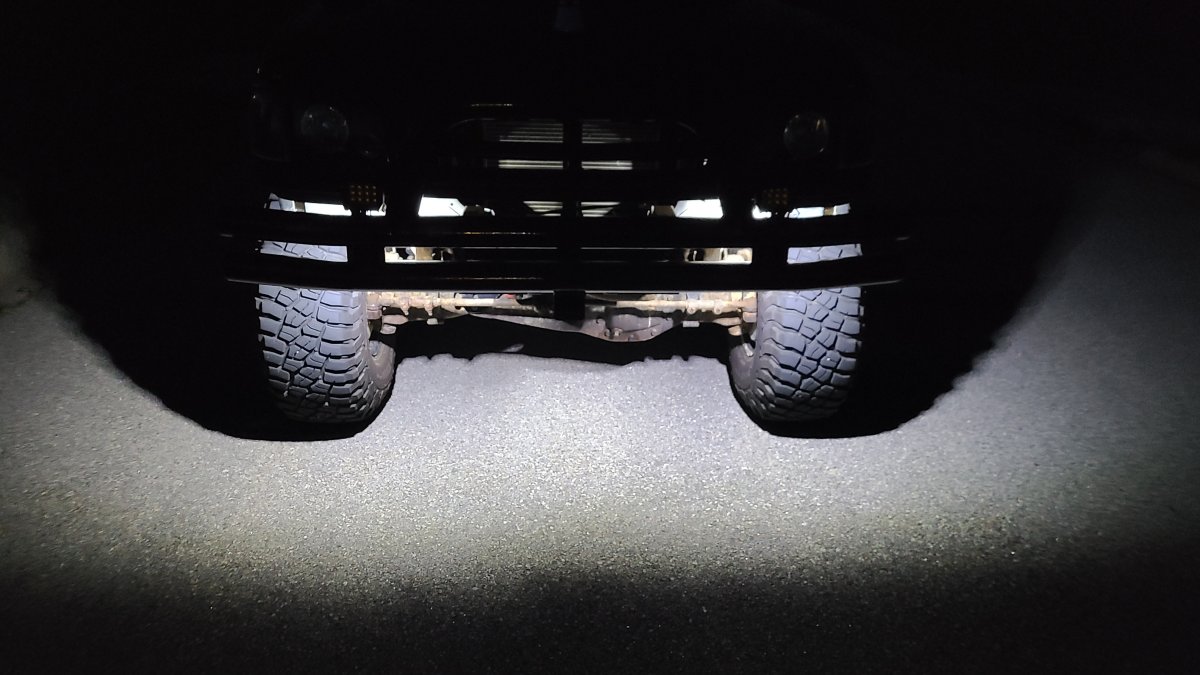

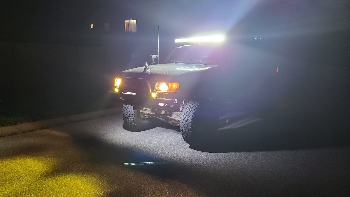

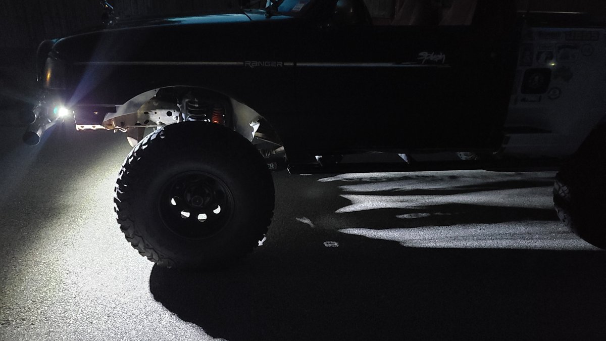

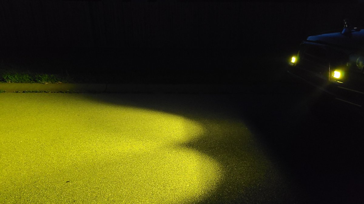

The other rock lights will get added to the same rock light circuit once I get them. Most of the work is done now. The power supply, relay and switch wiring are done except for drilling a hole to mount the switch. The rest is easy - make brackets, mount lights, tie in to existing circuit."Hey Bud, gotta light?"
Looking good. I like how you're "zoning" the lighting.
