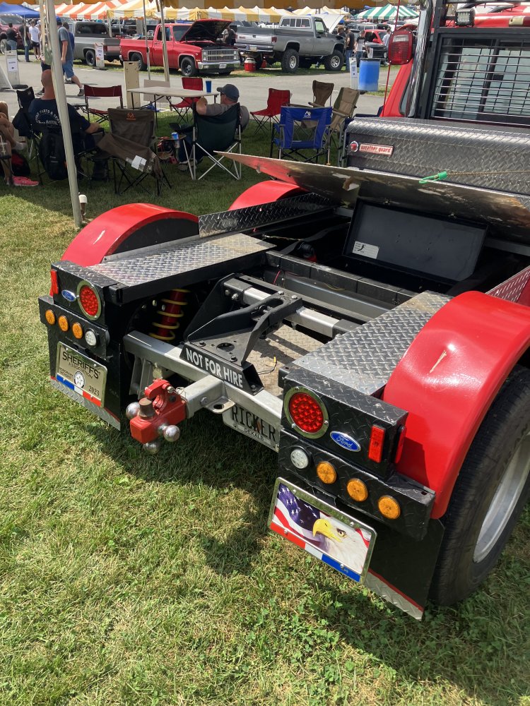

@Danny74 , you are dead on track. BTW, welcome to The Ranger Ststion (TRS). I don’t know if you realize that you’re responding to a three year old posting. I already built this thing. Search the site for 1997 ranger semi or something like that and you’ll find it.
Disclaimer: I are a real engineer, certified gray hair, dementia, low hanging below the shorts line, etc. but seriously, I did this for my own fun, and I do not recommend anybody copy what I did, I don’t know the safety or veracity or durability of this design. The primary purpose for me was doing it with a zero budget for the purpose of cruise in and shows. While I personally am not concerned with the safety and utility of this vehicle, I cannot speak to the safety or veracity in any use, and certainly not with heavy duty use. My direct instructions are not to copy my “design/delirium,” and to use proven products and technology if you need to do the same thing for any purpose. Having said that…
The set up I mimicked is very common in China and Asia (I’ve spent a bunch of time there). With all modesty, I have the budget, but a lot of this was a wet dream when I was severely injured and then developed a blood disorder. It was part of my therapy to get back to real life. I had the basic design in my head, but the entire thing was put together with bits and scraps and Craigslist and garage sales.

These pictures are from the Carlisle Truck Nationals last month, The Ranger Station made a pretty good showing up there, it was the 40th anniversary of the Ranger.
I’ve had the truck put together for about a year, but the majority of the trailer was built in the 30 days before I headed out (greatly/grossly modified pop up camper frame). Before it was complete, I did a test drive around the neighborhood, and then I put it together, and did 2100 miles in five or six days. Knock on wood, it ran and pulled like a dream.

The part you may like, is, I don’t think I have 3 or 4 thousand dollars in the entire thing (complete truck and trailer). People were selling all kinds of stuff for a little money during the Covid craziness, and I’ve always been a good horse trader
Having said all that, check out my build stream posting. I’ve made a few changes since then, and I’m in the process of even more now.
