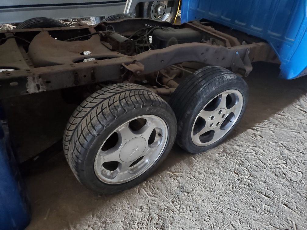

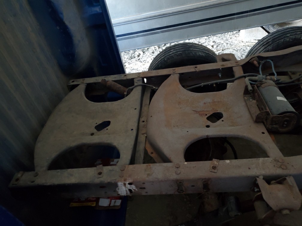

I didn't get much time to work on my tandem this past weekend, but you will note the frame extension.

@Dirtman: The welds are deliberately fuzzy/ground in the picture to avoid your critique of my work. ;)
I don't critique welds without being paid first. 😘
Those dually kits are shit.
RV companies imported those Toyota chassis-cabs, put motor home bodies on them and just added that dually kit and called it good. The axles started breaking. Toyota started replacing all of those axles with a proper full-floating dually, at a loss, just to save their reputation.
If it doesn't serve a purpose, it isn't cool. Having a truck with a weird extra thing isn't cool. Unless it's a badass weird extra thing. Narrow a Dana 70, which is a 7,500# axle. That's a baddass weird thing. The shitty tag axle doesn't do it.
