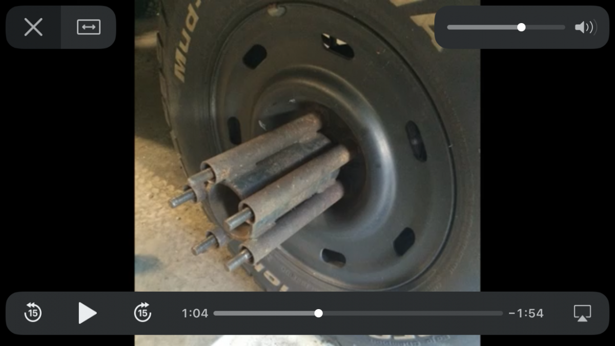

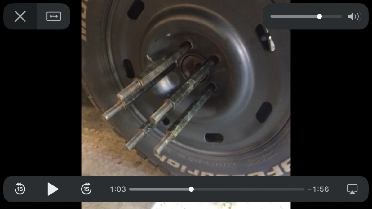

Hi. I’m playing with a couple vintage rangers doing a “Rick-storation” or maybe “wRicking” them...
Does anyone know where I can get the wheel adapters or conversion kit to change my single rear wheels into a dually set up? See pics. Alternatives?
Right now it’s a 1993 2WD short/short 2.3/4, 5-speed.
All info, skepticism and criticism always welcome....

I haven't seen a kit for Rangers in years. If you can find a Ranger based RV camper in a junk yard or listed on ebay or something, that might be your best bet. The last place I saw them being sold was either JC Whitney or LMC truck but neither list them for sale anymore.

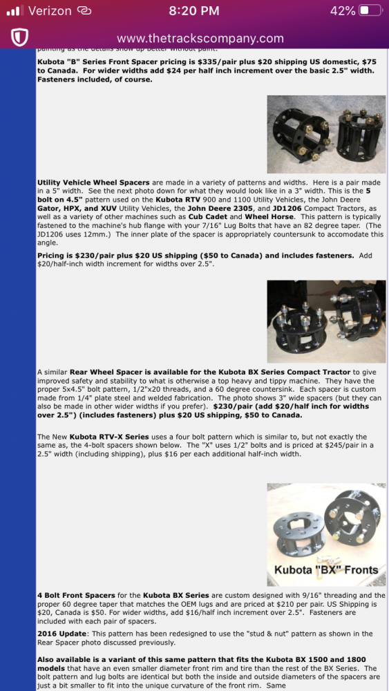

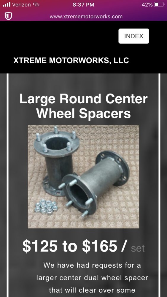

I saw this while looking for spacers to run JD wheels on my wheel horse, could work as dually adaptors, not sure how safe they would be, they are meant for garden tractors and compacts such as kubota. not cheap, but interesting. I ended up using 1-1/2” jeep spacers on the wheel horse.
1993 dually conversion kit

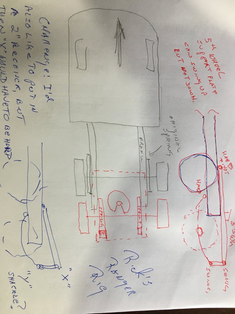

Questions. when you extended your frame to mount the second axle: are you using an equalizer on the springs to balance the load across both axles? Will the rear axle be powered or idler?

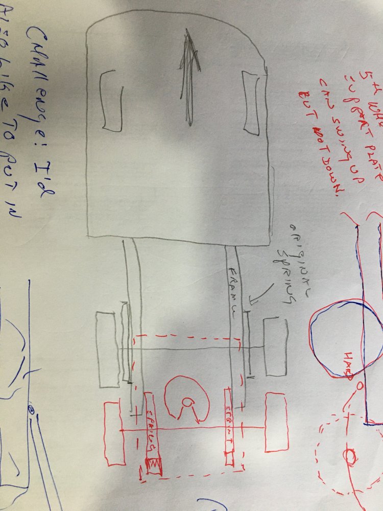

I’ll draw a “blue print” of my initial thoughts for a hinged frame over the second axle. If you backed the back axle over a curb, it would roll/swing upward so the drive axle never looses traction. With the ball/receiver centered on that plate between the front and back axles, you would always have half the weight on the back axle, even if it pivots it up. This wouldn’t be a completely loose hinge point. It would be set up so that it will pivot up above the truck frame, but if the drive wheels went over a curb, the plate would lay on top of the truck frame and not swing downward. With the ball/receiver centered on that plate between the front and back axles, you would always have half the weight on the back axle, even if it pivoted up. I’m not sure I have all the bugs out yet but I’ll do a sketch
OK, everybody be kind, I spent several MINUTES putting this drawing together!
Pivot plate would probably actually be a 2 x 2 by quarter inch angle iron frame, with front to back and side to side crossmembers to support the fifth wheel set up in the center. It would be centered between the front and back axles. Guess what, I just happen to have some of this 2 x 2 angle…
The pivot points on that plate and on the plate on the back would be made out of half-inch pipe with a half inch rod running through it, like a giant door hinge. I cut the half-inch pipe in four or 6 inch sections, and weld every other one to the frame and weld the other ones to the plate. I’ll weld a similar 2 inch angle or a piece of channel or whatever across the frame so that they would be attachment points to whole width.
In the main drawing the back plate would be attached to the top pivot plate the same way. That back plate would act as the shackle at the rear end of the spring.
The idler axle spring would be mounted in the frame of the truck on the front end, in such a way that the axle and tire height would be correct when the plate on top is actually laying on top of the frame. The plate will not fit between the frame, it’ll sit on top. it will lift up above the frame like a box cover that can’t be pushed into the box. I’ll space and gauge it so that that pivot plate actually lays on top of a tire tread cut the width of the frame so it doesn’t bang when you go up and down the road.
Having said that all, I’d also like to put a 2 inch receiver tube into that back plate. To do that I would have to make the top plate/back plate pivot joint a solid weld instead of a pivoting point. That means I would have to mount shackles between it and the floating spring.
Unless somebody has a great idea and a pencil is good as mine, this will probably be a last minute decision as I field fit Everything. I can’t keep spending all my time coming up with these fancy blueprints. Also, if I field fit, I usually have some Guinness helping me, and it plays into one of my philosophies that “any job worth doing is worth doing twice!”
All comments and criticism welcome welcome. You’d have to ask one of the administrators how to record your laughter and then post into the site if that’s your reaction.....
