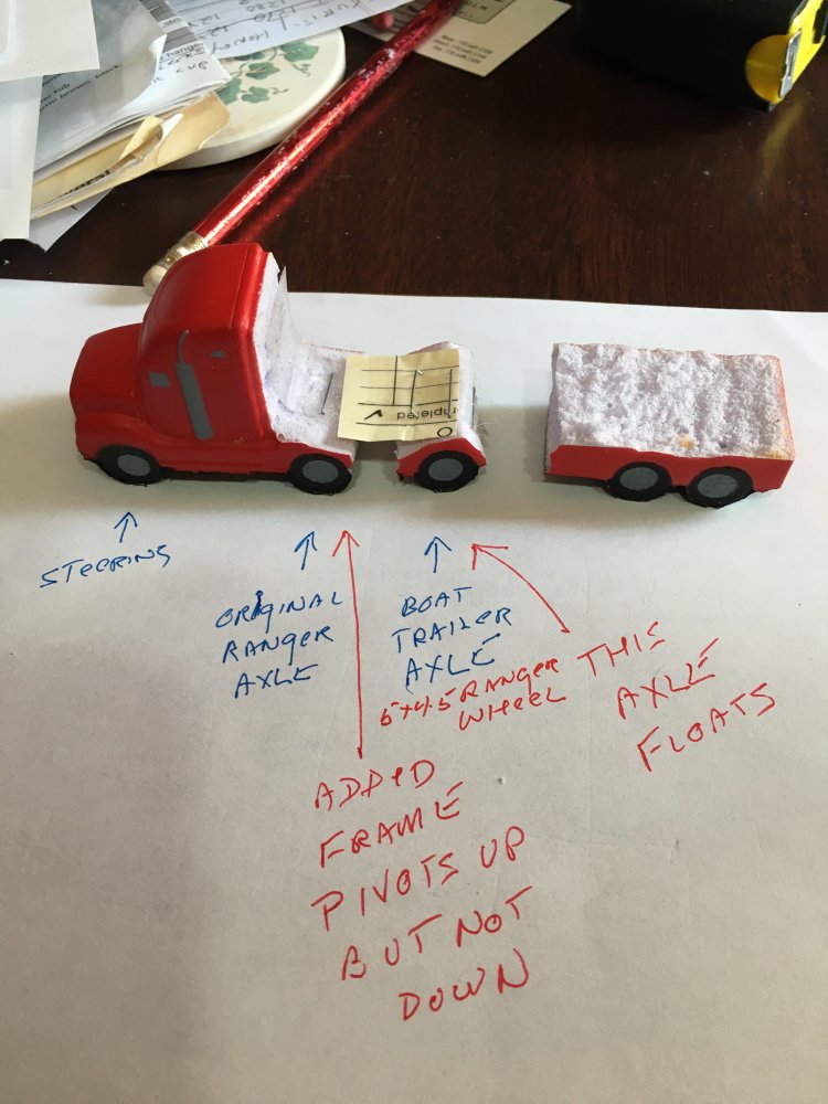

This gives a real quick glance of what I’m talking about. The added frame for the second axle, actually that frame piece would hinge up, but would not hinge down. That way the drive axle is always planted on the ground and could not be lifted up by lifting up the floater axle. The frame pivot point would be the front of my little piece of cardboard. When I do it for real, I’ll probably use some steel, not cardboard.

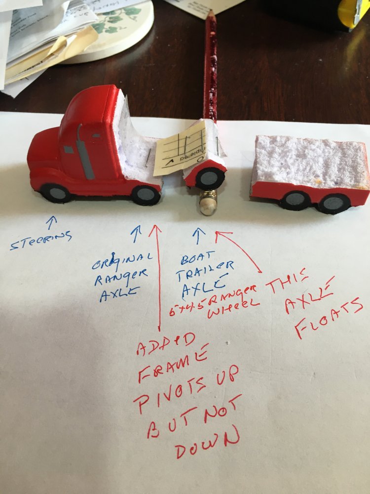

The pivot point for the back part of the frame would be centered on top of the original ranger axle. In the picture, the pencil underneath the back axle indicates what would happen if you rolled up on the curb or such.
The hitch point would be in the center of the two axles, so when a trailer was loading it, it would put equal weight on both axles. When stopping it would put more weight on the front drive axle (only truck axle with brakes) by just a little bit. And the trailer will definitely have brakes, I’m not that incredibly cheap!
I know I’m nuts, and my gal and all my friends know I’m nuts. I’m asking you ranger guys to tell me WHY I’m nuts on this.

What happens when you drive over a speed bump or something with the trailer on, and the back axle comes up?
I assume there is not going to be a bed, and the hitch plate for your "5th wheel" will be mounted onto the frame.
Maybe I'm not clear enough on how the hitch will mount, but it seems like it would interfere with the hinged frame if it is centered over the two axles.
I’ll try to answer the second questions first. The “Hitch plate“ and the pivoting rear frame are one and the same item. If you look at it from the side, the front end of the plate hinges on the Ranger frame. The point of connection for the hitch would be centered between the two axles.
At the rear of the floating frame, there would be a flat vertical piece, kind of where the license plate would go. I have two concepts on this. First, the top of this vertical piece would hinge on the top the same way that the hitch plate and frame hinge on the Ranger frame. The trailer axle springs would bolt to the bottom of this vertical piece, so the vertical piece would be the “shackle“ for the rear axle. Then I would positioned the front of the axle connection point vertically so that the trailing wheel lines up with the ranger wheel. The height of the rear plate would be adjusted so there’s only a little bit of load on the rear trailer axle when there is no Trailer load.
There are maximum limits to my budget, there is a balance between distributing the load across both axles when you go over a speed bump versus keeping the drive axle, which would also be the brake axle, on the ground firmly at all times.
understand I’m doing this like I would build a plastic model as a kid, it is not being designed for any serious work. I imagine the only thing that would ever be on the trailer would be one of my other collector cars, and I wouldn’t be speeding or hotdogging with that, or it would be a bunch of high school cheerleaders in the Fourth of July parade or sexy Santas helpers in the light up Christmas parade at 7mpg (my actual preference).
Your point about lifting the rear axle going over a speed bump is valid, but I would go slowly in that case, I’m not planning on any hotdogging at 80 miles an hour on any side streets or Walmart parking lots. The Ranger springs have much more flexibility than the trailer springs even though they are rated for the same weight. The trailer springs are designed for load, the Ranger springs are designed for load and comfort. Hence the Ranger spring should give enough without doing any damage as long as I rode over whatever obstacle with care.
My other vision (sometimes called confusion) is to put a receiver tube in the middle of the vertical license plate back plate. If I do that, that backplate would have to be hard welded to the pivoting frame piece, hitch plate. Since shackles would still be needed, I envision on the bottom of that back plate I would extend a rod out, upside down and similar to the way the Ranger springs are on The frame now, and I would put in a shackle vertically upward on the outside of the rear license plate plate. Again, I adjust all the dimensions so that the wheels end up aligned.
And the third of my two options is to simply let the hitch plate/frame extension pivot either up or down. Theoretically, if the trailer ball is centered front and back between the two axles, the load should be even on the two axles, without removing the drive axle from the ground. Mechanical engineering was part of my training as a chemical engineer and environmental engineer, and I’m actually having a couple of buddy professors down at Georgia Tech (who are also car nuts) look at this with me. In my education and experience, I would be much better at putting out the fire and cleaning up the spill then I would be at preventing it in the first place. Hence all of these design questions.
In any of the designs, I would also add some shock absorbers to keep the frame extension from flailing up and down and out of control we’re not loaded (even if I’m loaded).
As stated before, I’m much more concerned about keeping the drive and the brakes on the ground then I am about equalizing the load in every possible circumstance. My ingenious design covers probably 95% of the bases. My extraordinary driving ability will no doubt account for the rest.....
