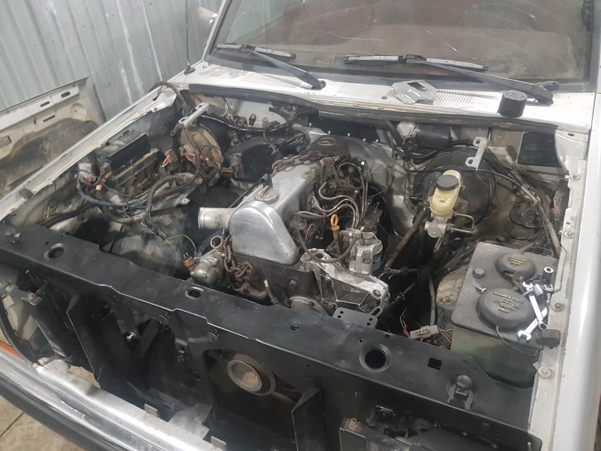

Power train is back in there
Took a hour and a half engine trans and t case I thought that was pretty good on the floor. Hope it stays in there now.
Have to make a spacer for the drive shaft.
I think if I remember right the a4ld is longer then the fm145 which might be why I have drive shaft issuse.

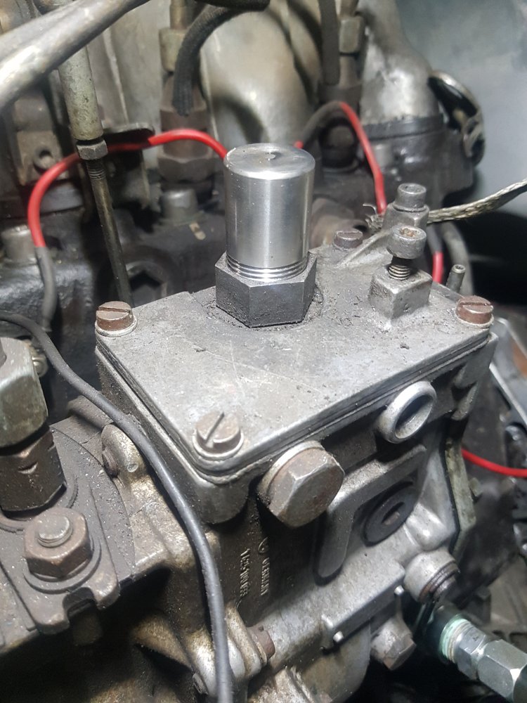

I spun up this cap to remove the boost aniroid off the injection pump.
I know it would make it more economical and no smoke but what can I say my wife says she thinks its cool I'll give her black smoke.

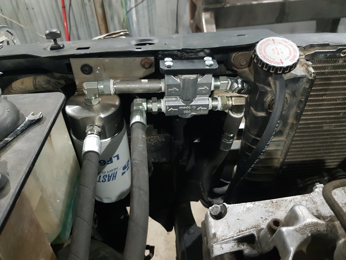

So I got the motor running but not from the factory fuel line. I fought with it for a few hours and it kept sucking air and I dont know where from. I instead just used a jerry can and ran it to the fuel pump hand primed it and bled more air and it seemed to do the trick. I think I'm just going to go right back to the tank with solid line. Add a low pressure lift pump and use the original fuel pump circuit and be done with it.

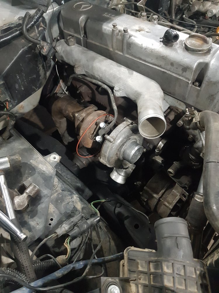

44291
44292

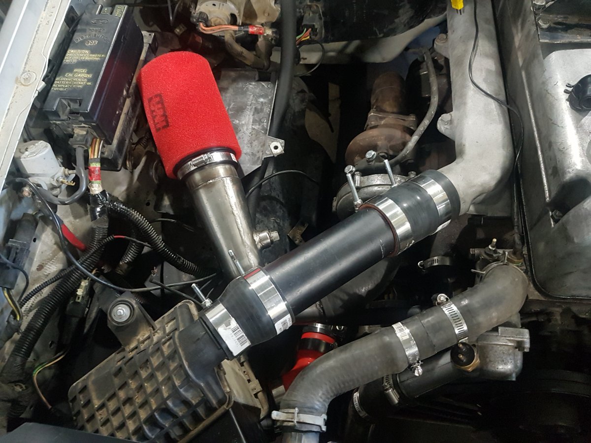

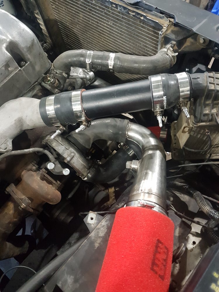

I may end up building a box around the filter and fresh air it from the front or atleast a shield to the motor side to keep the heat from it a bit time will tell
Interesting setup. I'll be interested in seeing how it works. Did you keep the filter in the factory box?
I never thought far enough ahead to think about just cutting the factory box to make that fit in there I'll see but I might just make an aluminum box later
