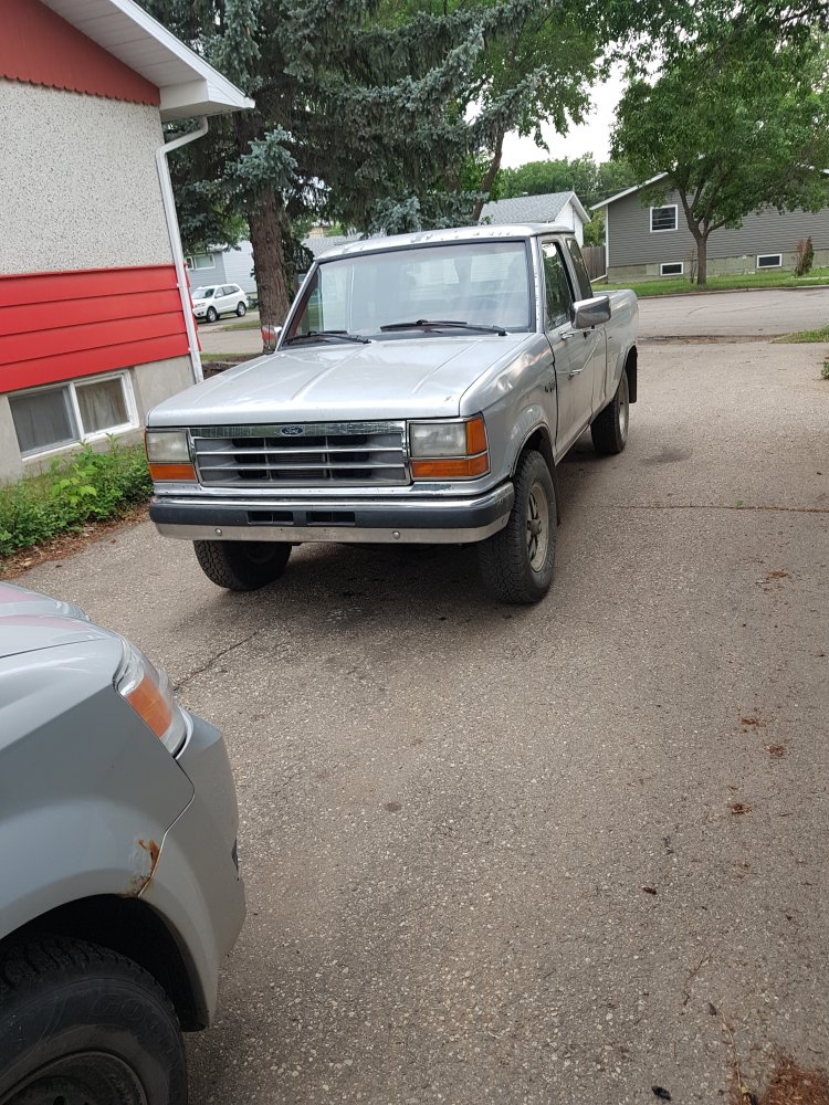

I drove it today.
One oil leak where it goes into the filter head oring may just need replacing.
Polyurethane was a terrible idea lol at idle she vibrates pretty intense but under load it's good.
I have alot of stuff to finish and will keep at it but mechanically I think I'm doing pretty good

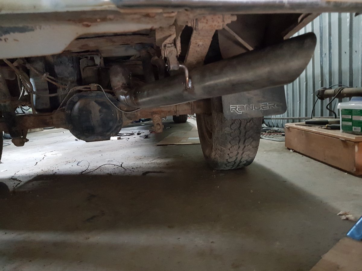

Not a great picture but I got an exhaust on it. It goes 2.5 from the down pipe to 3 inch after the flex it comes back over the axle and exits with about a 30inch 4inch with a slash cut. Should make the turbo really whistle nicely.

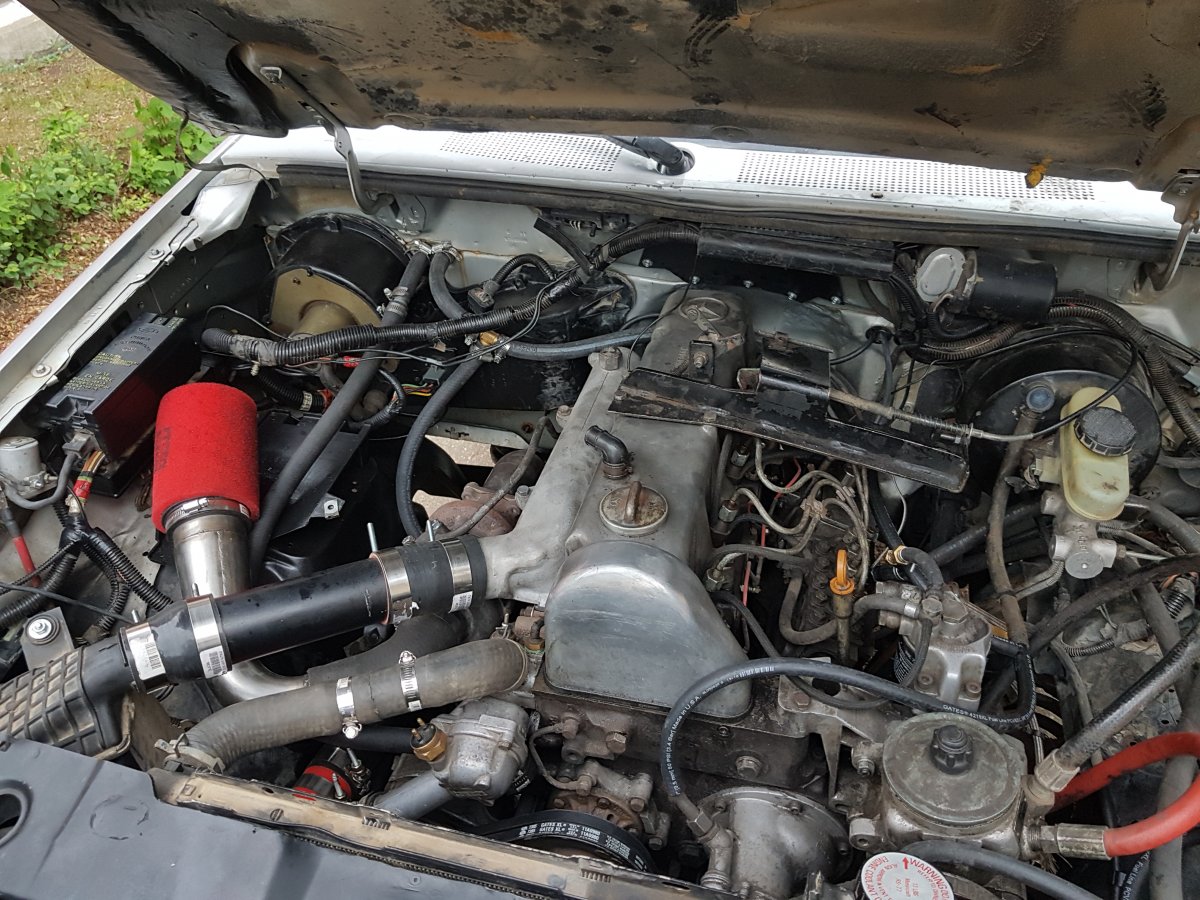

Let me sound dumb for a minute, but why does it look like you have 2 intakes? Factory looking box and then obviously filter off Turbo?
I need coffee.
The actual intake goes into the turbo directly. The filter box is sealed and patched into the loop from what I've seen in other posts. So, only one intake.
Your seeing the intercooler it looks like a air box well I guess it's a box that air goes thru so it's not wrong. But it goes from the foam filter to the turbo thru the turbo to the intercooler then into the motor intake
So your intercooler is in a box? I've never seen that done. I guess the pictures aren't giving us a clear idea of what's going on. Will you have adequate cold air flow for the intercooler to work?
It is a vw intercooler so it is plastic it just looks like box from that angle.
It gets air from the front thru it just the explorer grill I have blocks it a bit. When I get a ranger grill it will be right too it.
