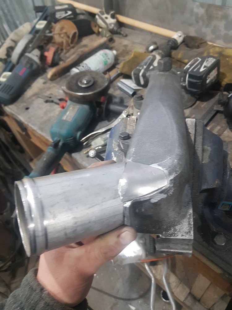

I have a bit of cleaning to do before I weld it but I think it will be do able. I may get it glued and file it then lightly bead blast it so it all looks like a casting

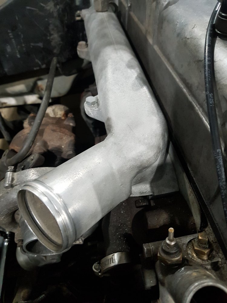

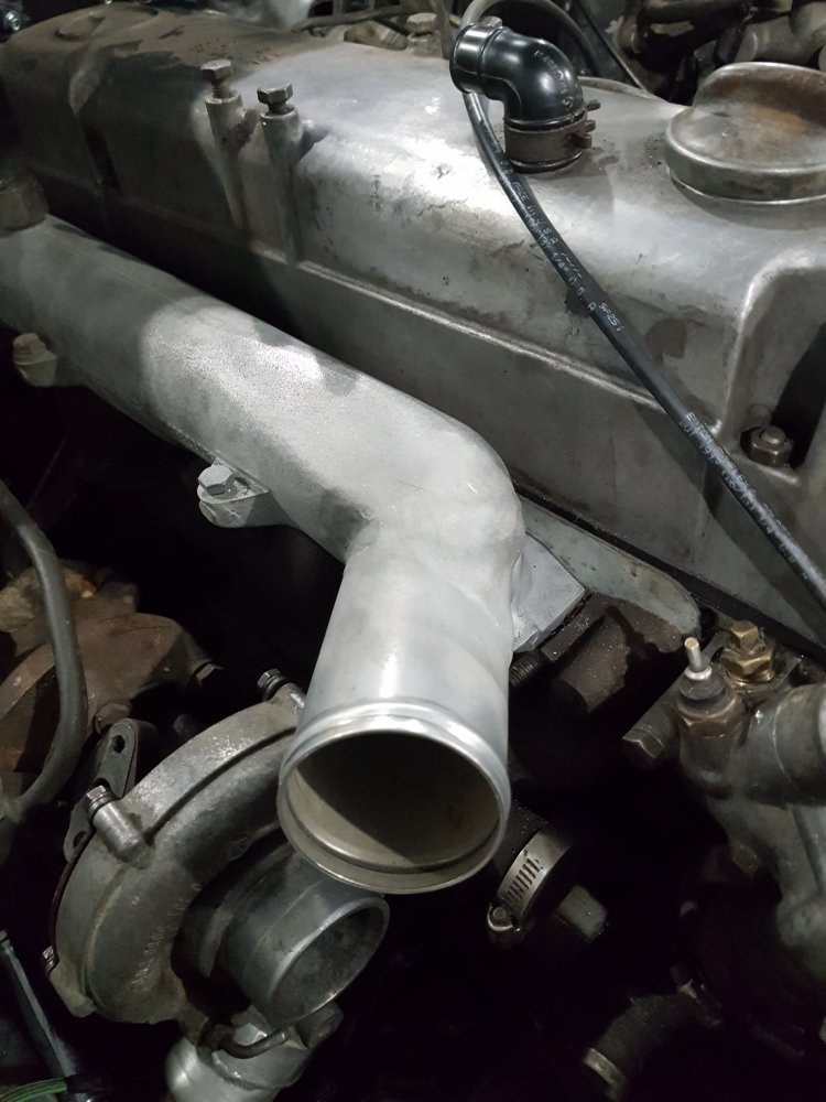

There she is.
I welded it up, it was a bit funny in a couple spots where the oil in the aluminum boiled up but a quick grind and It built up nicely just enough that I could blend it a little with a disc. After I used a scotch brite pad and blended it some more. I used a bead blaster to make it look like the rest of the intake. My hands were dirty from cleaning the aluminum to weld it so I rubbed my hands on it. Came out looking fairly factory.

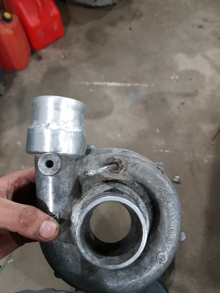

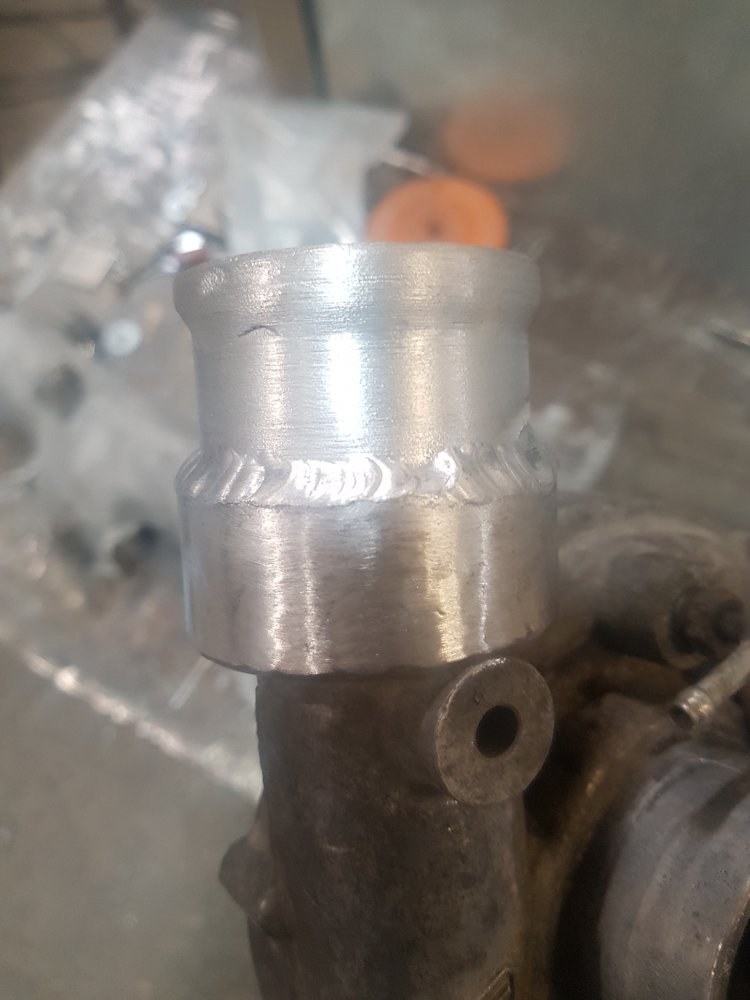

I made a little barb to slip into the compressor housing. While I was out tigging I did it too. More progress
42211
42212
It will work for the time being. If I do it all now I wont have any fun modifying it later

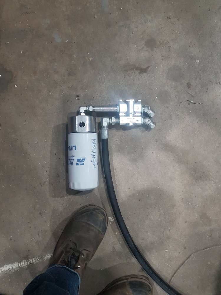

Filter and thermostat set up.
I have all the hoses made up for my system just need to make a bracket to hold the filter head and thermostat to the core support. When its mounted I can finish up the oil cooler mount.
I feel like I'm not far off now but I need to dry mount this stuff before I pull it all out for finalizing. The exhaust is getting put on hold I have a down pipe on the motor but am missing a section that is at my father's place 250kms away I'm too cheap to buy more stainless to finish it now so it can get done last.
View attachment 42211View attachment 42212

Intake came out awesome good job
