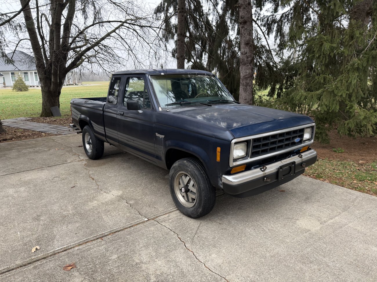

Bought this bad boy last month as a project truck. Runs/shifts great, but I had a few questions.
1. Does anyone know the part numbers for the OEM brush guard / roll bar? I've been having trouble hunting them down.
2. The speedometer works, but it looks like it is off-center behind the instrument panel. How difficult is it to pull the front panel off and reseat the speedometer?
