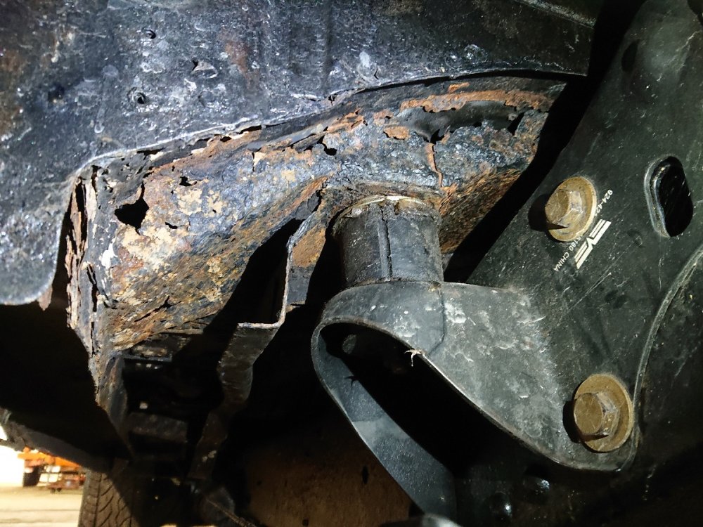

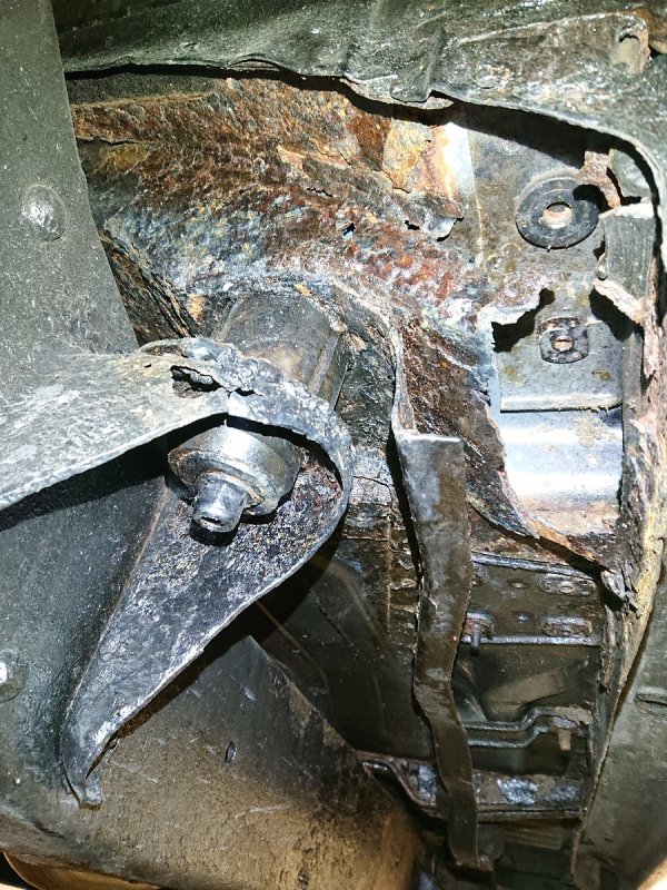

Look the frame over really really good too, especially behind brackets like the front spring mounts.

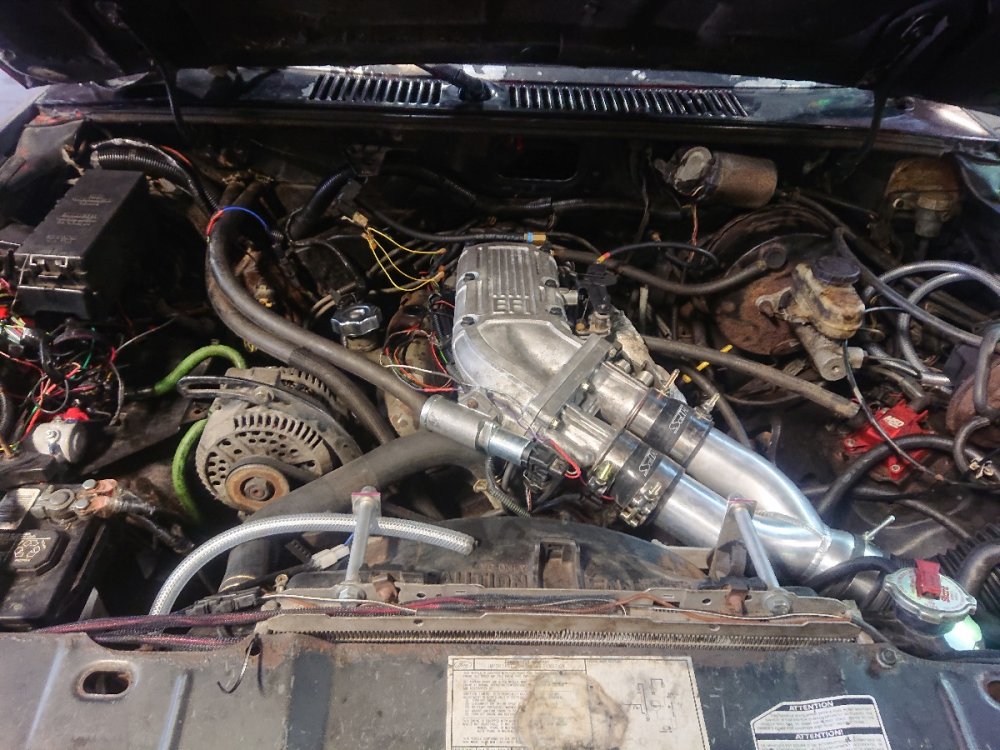

Two major modifications I have been waiting on completing are installed: The Volvo EPAS electric over hydraulic steering, and the Merkur/Sierra twin TB intake.
The Merkur intake made a difference according to the megasquirt. It took my volumetric efficiency from an average of 83% at WOT to around 93%. Throttle response and mid-range throttle position driving are greatly improved, as well as acceleration. The truck definitely has a LOT more 'bite' when you get into the pedal, and responds much more smoothly when out on the highway. Idle is a dream now. So much smoother. It was an easy conversion, and I'm not sure if it merits a tech article or not. Overall, this was VERY worth doing, and really improved the feel and output of my engine. I am still tuning fuel and spark to match the improvements made by this intake, and will update tables once I get it close enough.
A very special thank you to @kunar and Jeff Herston over at Merkur Parts Midwest. If you wind up looking to do the same conversion, Jeff's email is blugg@msn.com.
Total of the parts involved were:
Intake and throttle body
Scorpio Throttle bracket, linkage, and return spring
Scorpio Throttle cable (note: fitment on this isn't great; the cable is far too long. May have a custom one made out of the current one
Scorpio Cruise Control cable
3" to dual 2.5" splitter pipe (amazon)
Two 2.5" silicone intake couplers (amazon)
3" dryer-hose style eBay ram air/cold air intake.
Six 120mm bolts (ebay) Note: 110mm are needed, however my setup required 120mm due to phenolic intake spacers
I ported my intake. Was far easier to port than the stock ranger one.
2.9 intake gasket with extra Scorpio "tail" on it. If you ever wondered what the extra hole in your lower intake is for cylinders 1 and 4, now you know.
Scorpio TPS sensor
S745 wiring pigtail for the Scorpio sensor. They are very common on Volvo vehicles. Mine is the pigtail from a V70XC MAP sensor.
Various 1/4" NPT barbs, elbows, and T fittings.
Various 1/4" and 3/16" tubing
Your ranger IAC will work, but the pigtail side will face towards the core support. Don't make the mistake I did and hook it up in reverse.
Ok, fine, I'll write a tech section article...
I'm still considering picking up a Scorpio lower intake. The design of it is very different than the Ranger's, but it fits. I'm hesitant to do so because i have at least 40+ hours into porting my Ranger lower. Hmmm...
I also noticed a trick from the Merkur guys where they block off their lower intake coolant ports on the XR4Ti models. Need to look at a spare set of 2.9 heads to see if this can be done. The guys that have done it report 30+ degree drops in intake manifold temperatures. Doesn't seem that significant, but I can definitely notice when my intake drops in temp. When my IAT sensor reports 70-80 degrees, the engine is a LOT peppier than when it is 130-140 (hot start condition, or sitting in traffic).
Oh, and unless you use the Merkur air box, you will have to figure out a re-route for your air cleaner. The setup I have did not clear the Ranger power steering pump.

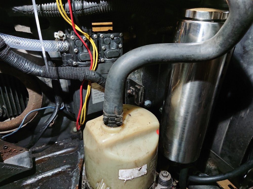

Volvo EPAS conversion is done.
I know I know, ive been really beating this one to death on the forum. But I seriously cannot stress enough how much this improves the handling on a first gen. It feels modern.
Had to have a custom PS hose made at a Hose Xpress shop. Was around $100 to have made up (OUTCH!!). Worth it though, since I paid $14 for the pump. This one is absolutely getting a tech section article.
It is NOT one of the electric steering mods that others have done, and requires no cutting or welding. Just drilling a few holes. I'm sure if you were a little more creative with space and not as worried about cramming a supercharger under your hood, you would be able to get away without having a hose made up. The stock Ranger hose has the correct ends on it to fit the Volvo pump.
Wiring is easy as hell. Make sure to get the pigtails (there are two) when you get your pump, and the bracket it hangs in. Big red and black cables to battery, and grey 16 gauge wire to ignition on/off. When the key is put to 'run,' the pump will kick on after 3-4 seconds, and back off a few seconds after the truck is shut off. I'll run through the wiring, etc in a tech article.
Coolest thing to me is that there is no strain at all on the engine when turning from lock to lock, and that my power steering works when the engine is not running. The only thing I don't like is the system is not as responsive as I'd like it to be when making tight parking lot maneuvers. I think this is because I am used to loose steering. You just have to turn the wheel slower, or it becomes too stiff to turn. I'm going to dump some friction modifier into the reservoir to see if this helps. Otherwise, I'll have to figure out the commands for the assist level wiring.
It handles better on the highway now, though. No more getting blown around by wind and trucks. Potholes and divots don't jerk the wheel at all now, either.
Others have used these pumps for everything from dump beds to hydraulic jacks. Not sure of the GPM rating (I think its 2-4, but cant recall), but total available output is 1700 psi. There's a lot of cool stuff I've thought about doing with it. Open to suggestions as well.

Tossed a stupid ricer aluminum radiator overflow bottle in, and an aluminum washer fluid tank. Needed a different tank for methanol, and wanted to clear out more room for the blower. Goodbye, plastic crap tanks!
You surely know by now that you can't use an aluminum tank for methanol... You're also gonna want the largest tank you can fit in the truck, unless you really enjoy refilling a very hazardous fluid that burns invisibly..
Methanol = washer fluid.
Wait. Can you use aluminum for washer fluid?
