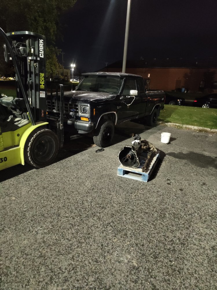

Yesterday finally had enough time and courage with my buddy to remove the tranny, it was fairly easy even tho the bolts on top where such bs to get to. Removed it pretty much whole and didn't have to remove the exaust yay.
Right now in the process of cleaning it and will check/ repair what's wrong with it.
As of now only have 1 broken bolt on the oil pan and threads on the bellhousing for the starter.
Also sandblasted and painted the 4H/4L/N/2wd gear selector bracket and shifter and also the transmission shifter, will do the crossmember and the transfer case skid plate later this week since it got pretty late.

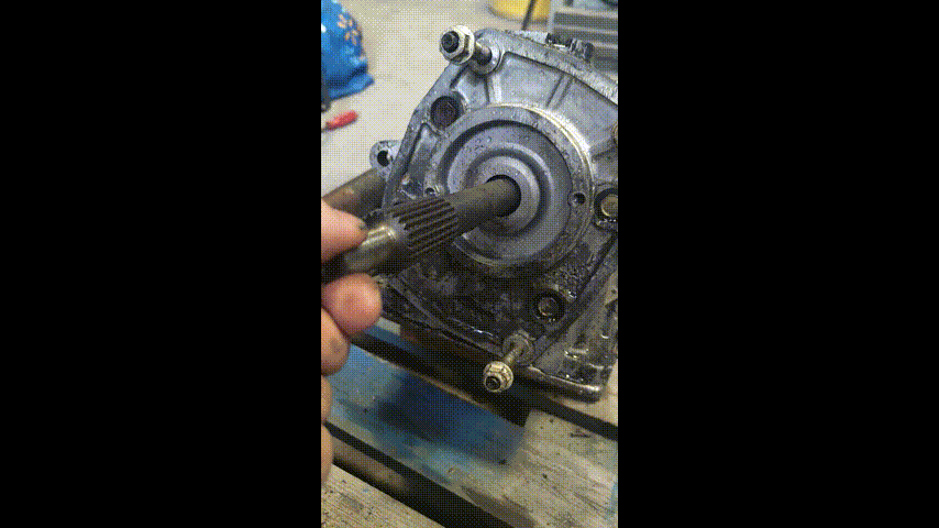

Some thing I have noticed is the amount of play in the input shaft not really sure if it's a to spec amount or not
You'll need spec information from elsewhere sir, but those top bolts are best reached from top front with a ratchet wrench, I use a 9/16" here, you might use a metric. Piece of cake, or at least it certainly helps :)

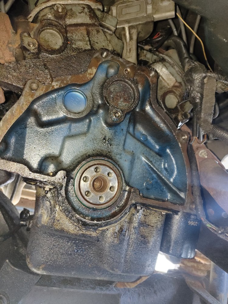

Not bad at all everything seems fine other than a shit ton of oil being there, my guess is either the oil pan has a leak or the heads gasket that are leaking. I know one is bad so maybe oil squirt out of it? 🤷

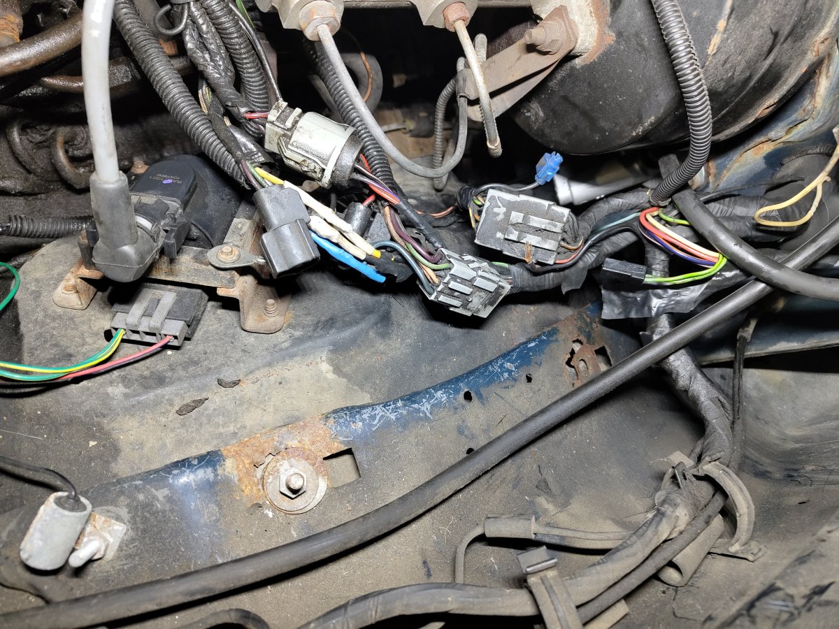

Doing a code check and honestly I dont understand the codes at all seems like I get 212467(11111 after code got repeated twice
So either 21, 24 and 67 or 212 467 but 467 doesn't seem to really be a xode for anything so the 2 digit codes seem more logical ...
ECT out of range?
IAT out of range?
And park/neutral circuit fault?
Last one seems like it could be the problem for my no start...
Also found a lone connector that leads to who knows where 😮‍💨

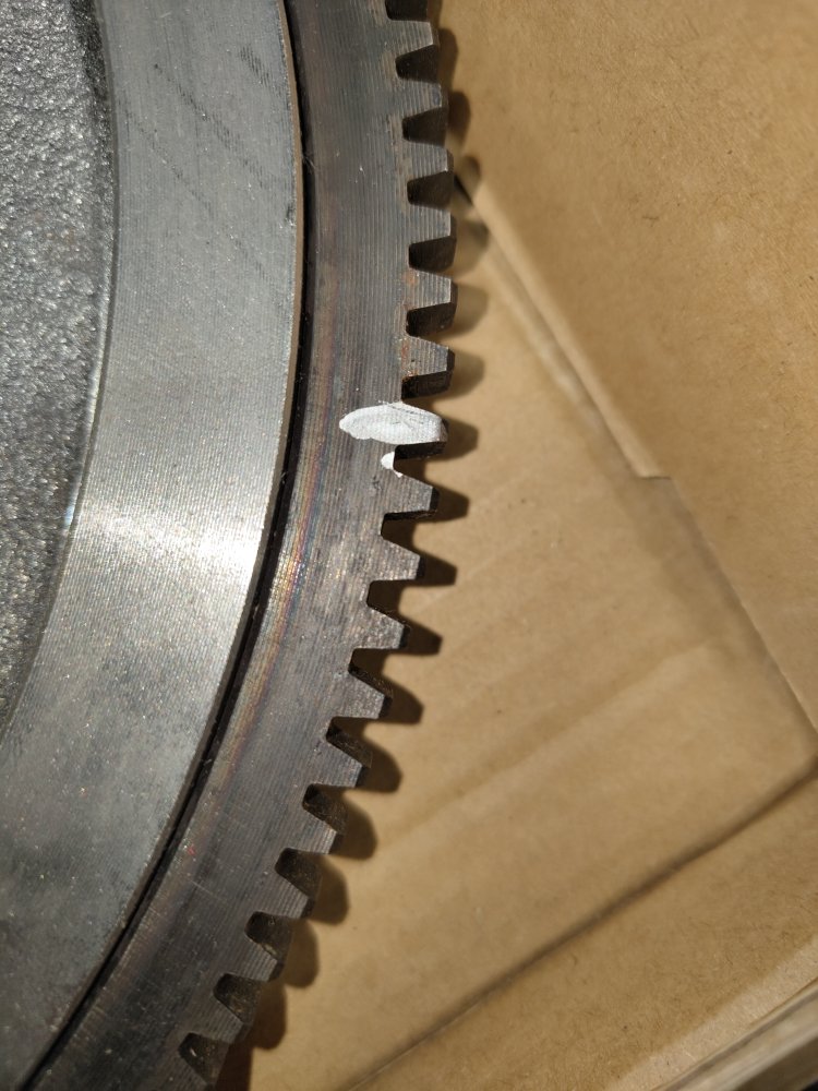

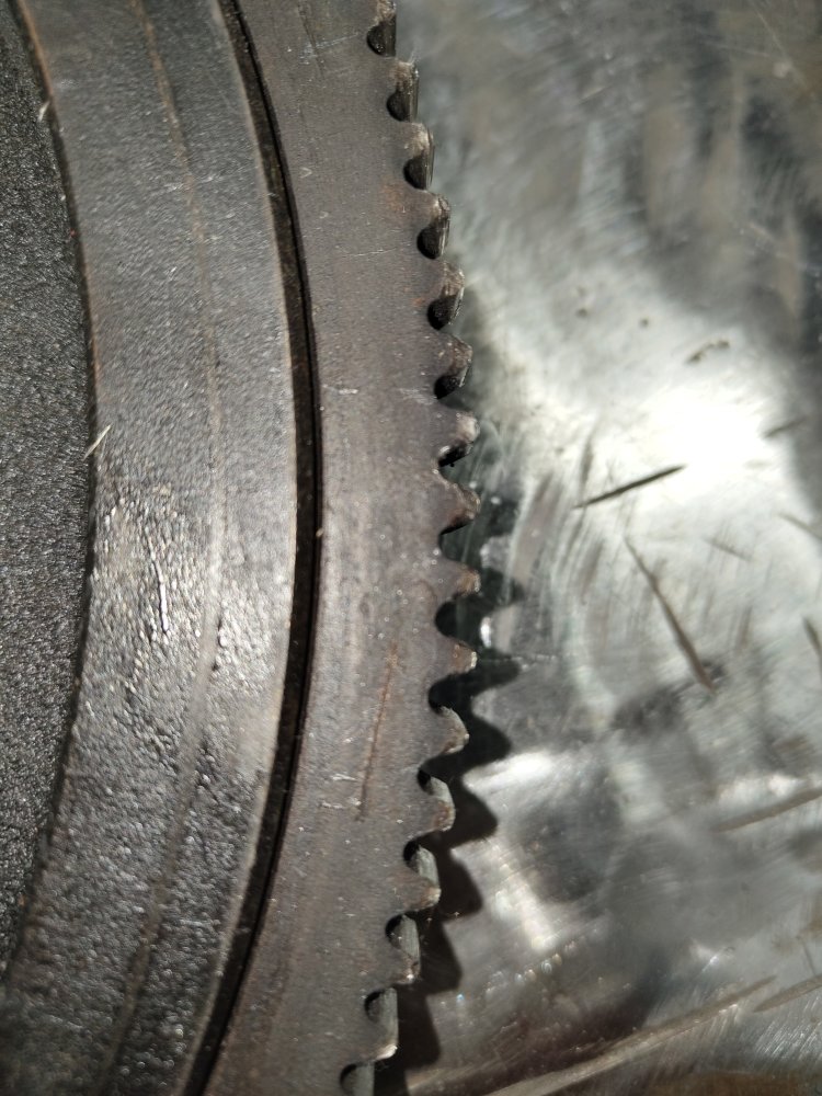

Found the problem, clutch switch is my no start problem, for now I shorted 2 wires so that I could try to start.. andddd original problem is still there :cautious:(starter grinding on flywheel and not engaging)
So checking for a way to change either timing (engagement before spinning) or if I can add some sort of shim or just get a new starter and go from there what do y'all think?
