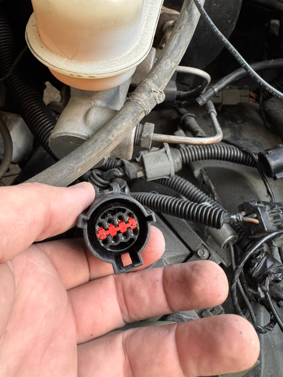

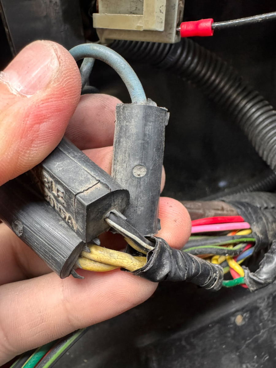

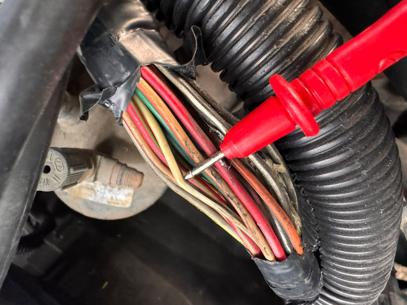

Hello, everyone, I need your help, it will be very much apreciated
Mine is a 1988 2,3L. It was working normally, but today it just doesn't want to work anymore. The dash panel is completely off, and not even the courtesy light is on. The battery is working properly, and I checked the voltage at the solenoid and after the 3 fuses next to it. I followed the line all the way to the firewall, and it seems to be ok, but I got lost inside the cabin; I just don't know where to look now. The wires on the ignition switch have no voltage at all; they actually show some resistance on the multimeter when connected to ground.
Thanks a lot in advance; greetings from Mexico!
