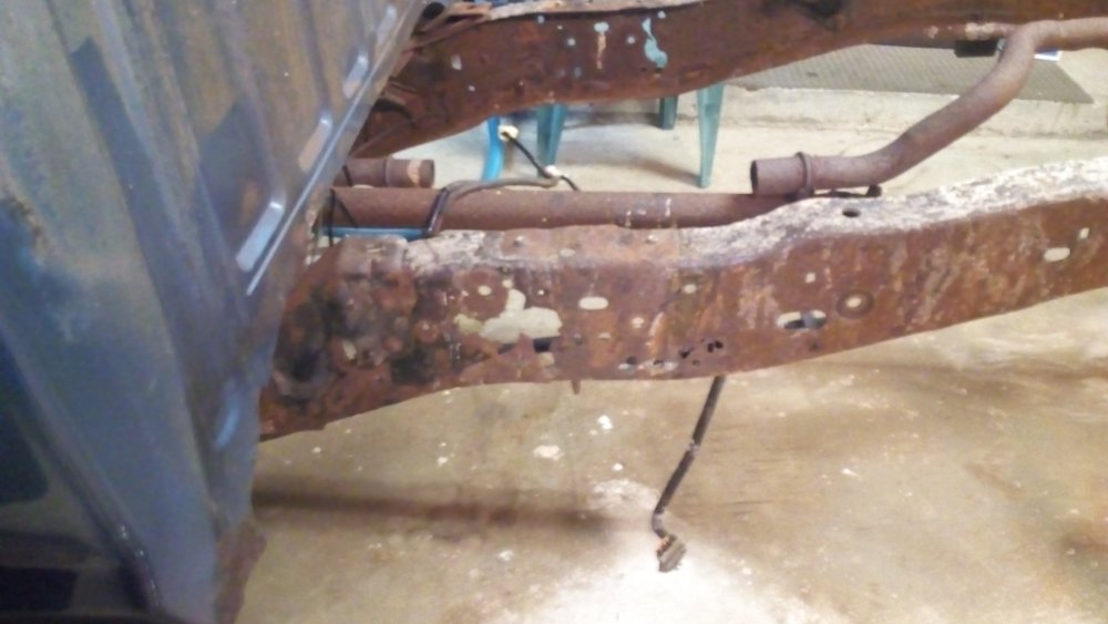

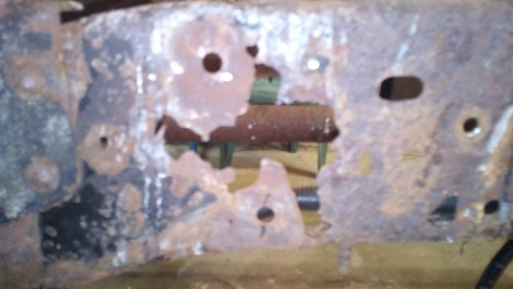

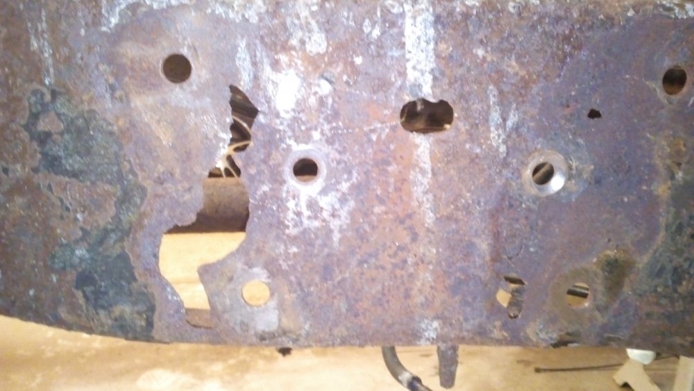

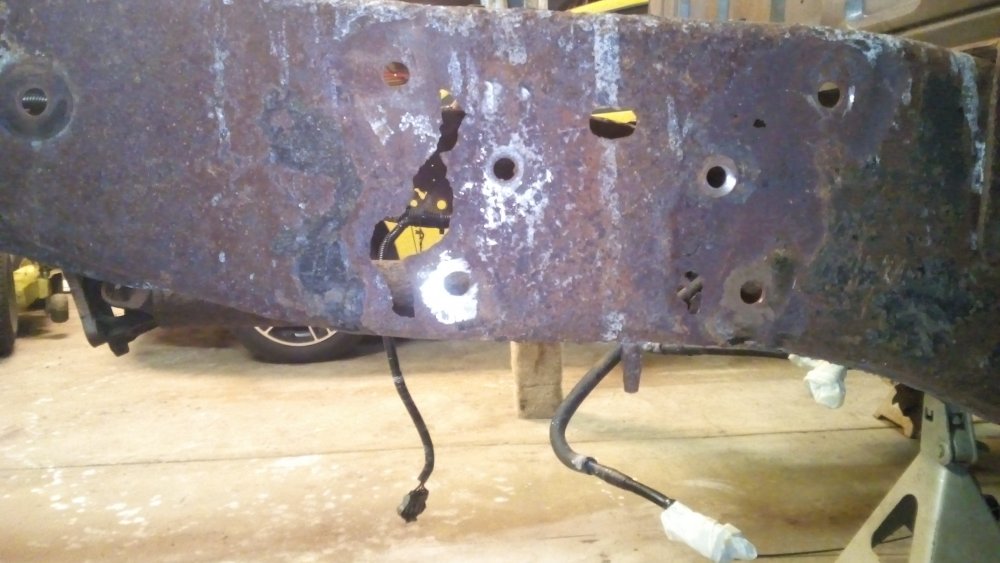

Is there anywhere to purchase Frame repair sections for a 1987 Ford Ranger STX - Rear section is in Dire need of repair around the rear spring harnesses on both sides. The frame is rusted thru on both sides behind the harnesses, I bought new harnesses but not sure how to patch the frame and make it sturdy again. Thx.
You'll have to make your own patch panels as far as I know. I've never seen any frame repair panels for sale online.
If worse comes to worse, and you ever decide to part it out, I may be interested in your doors and some other parts.
i would find a metel fab shop that has a plate bender and could make inserts to go inside the rails and extend from good to bad metal area then bolt the insert to the existing rail , weld anew section over top of the insert to make the rail like original . I have done this with highway trucks , it passes DOT inspection.

Land of Lincoln Winter liquid salt - other than this, the truck is in beautiful shape. I have quite a bit invested in Engine, Trans, front suspension, and body.
