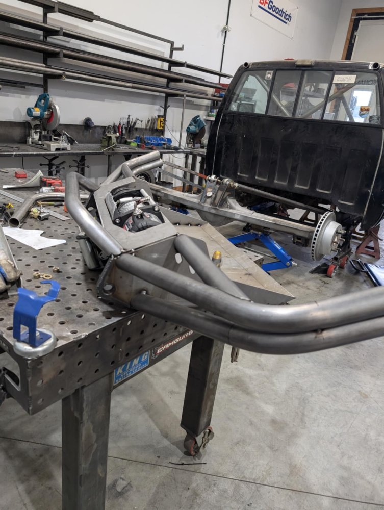

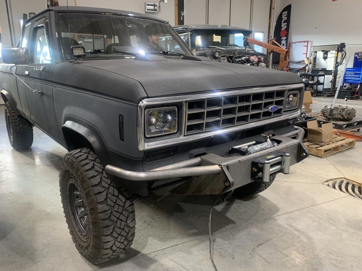

Sorry for the lack of updates. I should have one soon as we are currently in the process of designing and fabbing my custom front winch bumper. It’s going to be a hybrid of plate and tube style. I’ll coat it with Raptor and adorn it with some LEDs of course. Trying to make something that fits with the old school style and looks like it still belongs there.

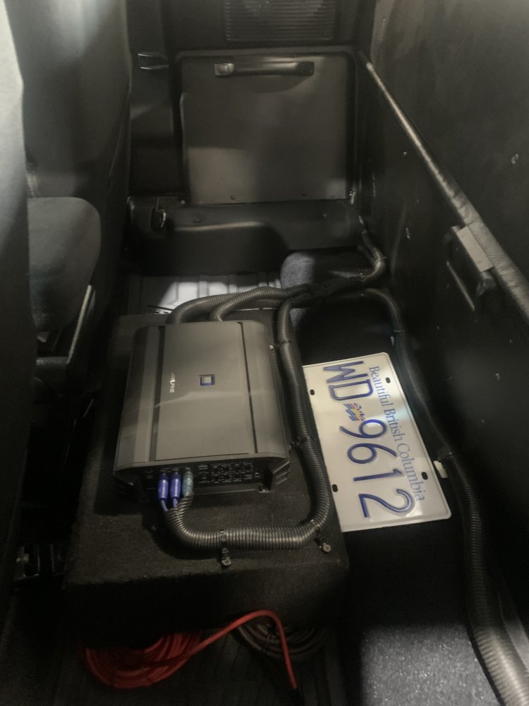

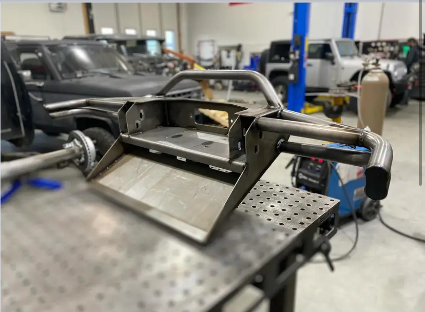

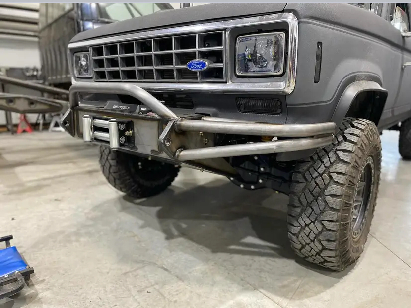

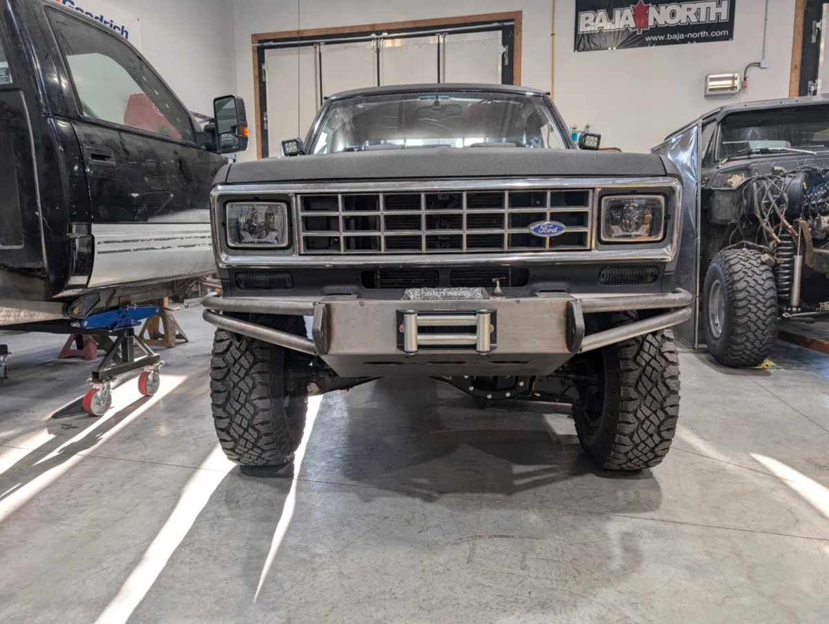

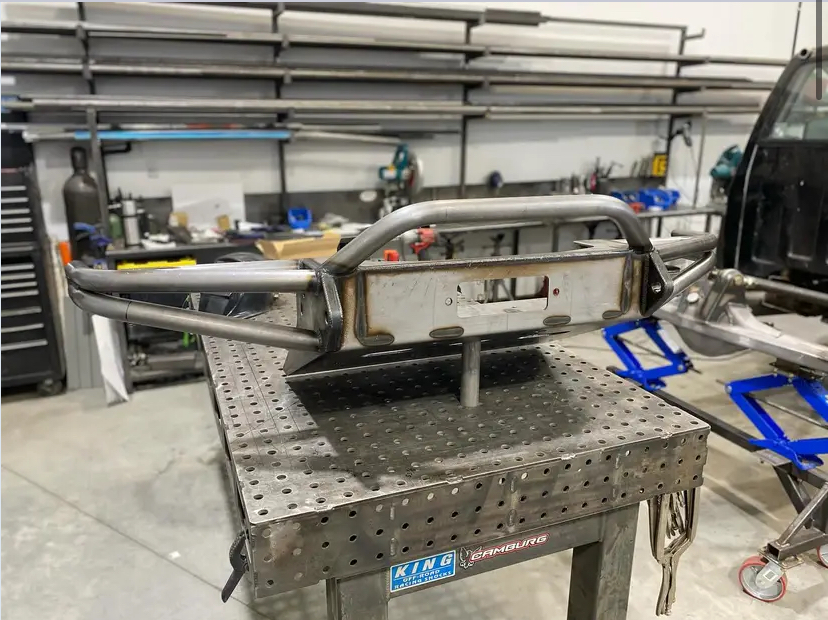

Bumper progress is coming along. Will be a double tube bumper, and a small hoop over the winch. Also, remembered to get a couple shots of the stereo setup.

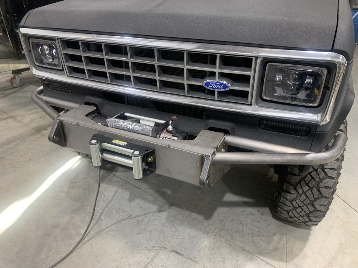

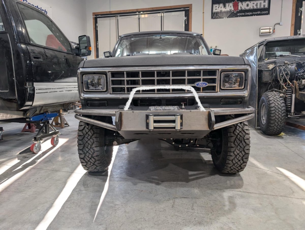

Now we are thinking no hoop over the winch. Thoughts?? Anyone decent with photoshop? lol.
I'd want something up there to protect that beautiful grill and headlights. But then kinda a shame to hide 'em too.
Yeah not sure what to do. The grille is a beautiful piece to cover up but also beautiful enough to want to protect. I just marked up the photo as an example. Thoughts? Low and mid bar
Personally, I like it without. But the mid bar option doesn't look bad either. Your mockups have pretty thin lines. Would it be that thin or made from thicker tubing like the bumper tubes?
Edit:
Also, your wiring on that amp is cleeeeean. I like.
Thanks! The mock up is just the paint brush on iPhone. If I went with it I would use the same tubing as the sides.

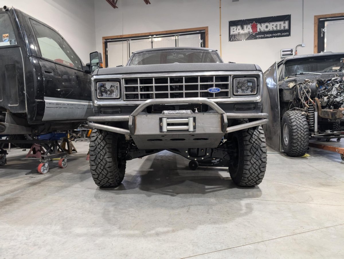

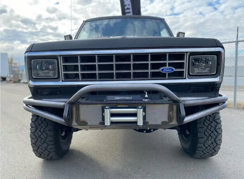

I think I’m going with this.
Wow, just found this thread today and have enjoyed the read. . . What a great build - - great attention to detail and customization. . .
Well done.

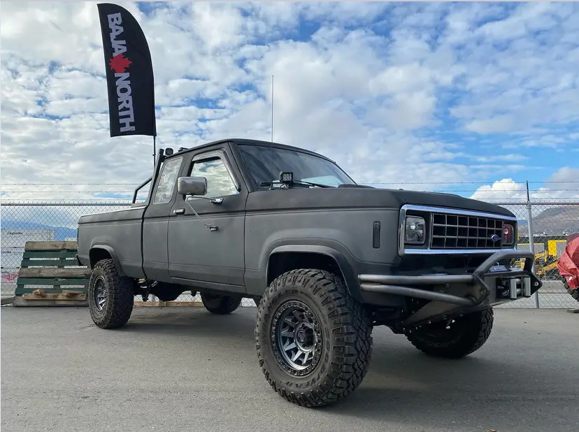

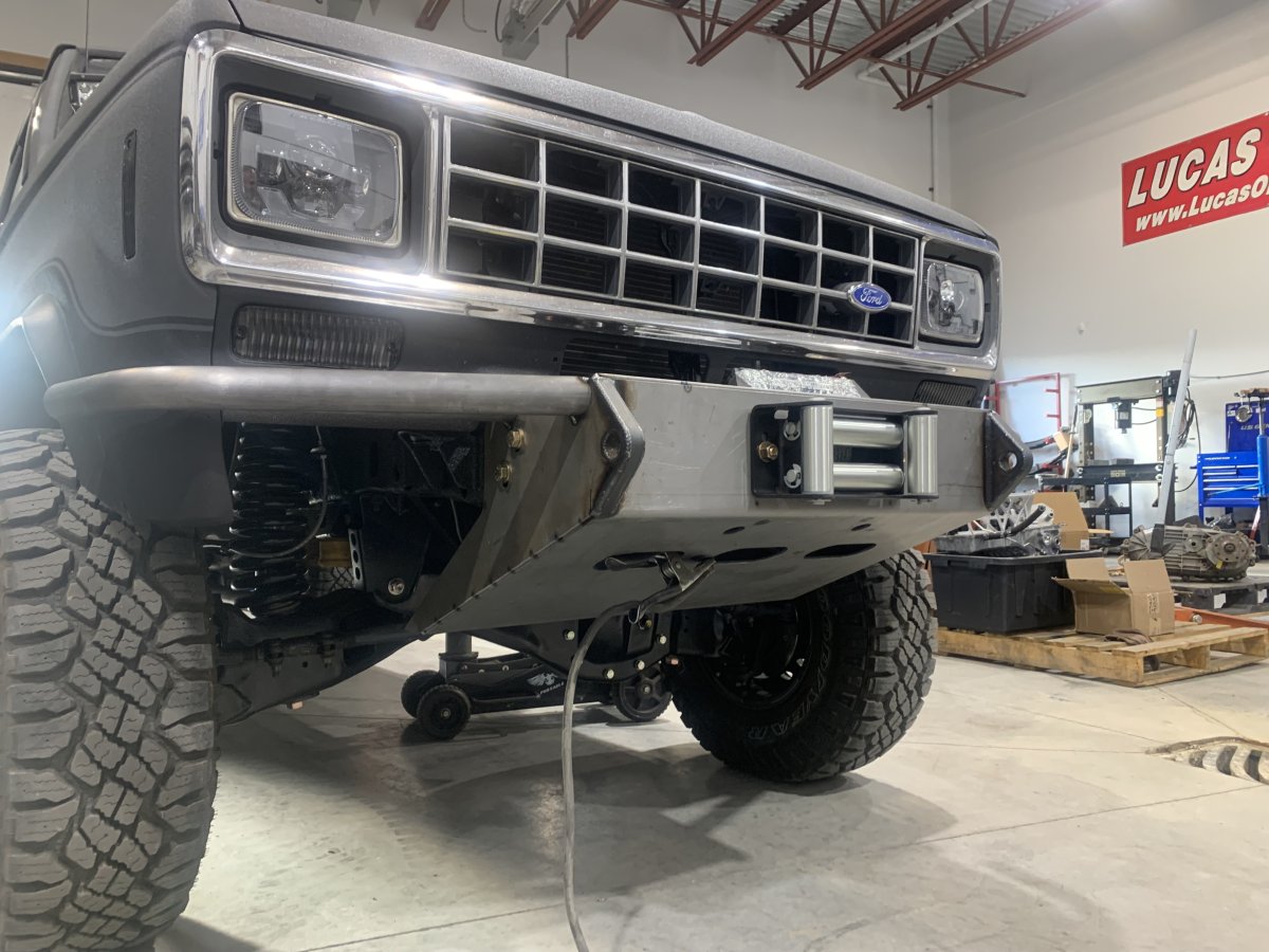

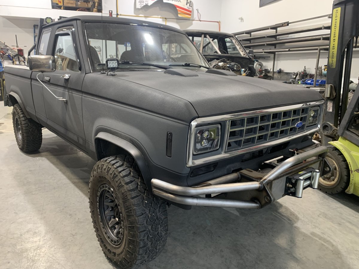

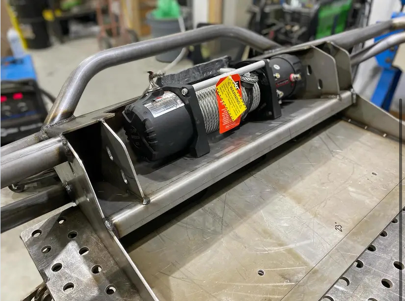

Just need to weld a bracket for the winch control module, and it should be ready for Raptor liner. Very happy with how it all turned out.
No disrespect to your son, but that Ranger is a shit-ton better than any Nissan Frontier . . .
Just sayin. . .
