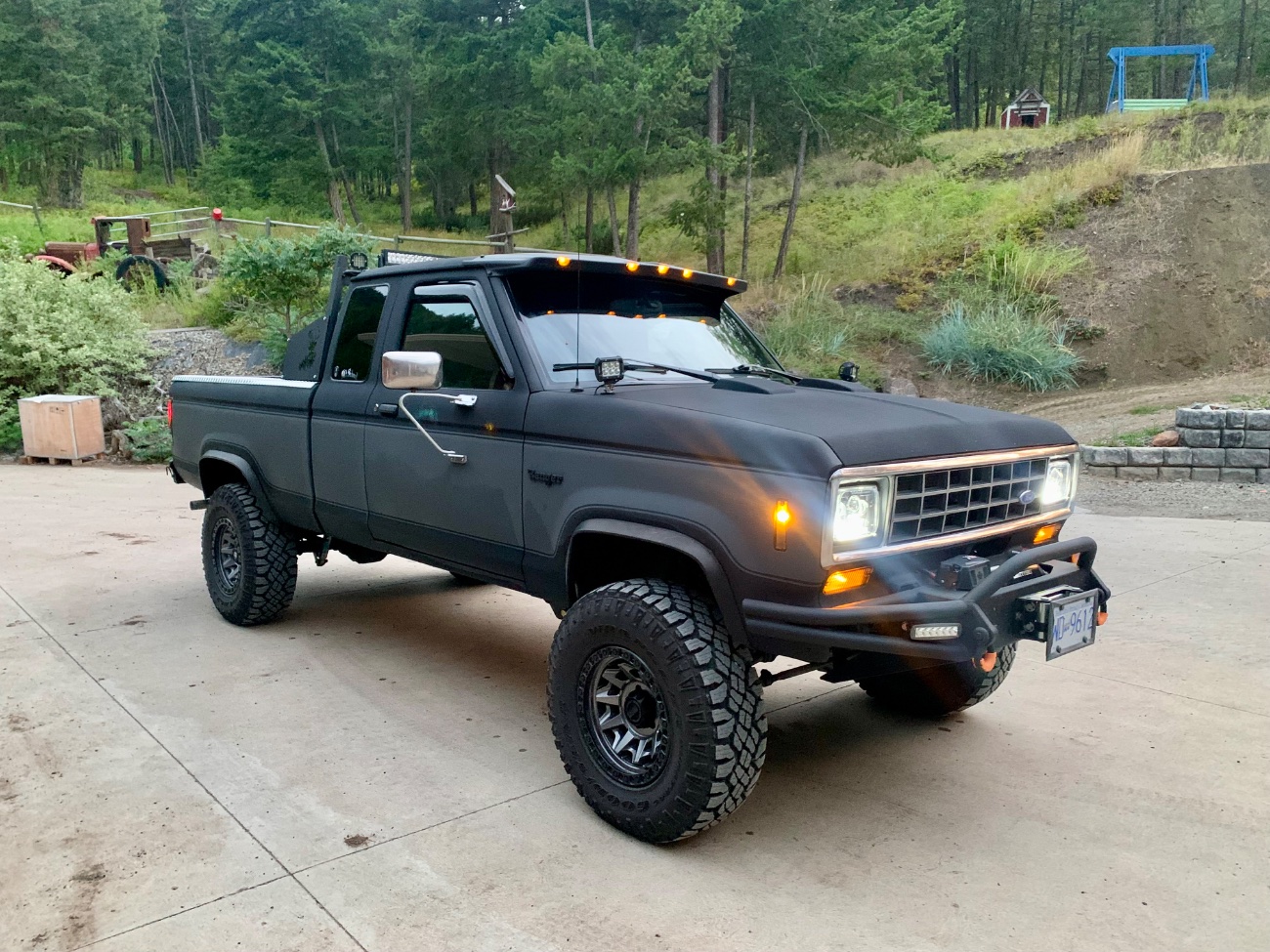

1987 Ranger Project
Dang where do you live? I’m in Canada with our ridiculous laws and this is still not illegal here as long as I’m in the truck with them.

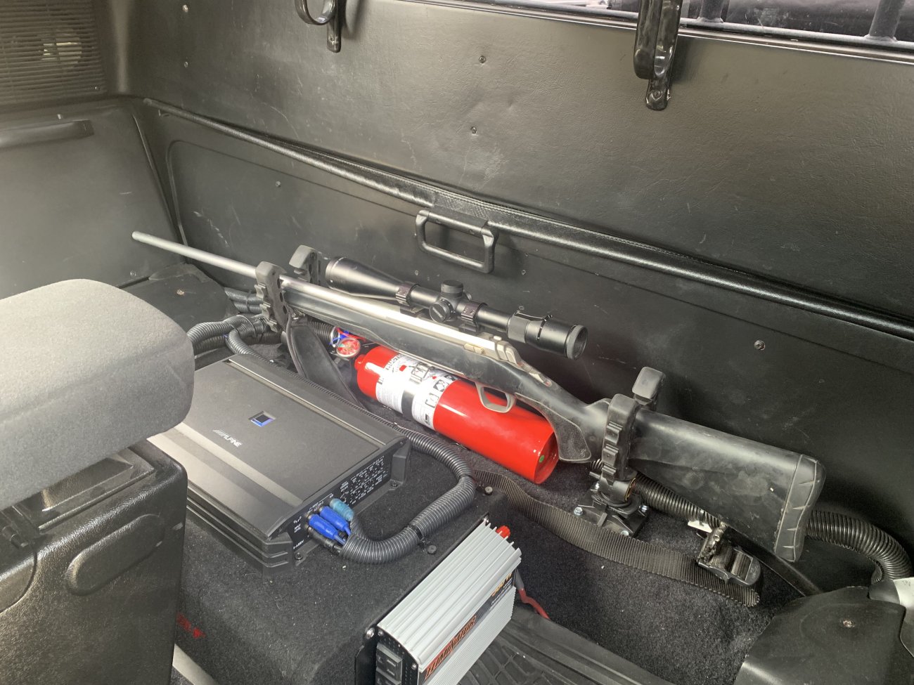

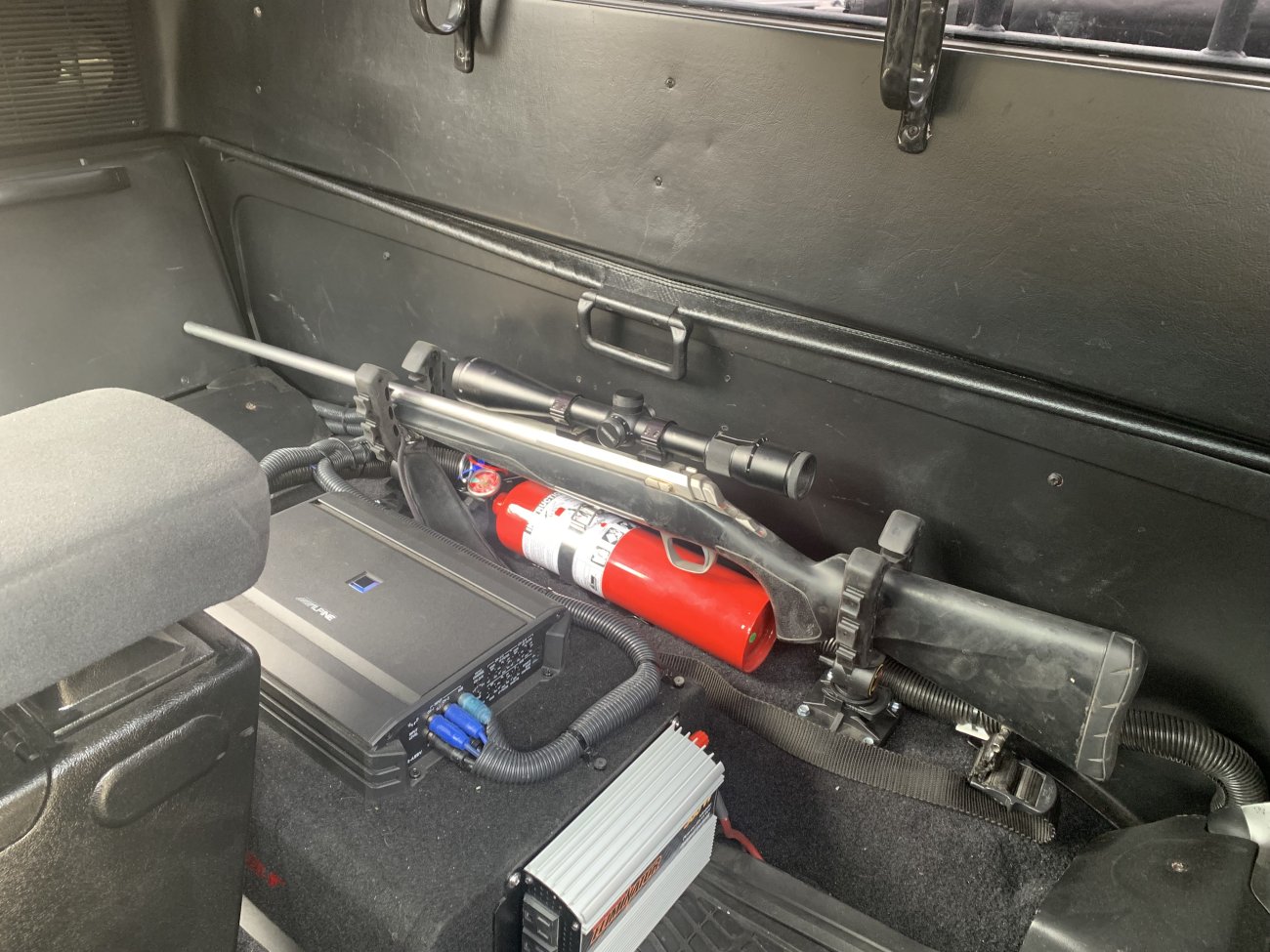

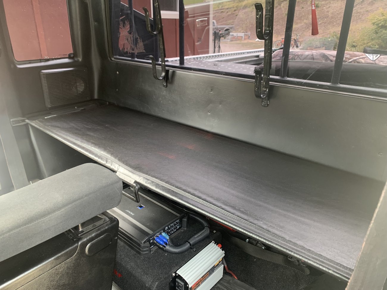

Anyways, I decided to install another rack and changed my fire extinguisher because the other one had some wimpy ass plastic mount. This one comes with a nice steel band.

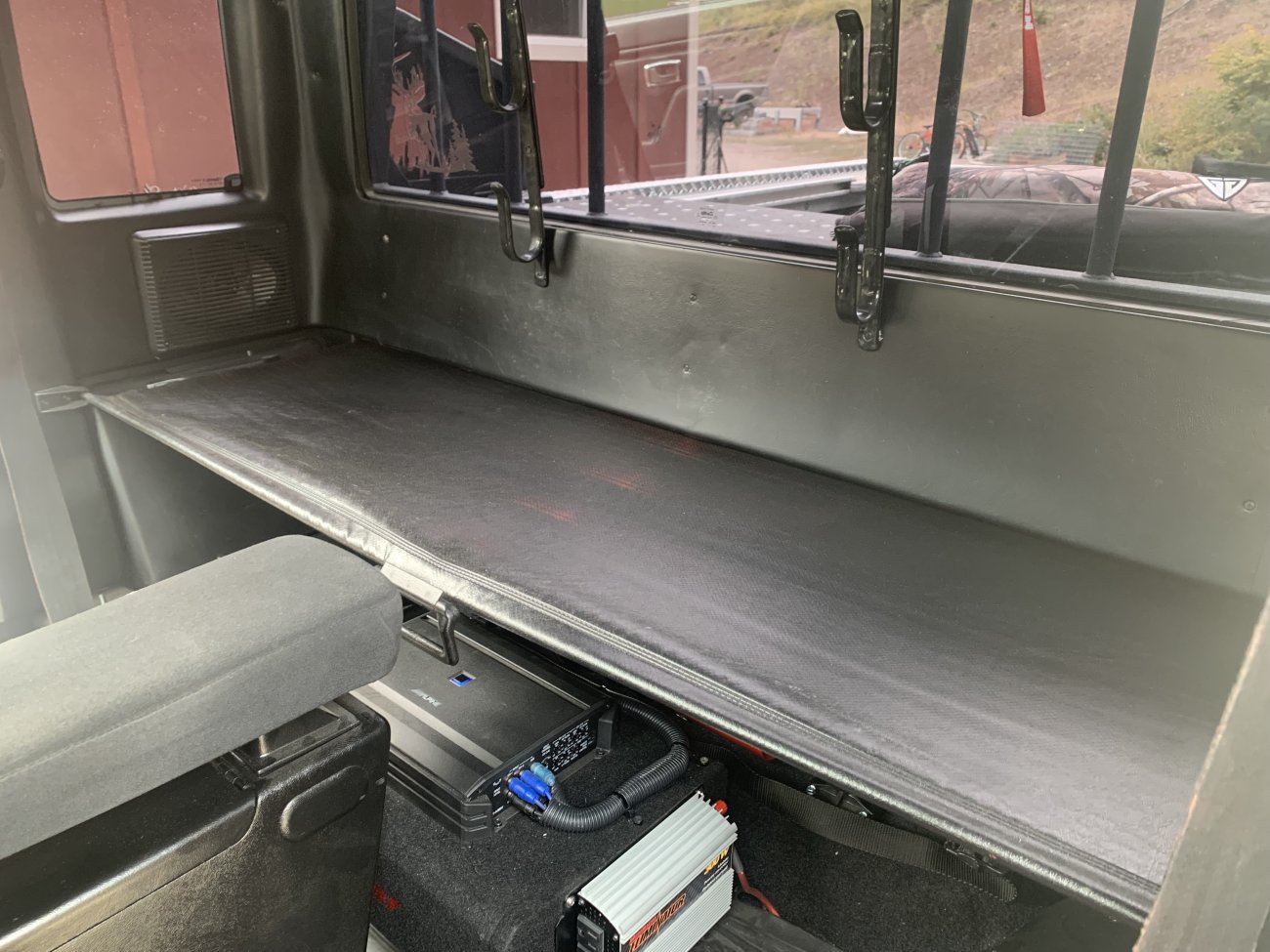

For the gun rack I just used an old set of mounts I had kicking around for an ATV that were never installed. This way I can also hide the rifle under the tonneau cover for even more discretion.
I might actually be done with this rig now? Kind of sad and gratifying at the same time. Guess I’ll have to bust out the Bronco II and get going on that now. I’m sure there will be more upgrades and alterations down the road as the saying goes, “are they ever truly done?”

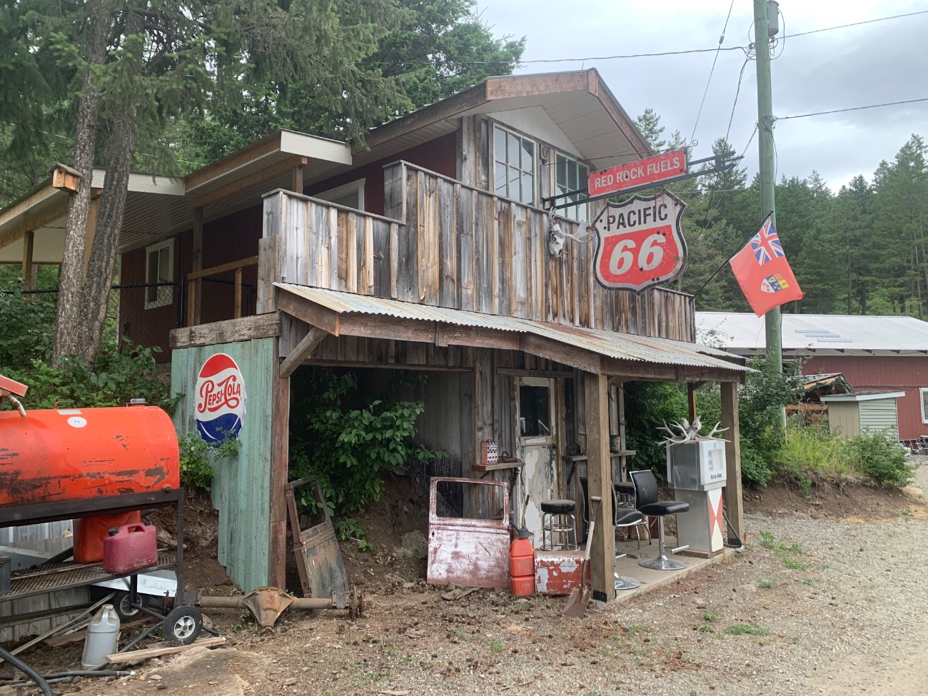

Well, not much of an update post, just general commentary. Truck has been running great and is just a hoot to drive. Lots of love from people on these old first gen trucks it seems. I can’t drive anywhere without multiple thumbs up and compliments. Wish it had AC in these hot summer temps, but come fall and hunting season it wont be an issue. Oh and I finished the gas station facade I was working on as well. Finally got the side garages done. Now I just need to cut a junker in half to stuff in each side. Got an old 63 T-Bird that will fit the bill.

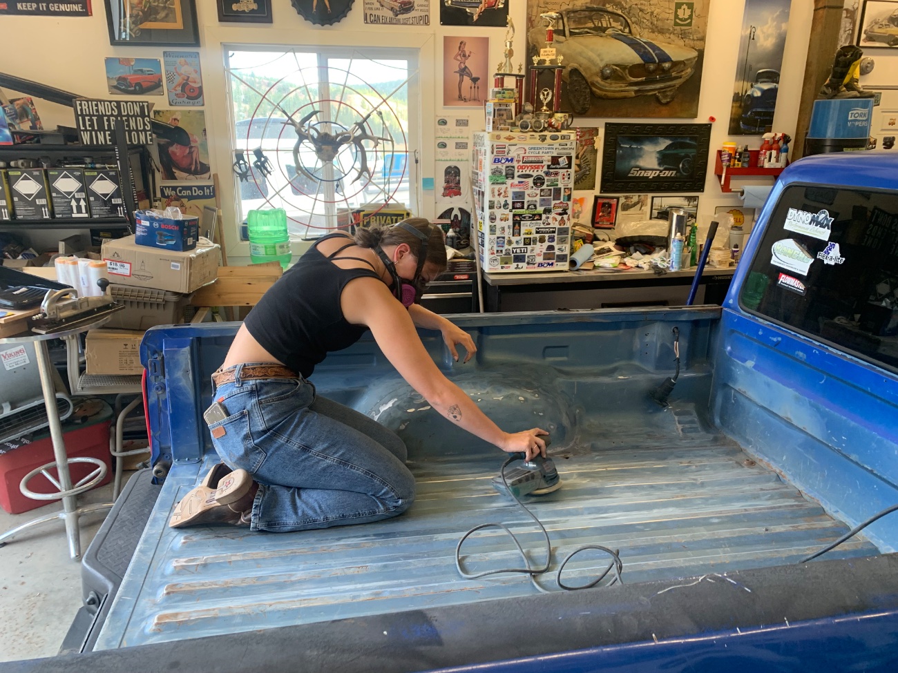

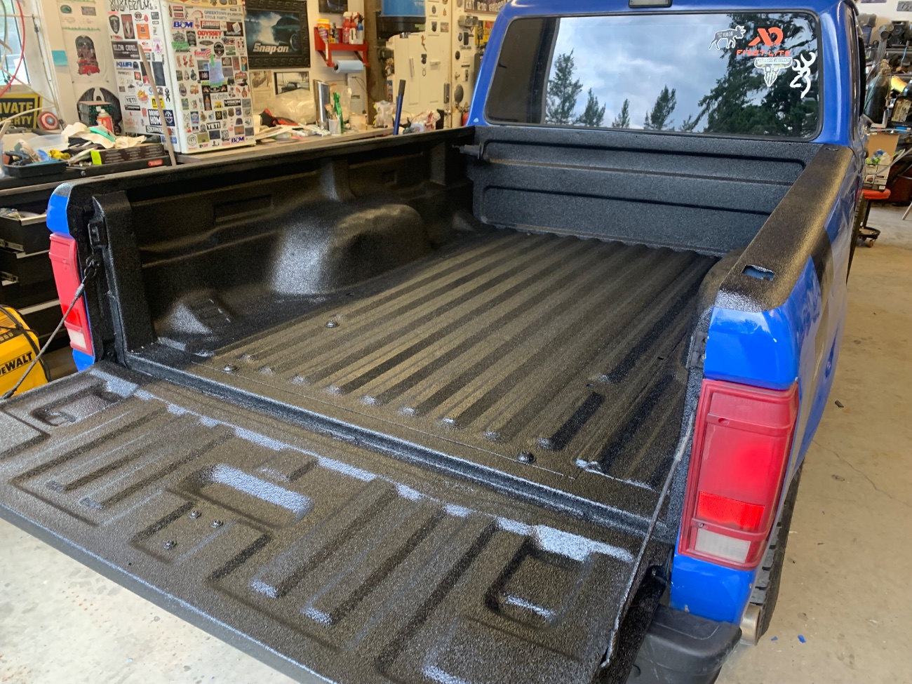

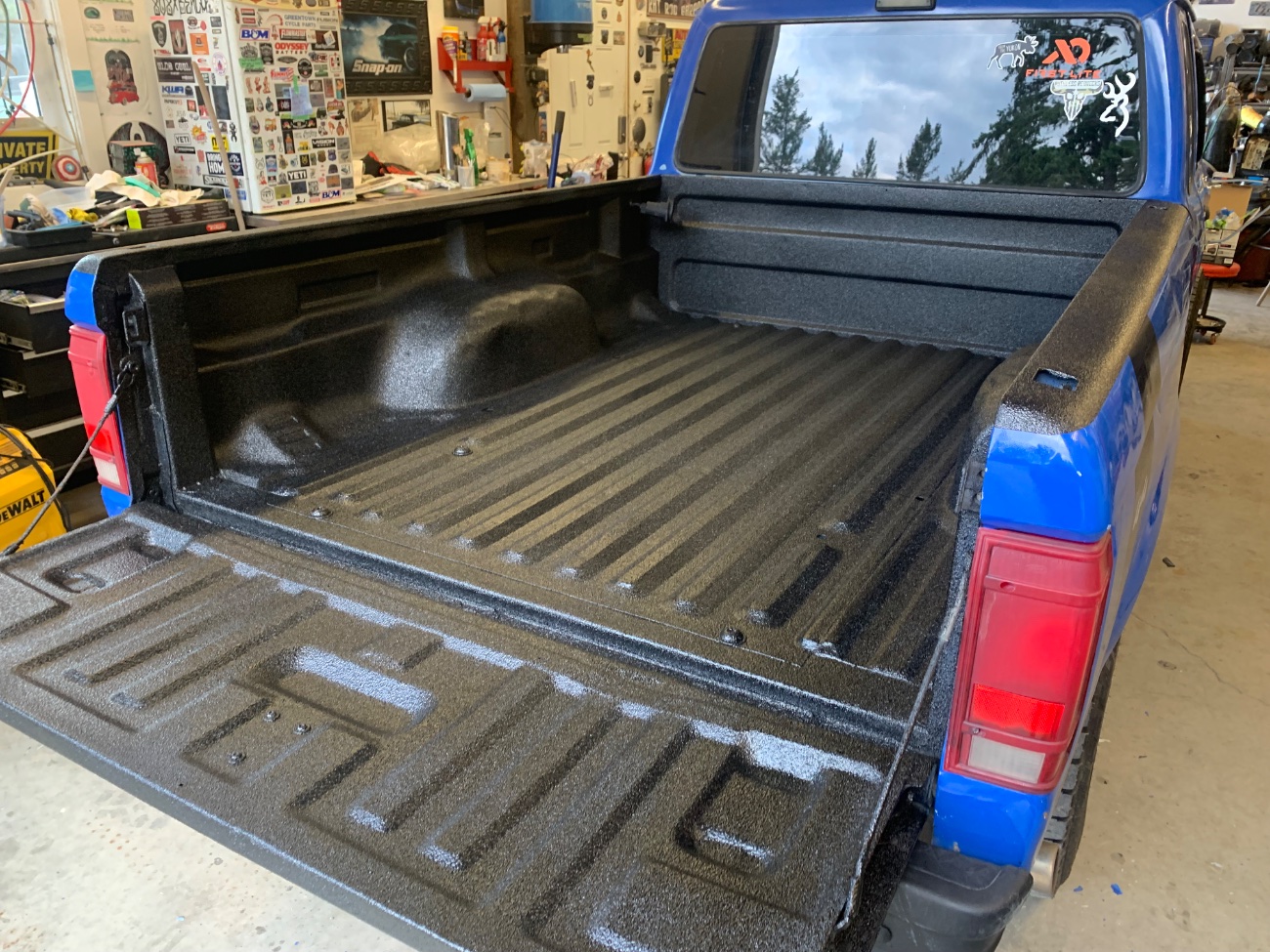

Well my niece came over with her blue 91 Ranger again and asked for help with spraying Bedliner. This time I sprayed Herculiner. Sprays nice, and only one coat is required. I’ll update with a post once it’s all cured and let you all know my opinion. So far I really like it and it definitely has some rubber content to it. Sprayed the headache rack too.
But here she is doing all prep work not afraid to get dusty.
Fixed her tailgate too, as she says she can never open it. Needed to weld in all the nuts for the side latches. Works like new now.
View attachment 132632View attachment 132633
How did you weld the nuts without an access panel?
Its great to see her do the work and wanting to make it better. You did a great job on getting the liner sprayed out. I too am curious as to how you were able to get the nut welded back on. I am thinking of make an access panel, then weld the nut and let my tail gate cover hide the access panel.
I just pressed the nuts into the hole using both channel locks where it would fit and thumb strength where they wouldn’t. I was fortunate enough to have them stay but they wouldn’t if you tried to thread a bolt. I thought of using an epoxy from the backside with the bolt in the threads, but knew that would just be temporary with banging the tailgate all the time with opening and closing. There was enough of a gap in the 4 corners of the nuts/sheet metal that I was able to tack weld from the outside. Then I dialed up the heat a bit and burned the rest of it on forever. Little bit of grinder love and the latches threaded back home perfectly and permanently.

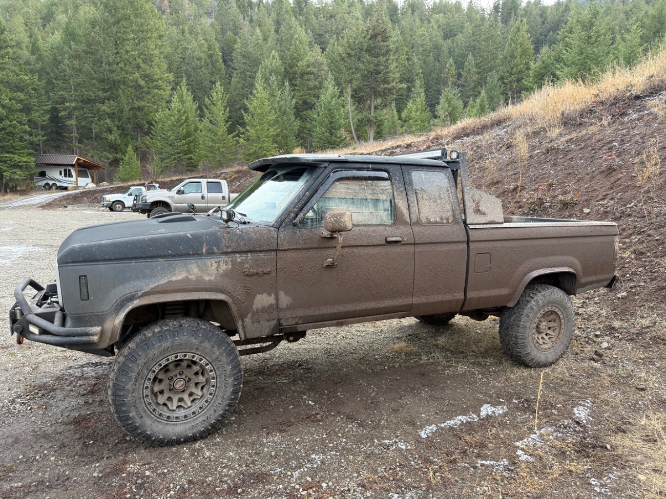

Just a random update. Nothing added or changed, except the Warn hubs were not up to standard, as one of them basically fell apart. So I installed some Mile Markers and they seem to be performing great in the mud and snow for hunting season. The rear locker has broken in nicely, and engages easily. The TC issue of staying in 4High is still not perfect so not really sure what else to do there. Open to suggestions of anyone else has suffered from this?
Overall, super happy with how this truck performs off-road for my hunting needs. We live in the Rockies, and the hills are steep, snow and mud deep, and the torque of the 4.0 is a great improvement over the tired 2.9 the truck originally had. 4 days left in the season, so hopefully I can still fill the box with natures groceries. At least I got my twin daughters on the board each with bucks this year so we are set with Christmas sausage and pepperoni. 👍🏻
