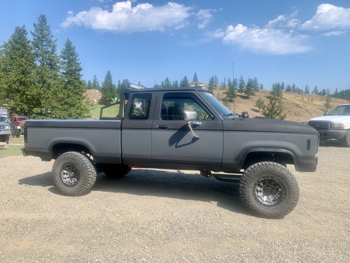

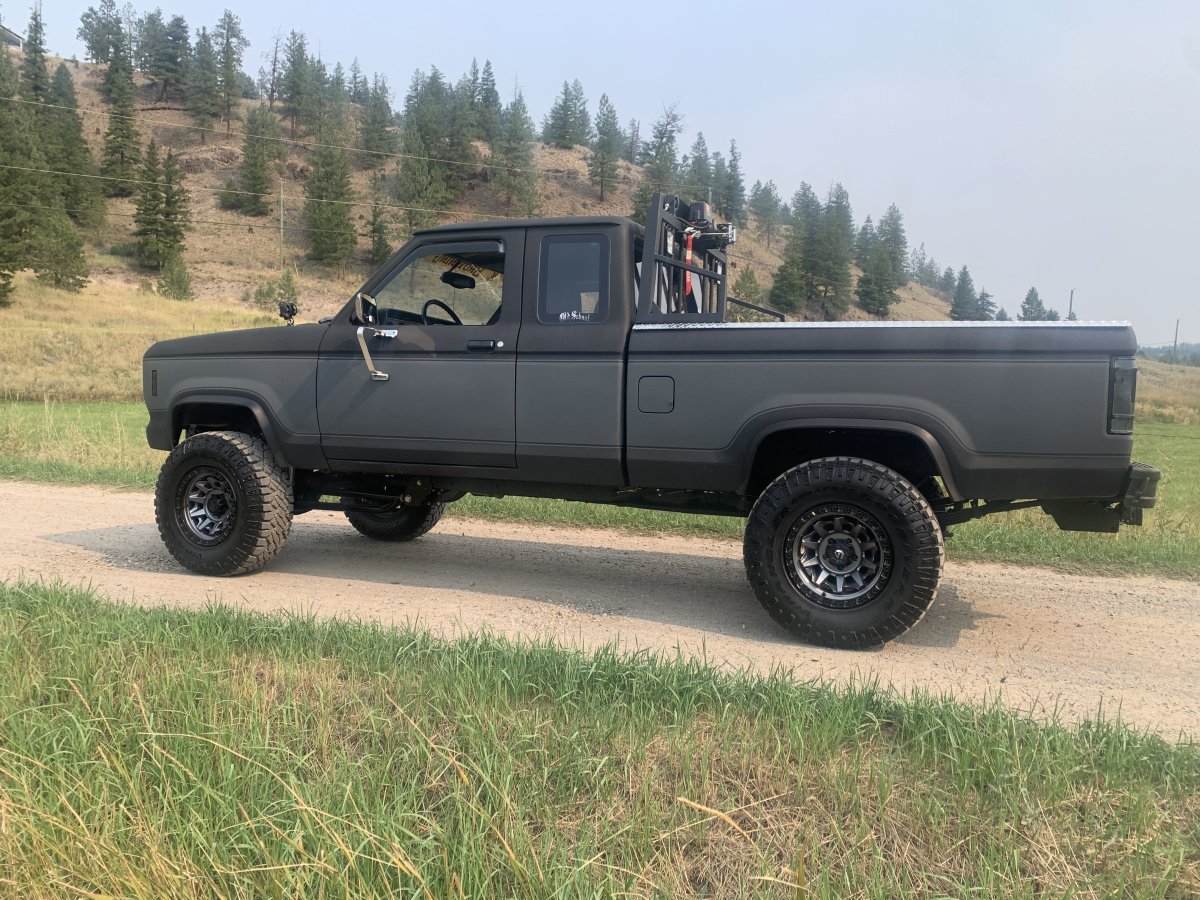

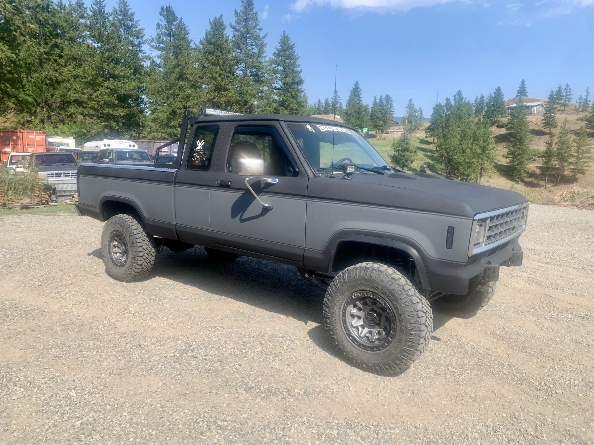

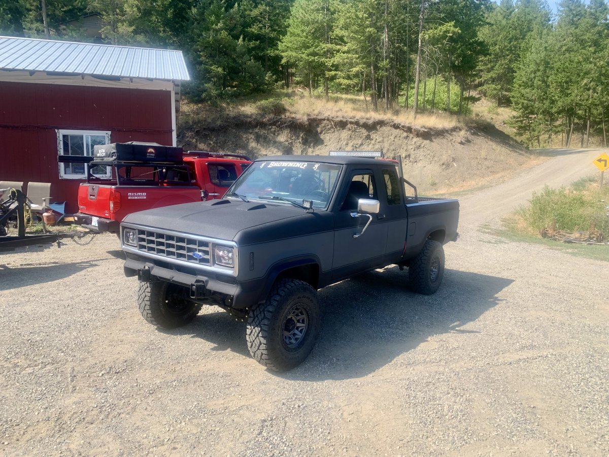

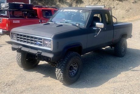

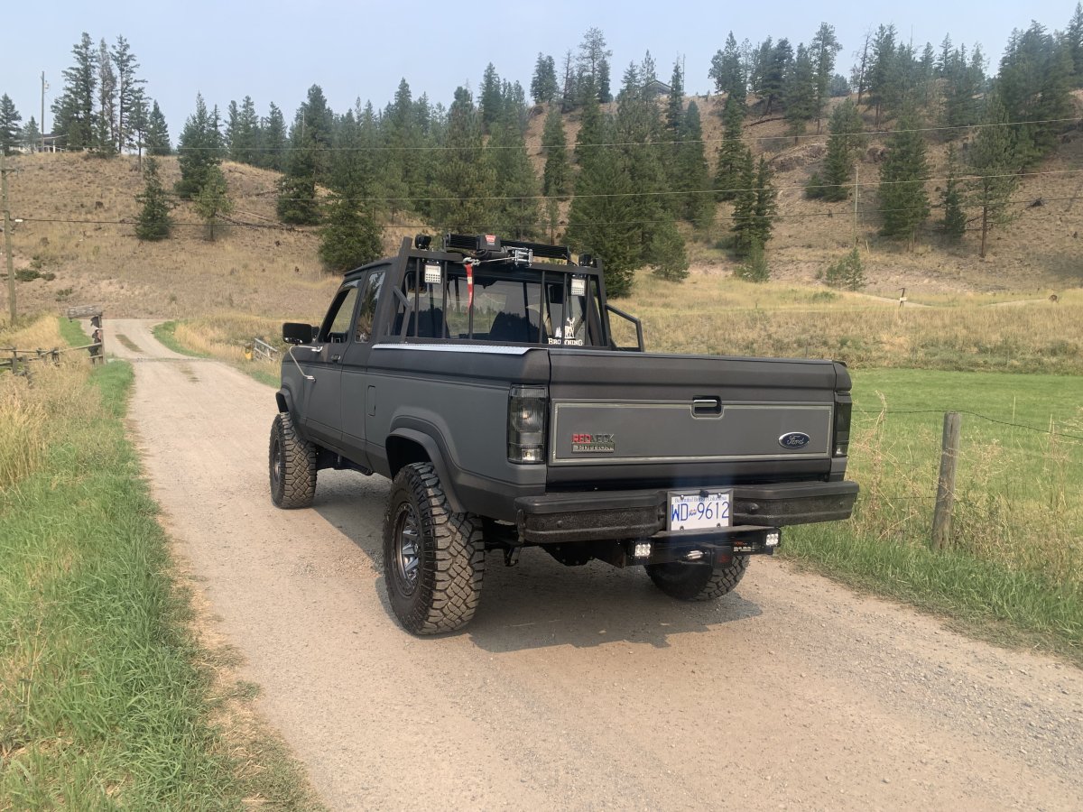

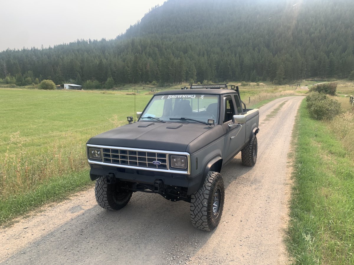

Thanks man! I took it out of the garage and drove it up and down the driveway with the suspension parts still loose to settle everything before I take it for an alignment. So here are the first pics in the sun! Love the torque and power of the 4.0 over the 2.9 for sure. Worth the upgrade in this situation.

Now you did it; that truck is too pretty to get dirty.
You've done a great job. That's one nice looking truck, and I bet it pulls and drives great, too.

Haha. That’s what everyone that sees it says. They say bring it to a car show. lol.
I know I will cringe just a bit the first mud puddle I go through because it’s never going to be as clean as it is today going forward. lol.
It definitely pulls good. It’s hard not to spin the tires in the gravel taking off feathering the clutch even with the locker, where I had to be heavy on the gas pedal while feathering the clutch just to take off with the 2.9. Going to need to add some weight in the ass end. Put the spare tire back underneath at minimum.

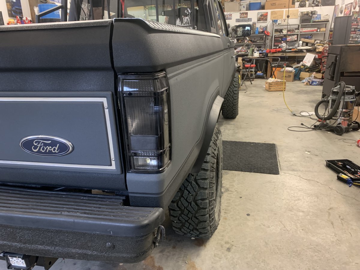

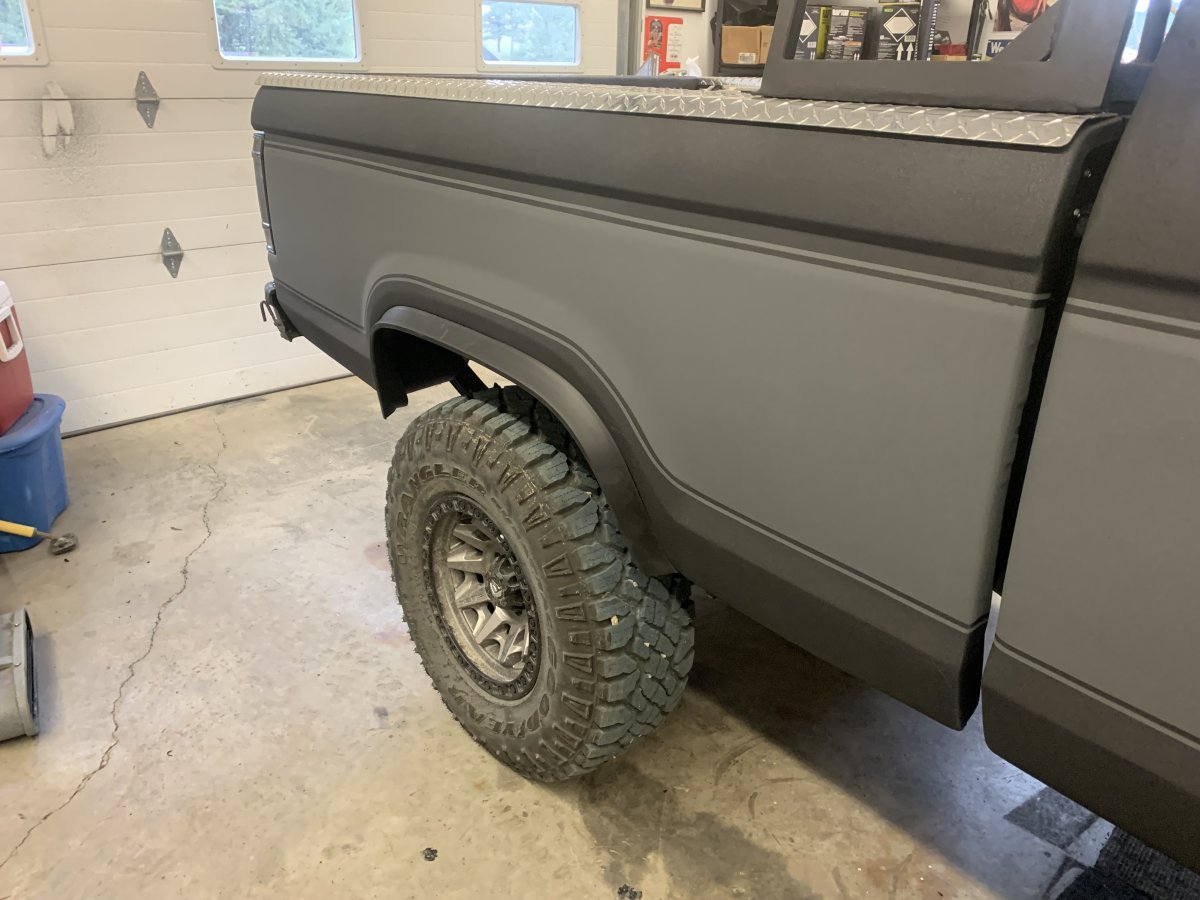

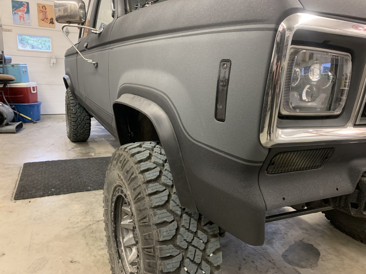

That looks far better than I thought possible with a foam rubber flare.

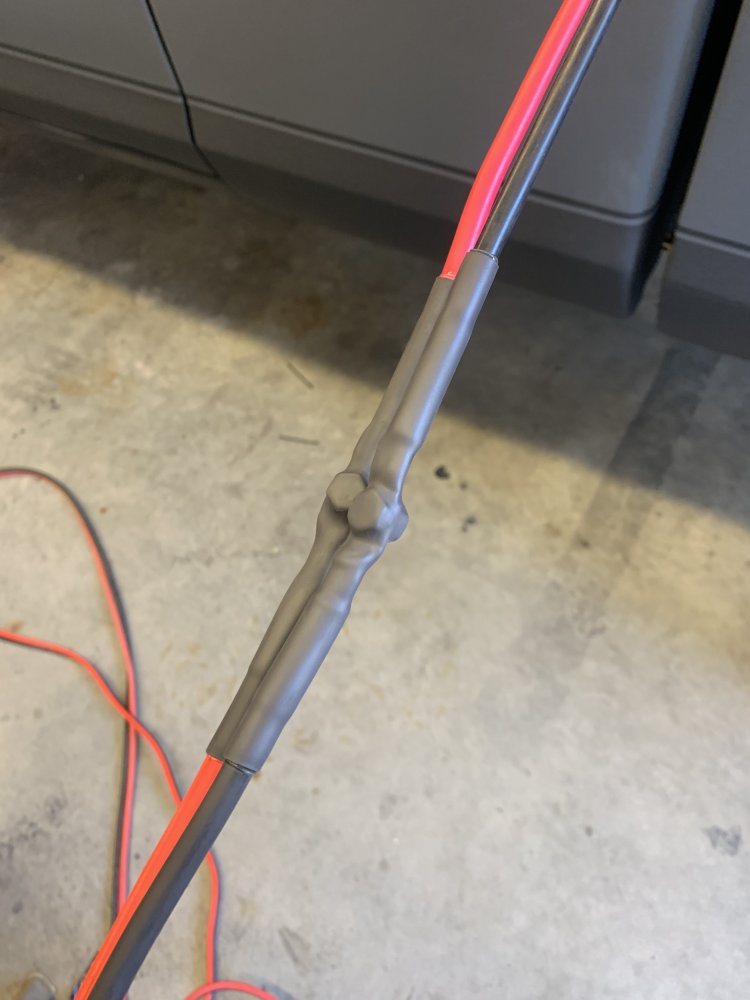

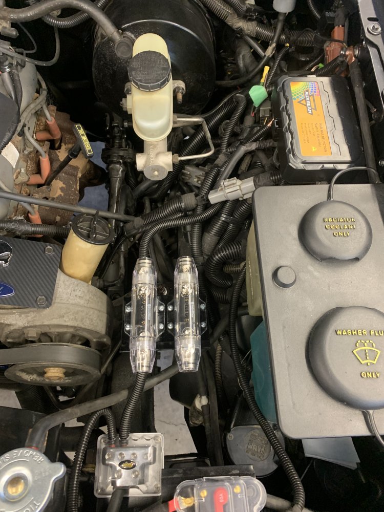

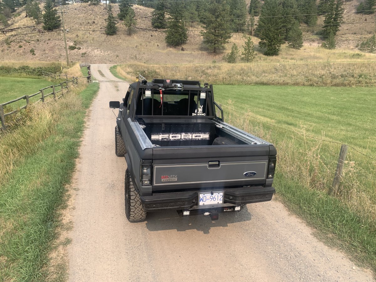

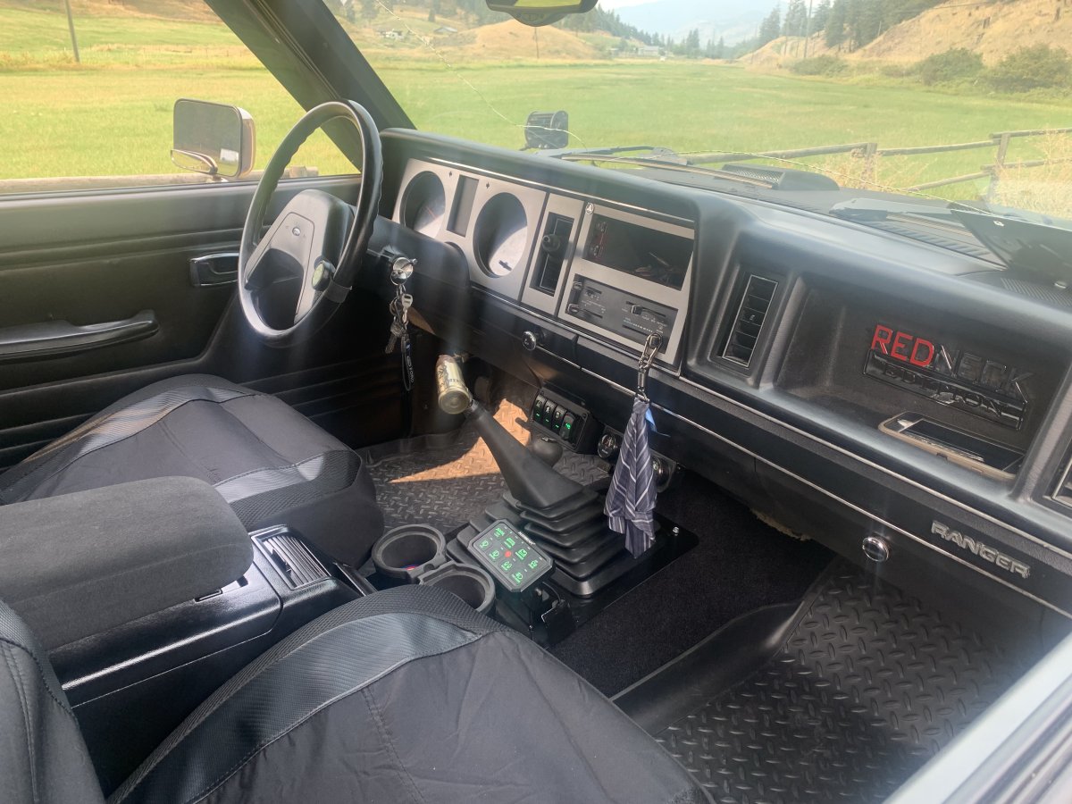

Got a few details done today. Got the rear rack winch hooked up. I used the wire from jumper cables I bought for $12. Way cheaper than buying the 4 gauge wire by the foot. I crimped some loop ends and bolted them together if I ever have to (God forbid!) remove the box for any reason. Sealed with heavy duty heat shrink and covered in plastic loom. I also added some rack lights as well, as I thought the light bar looked lonely on top and I had these sitting around. All lights are hooked up and functional with the Auxbeam controller. It’s pretty cool design. Couple slots left for when the bumper gets made and installed. Probably some fog lights and another light bar?

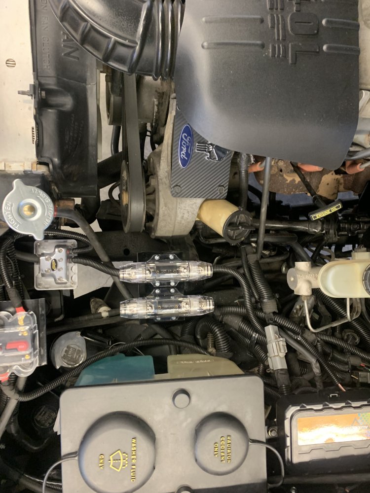

Made a bracket to mount the fuses for the winch and the amp I will be installing Tuesday with the stereo.

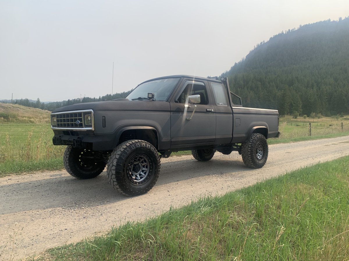

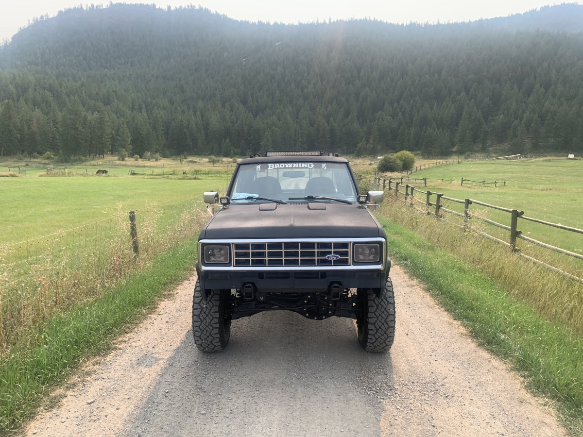

Well, took the truck for a test run. There are a few issues I will need to address. Typical shakedown stuff I guess. Speedometer isn’t working so I’ll have to check the connections on each end of the cable. Brakes seem a little soft. For some reason my reverse lights come on with both the brake pedal and/or the turn signals?? I may have a vacuum leak somewhere because my idle is pretty high at like 1300 rpm. Anything anyone else can suggest for that?
Anyways, here are some outdoor shots, along with the under hood lights I installed which are activated by a rocker switch.
