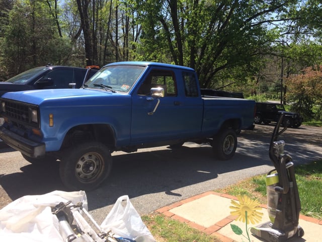

Well here's my second ranger project I'm attempting. Picked up a rust free 1987 ranger with a blown tranny to be the project. Here she is.

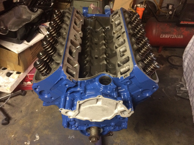

And finally, I went with Eastwood's Deep Ford Blue ceramic paint for the engine and here's the finished product.
1987 Ranger 306 Project Build
And I finished up with a gloss black oil pan and in the future valve covers.
Now to catch everyone up. I dissembled everything and did a final assembly up to my intake so here's where I'm currently at on the engine.

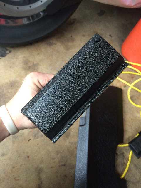

Began my interior painting. Starting with the dash pieces. I'm going with Eastwood black wrinkle paint. It's my first time using it and I gotta say I love it.
I'm gonna do the rest of the dash tonight. Very pleased so far.

Lower dash is finished all in wrinkle black and I found a newer ranger badge I threw on to the trim for some uniqueness . Pictures don't really do it justice and don't show the cool texture of the wrinkles.
