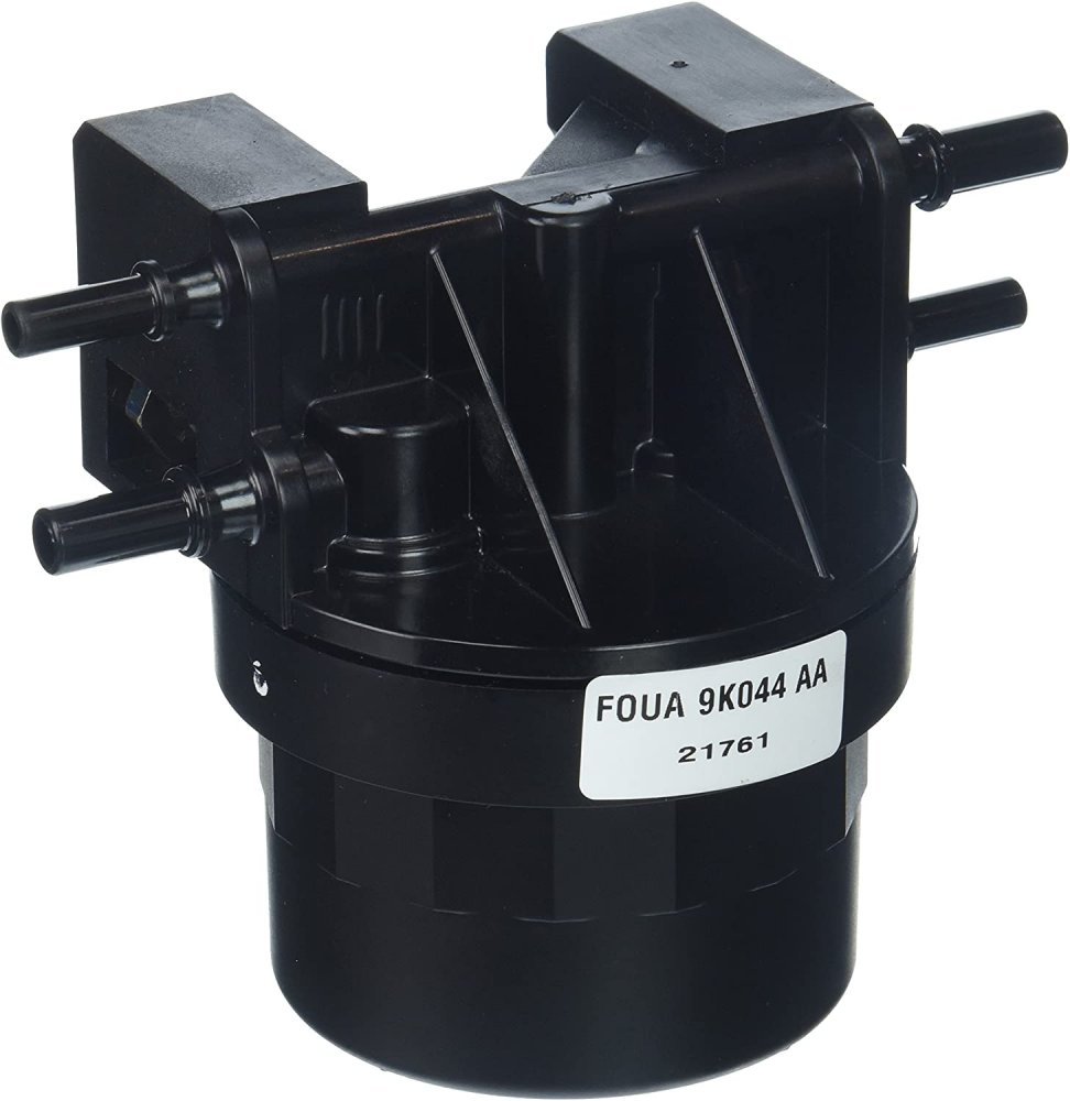

When you bypassed the fuel reservoir, you did connect the two smaller hoses and the two larger hoses, right? Just checking, because the supply and return lines switch positions when they exit the reservoir. Swapping the lines would create the problem you have.
Also, if you try to force open a reservoir that was not designed for a filter it could break it. I have heard that the two parts of filter-less reservoirs are glued together.
IMHO, I would leave the reservoir connected. Unless the low pressure pump in the tank is only needed for priming the system in your new configuration, it may not be able to keep up with the volume of the high pressure pump.
IMHO, I would leave the reservoir connected. Unless the low pressure pump in the tank is only needed for priming the system in your new configuration, it may not be able to keep up with the volume of the high pressure pump.View attachment 69675
Mine did not have a filter in it and spun apart just fine. Maybe its supposed to have one???
I replaced mine a few years ago with the one in the picture I posted. Those are definitely sealed shut. I don't recall where I read about some with and without filters. TRS I think. I got tired of issues with the oring on my original filtered reservoir (and gas down my arms and in my face when changing filters:(. Yeah, sometimes I don't fire on all cylinders).
If you've got yours without the filter in it and it doesn't leak, you're doing good.
Forgot about that. Yeah, my 88 has one of those between the fuel tank and the high pressure pump and the ”normal” fuel filter up between the high pressure pump and the engine.

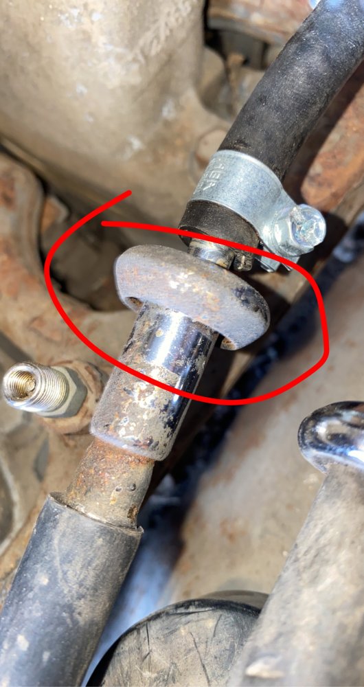

only lines i didn’t pull off and blow through are the ones that go from the frame rail fuel filter up to the regulator, because i’m not sure how to unplug the lines from these connectors. do any of you guys know how?
Yep quick disconnect. Insert tool around the hose, push in...should pop loose.
If they haven't been removed for a long time you may have to twist the quick disconnect fittings (male and female sides) to break them loose before they will separate.
