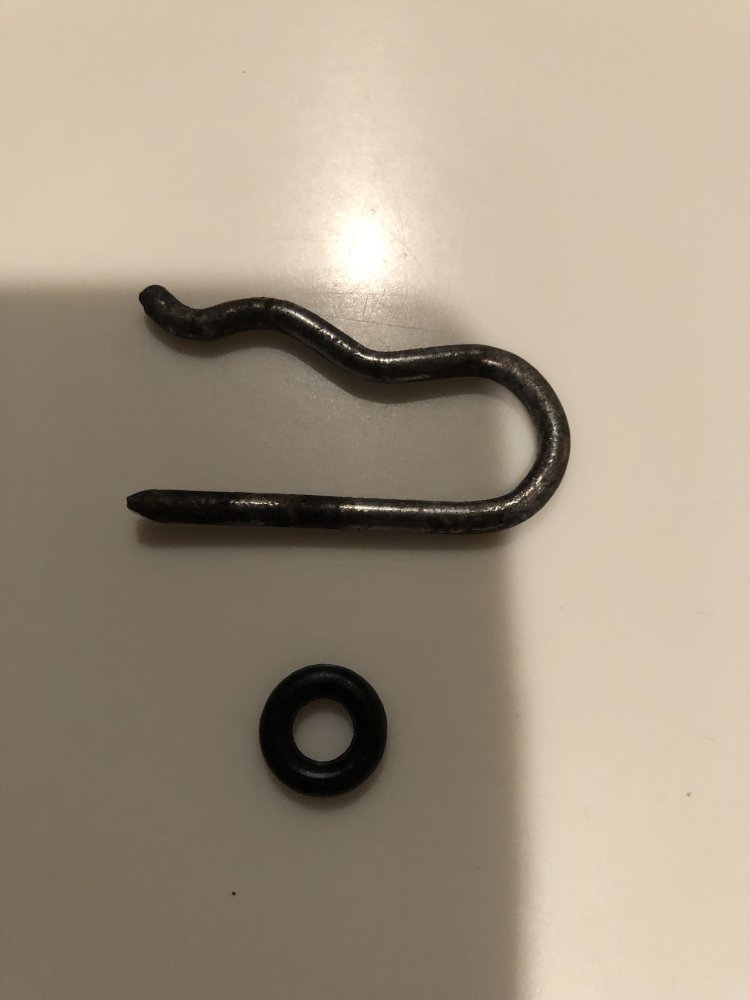

Want these?
No, that’s close but not the one that’s in the vehicle now. I’ll have to snap a picture and post it
