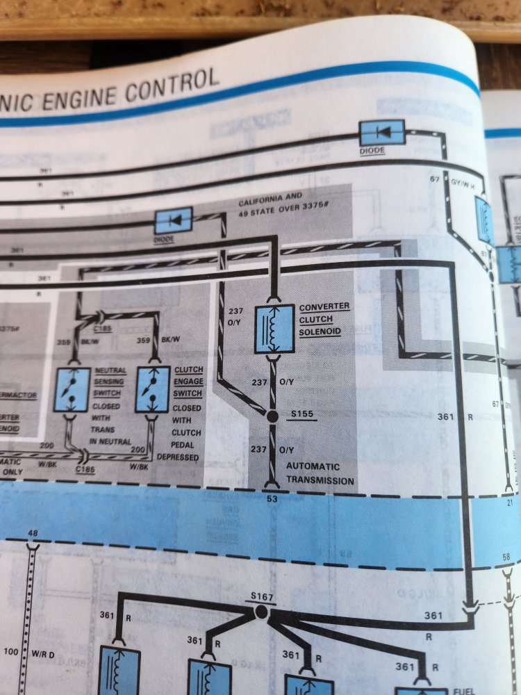

After you unplug the 2 wire connector use a volt meter or test light on the 2 wires, key on engine off
Should be 0 volts
If you see volts then either ground wire is shorted or computer is grounding the control wire, unplug 60-wire connector on computer, then re-test, to find out which one is the issue

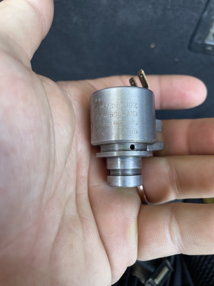

Well it has a new torque converter installed now. I will unhook the solenoid that we installed & test as you mentioned.
If this solves the stalling issue, can the truck be driven without the solenoid for the short term? I have ordered the new one from O Reillys that matches the original one that I pulled out that was “stuck”.

I was able to take out the torque solenoid last night & unfortunately the same result is occurring. Cranks and idles fine. It dies when put in gear. I’m at the conclusion that it is the transmission after all that we have done to it.
