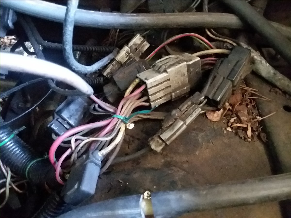

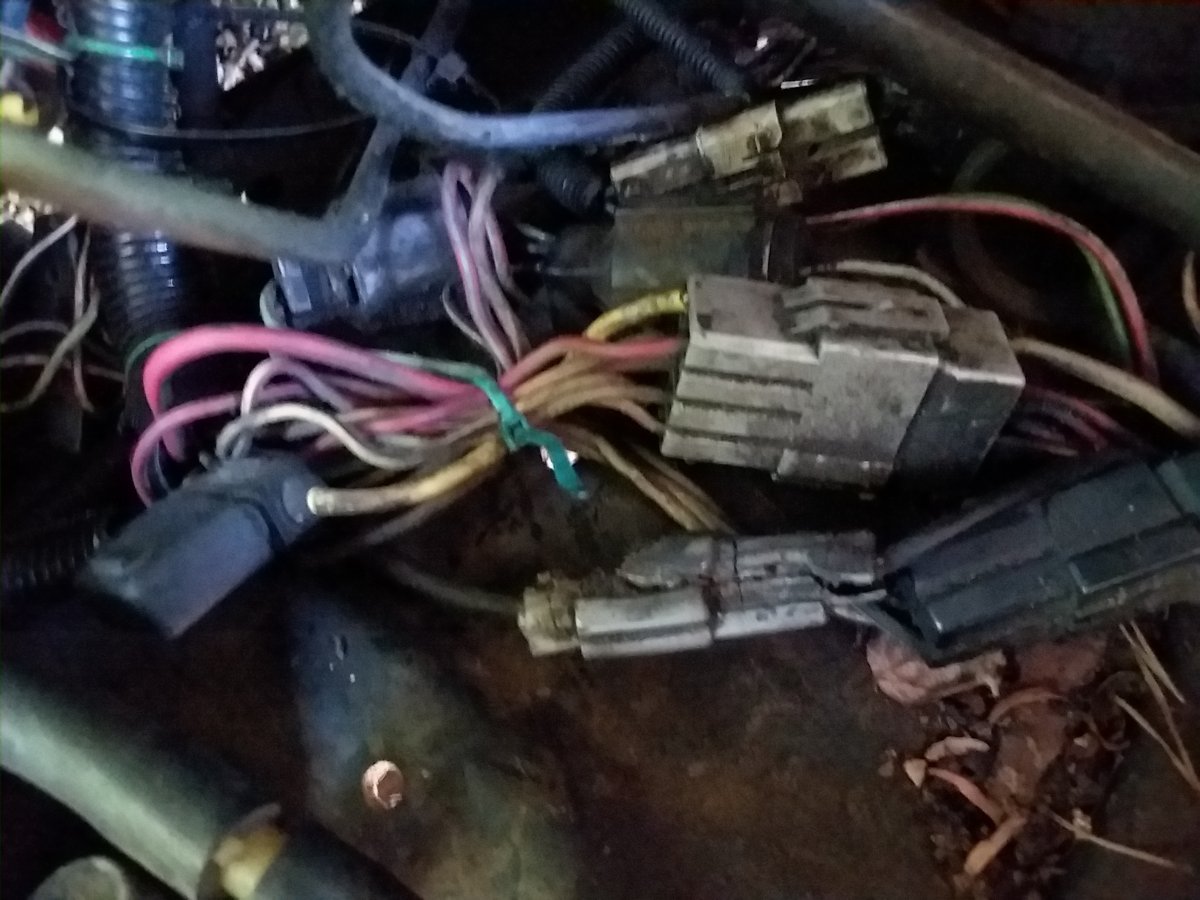

Can YOU post a pic of what you have underhood, looking from the fender towards the distributor and intake, including the fat loom of wires leading from the inner fender towards the intake.
tom

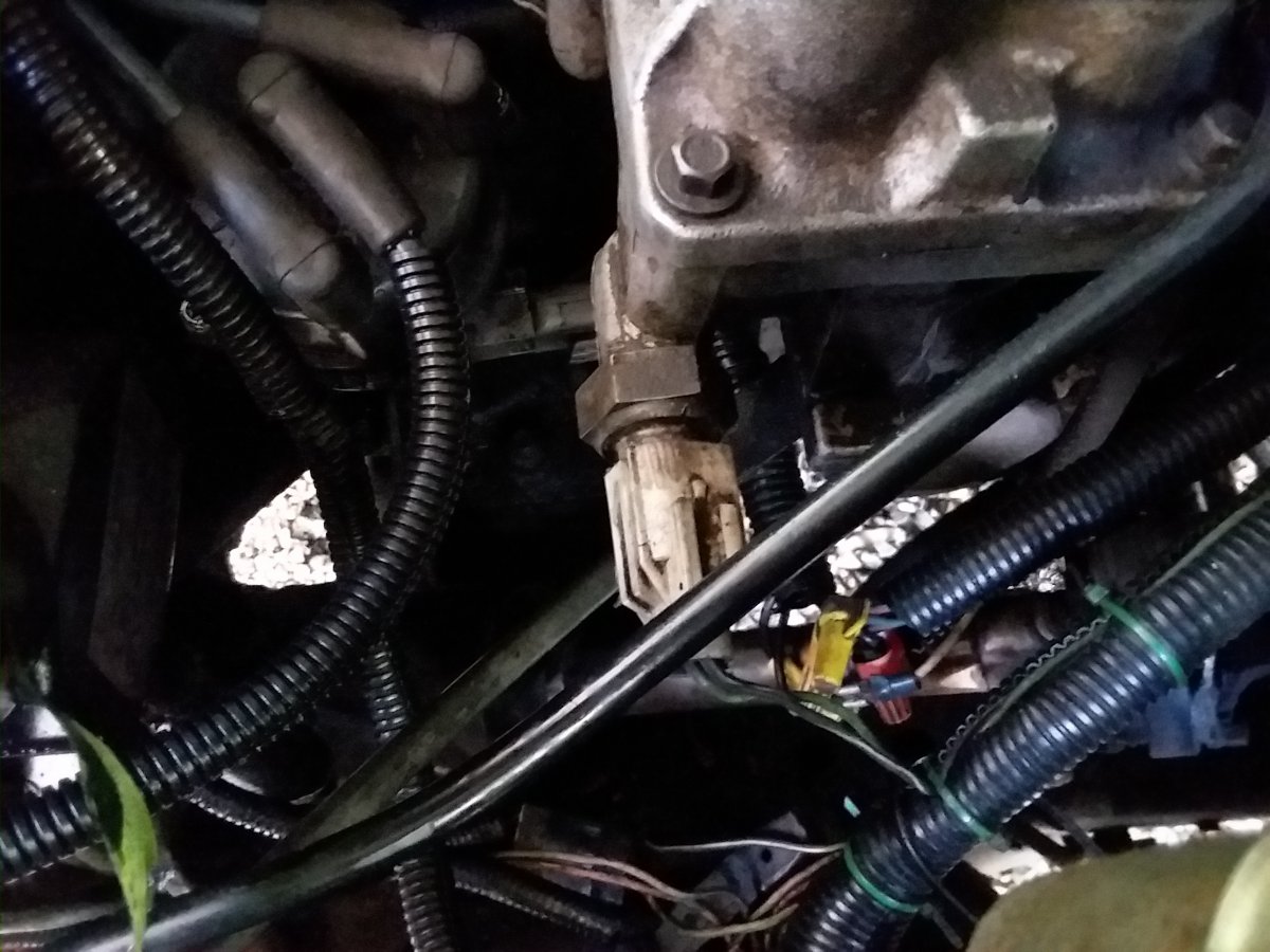

oh no no, it's EFI (i'm an old fart, wouldn't even need a manual for points) this is 2.3l before coil packs. you can see in one pic where the 6 pin distributor connector was cut/replaced.
the "..single black wire.." is a quote right off the underhood sticker. yesterday i adjusted time by ear/eye/road test; it runs better but not just exactly how it should, i think.
