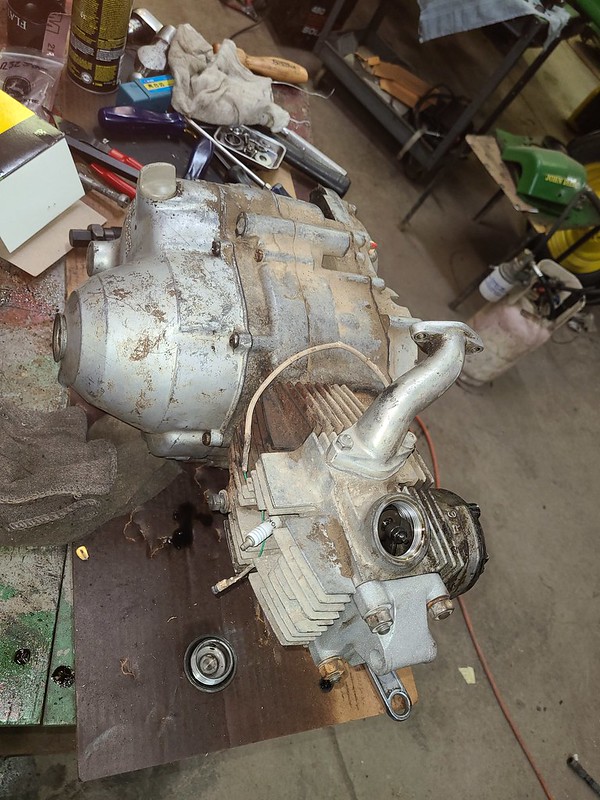

So I dragged it upstairs and hauled it to work to play with at break. IIRC (I need to go back thru this thread) I just needed a gasket kit to throw this on, change the rocker arm cover to fit in a 110, pull the flywheel and solder a wire for the armature over there and the base engine is done. Then I need to play with the carb, clean the fuel tank and in theory it should run/drive.
1984 atc125m
I need to go look for numbers, the good engine is a 90 and I don't know what year it is.
I get this one done then I can pull the engine out of the wife's, totally explode it and change the case on it.

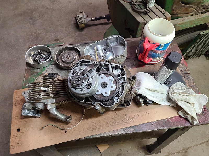

So I hauled the 110 parts motor over and pulled the drum off of it
1984 atc125m
Rocker cover is on, gasket surface is clean, case is cleaned out... ready to assemble tomorrow?

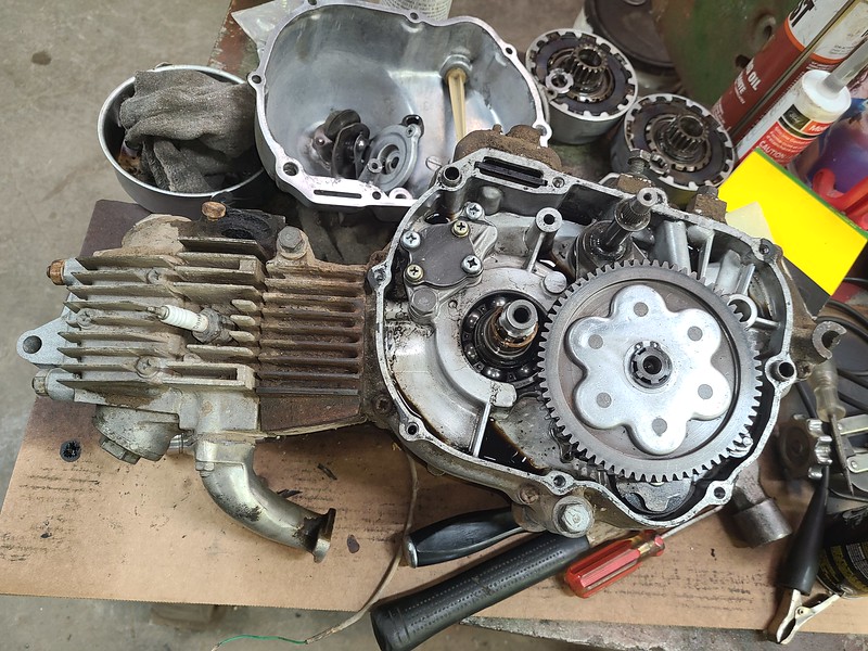

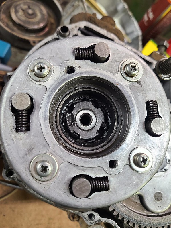

"new" clutch installed with better oil filter plate and bearing.
1984 atc125m
All the clutch bits with the oil director installed:
1984 atc125m

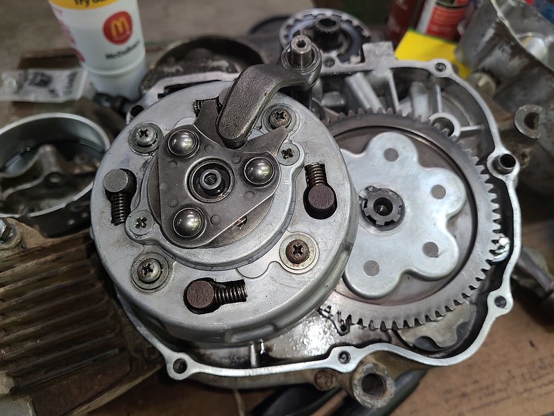

More clutch bits plus new gasket:
1984 atc125m

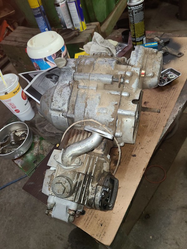

After installing the side cover I checked the valves, intake was a little loose, exhaust was right on. I went back and forth and ended up using the 90 cover, I will probably have to adjust the clutch. I ended up judging by the total lack of care the 110 received the clutch would need adjusted either way and I had already stuck the 110 back together before I thought about the clutch adjustment being in that housing.
1984 atc125m
In theory... ready to run?
1984 atc125m

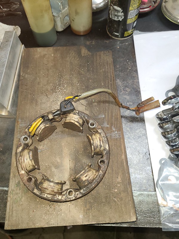

Pulled the armature out of the 110, I need to fix a wire on it and then I think the 90 is complete enough to run minus the carb which I pulled off the trike over the weekend so I can go thru that.
1984 atc125m

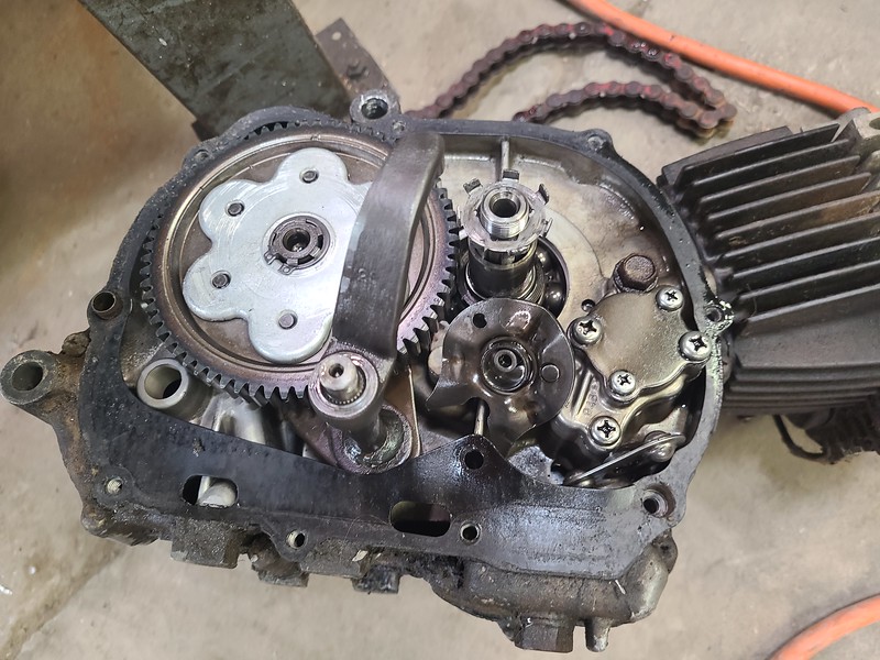

Also tried to pull the chain out of the 110, it seems jammed in the case around the sprocket and since the engine is seized I can't really force the sprocket to turn easily. If I could pull the flywheel I could take the cases apart... looking closer and noticing the jackolantern tooth situation on the 110 I think if it runs halfway decent I will just snag a new chain.

Big concerns are while it feels like it has decent compression how shot the engine is and if I can get the armature/magneto to work. There doesn't seem to be any option for retrofitting a later CDI ignition on these things and the chinese stuff is totally different (crankshaft taper etc) so that can't be retrofitted either.
I see armatures from time to time on ebay for $100, they don't look much nicer than what I have and have about the same guarantee.
Those points covers look suspiciously like the one on my 78' XL350. It converted to CDI easily with an ATC185 ignition pickup and China Z50 clone CDI module. I did order a spacer from John Ayscue.
I asked for just the spacer and bought the rest of the parts elsewhere.
Just make sure the CDI is correct for your electrical system. AC (has it's own wire from stator) is most likely since it has points now. DC would only have a wire coming from the battery/charging circuit to CDI. If you can make the pickup fit, you can run either one. DC can even be run on just the battery.
